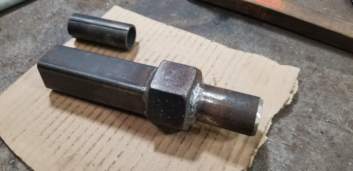

Just whipped up this sleeve installation tool to help me put the new one onto the shaft when it arrives. It has an old sleeve welded to the inside of the guide tube. The inner leading edge of the old one is relieved. The new sleeve sits in the tool with a half inch exposed in order to watch the guide lines. Also, here's a picture of my "lathe" to dress the shaft surface with.
