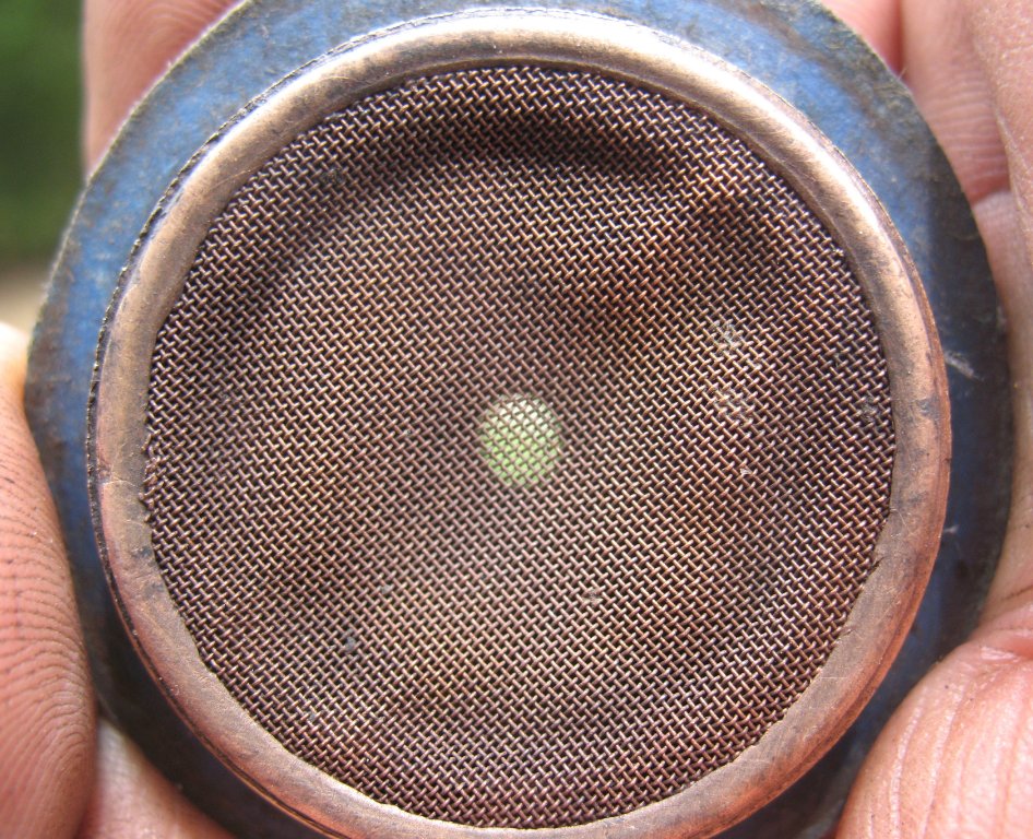

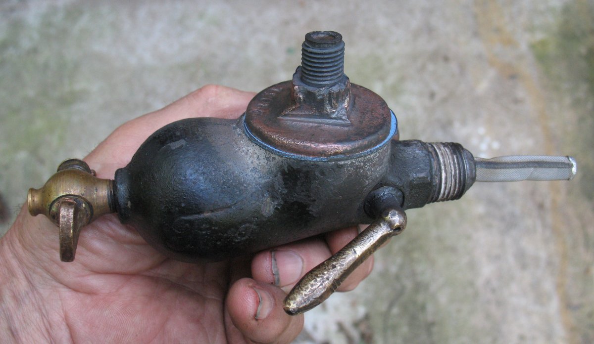

Yes, the screen is supposed to be fastened in place.
I like to add the accessory Model A screen on top. It's a much finer mesh.

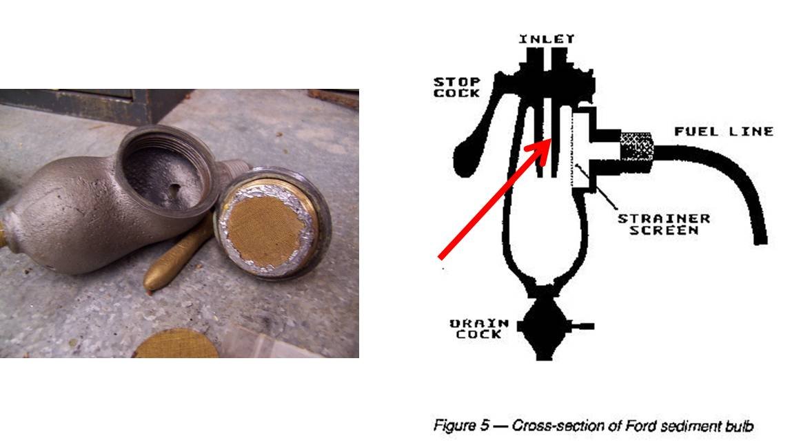

Thanks Steve, I think I'll get one of those Model A screens and install it the next time I have the sediment bowl out.
I saw a drawing of the OEM sediment bowl elsewhere on the forum that showed an internal extension (red arrow) that guides the fuel down towards the bottom of the bowl. Has anyone seen an OEM sediment bowl with such an extension? My reproduction bowl doesn't have it. :(

I can say everyone I have had apart did not have the extension. Maybe its an early bulb feature. I have only worked with original iron units.

As for that longer lower cast tube inside the "potato"? The brass one I bought doesn't have that. Most of the iron ones I have had over the years did not have that (according to my recollection?). However, I do recall at least one years ago that had that. I thought it was odd at the time. The five or so iron ones I had in my junk box and spent so much time getting apart? ONE of them has the long tube as part of the original casting. So they are out there.
