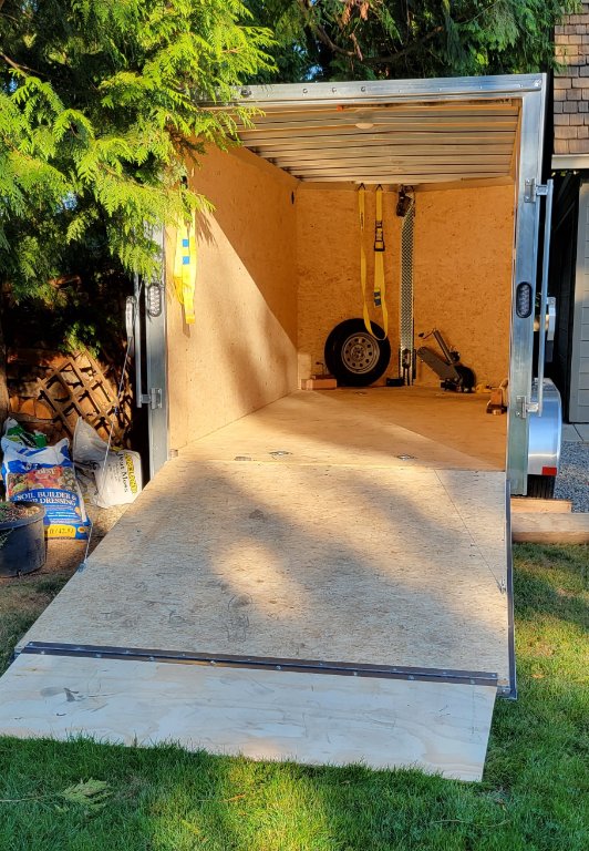

I have purchased a brand spankin' new EZ-Hauler all-aluminum 7'x14' enclosed cargo trailer for hauling Model Ts around.
Since it is new, before I get gas and oil dripped on it, I would like to put some sort of protective covering on the floor and ramp.
Maybe like a spray/brush on pickup bed liner, or maybe the epoxy type of garage floor finished with the little speckles? I dunno, I need some advice here.
What have you enclosed trailer guys done in the past? What products would you recommend, and what products would you avoid?
