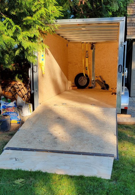

I have purchased a brand spankin' new EZ-Hauler all-aluminum 7'x14' enclosed cargo trailer for hauling Model Ts around.
Since it is new, before I get gas and oil dripped on it, I would like to put some sort of protective covering on the floor and ramp.
Maybe like a spray/brush on pickup bed liner, or maybe the epoxy type of garage floor finished with the little speckles? I dunno, I need some advice here.
What have you enclosed trailer guys done in the past? What products would you recommend, and what products would you avoid?
Thanks,
Keith

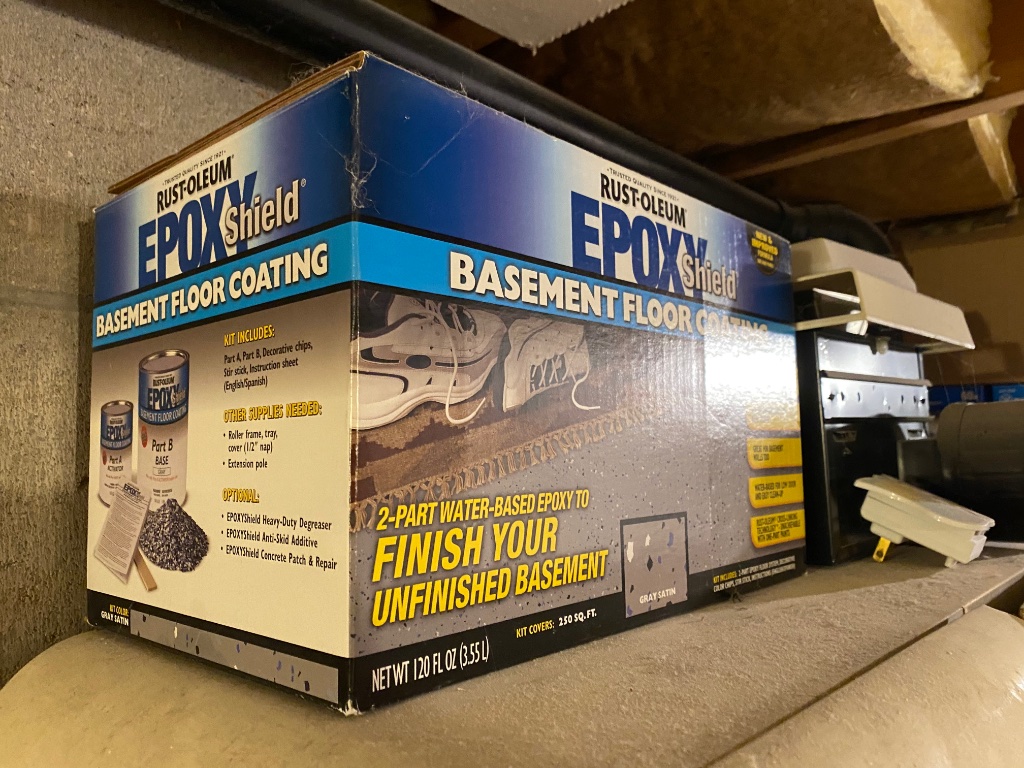

Rustoleum makes or made a kit to do a garage floor or a basement floor in gray or tan. I did my basement with it about 16 years ago and my trailer floor with it about 15 years ago. Both are holding up quite well.
Joe Reid
Posts: 270
Joined: Thu May 23, 2019 12:21 pm
First Name: Joe
Last Name: Reid
* REQUIRED* Type and Year of Model Ts owned: 1919 Coupe, 1920 Roadster, 1923 Touring, 1924 Roadster, 1913 Racer
Location: Almond WI
Re: Enclosed Trailer floor covering?
Post by Joe Reid » Mon Oct 03, 2022 3:36 pm
This is the stuff.
