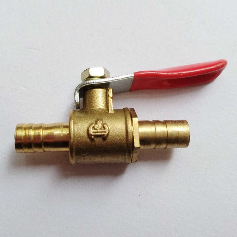

First off, this is not a debate of whether or not to use an inline fuel filter : that argument has been beat into the ground by both sides pro and con ......
This is about a modern safe fuel line for a Speedster where safety is more important than originality . And yes, Henry's system worked as well as it was designed to , but as a Firefighter for 20 plus years who has been on his share of vehicle fires , well, I will say no more .

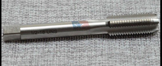

The Fuel Bulb threads for the outlet are 1/2-18 straight thread where the FORD compression type fitting screws onto the bulb with the felt compression material. 1/2-18 does not seem to be a common thread for much that I can figure out, yet there are 1/2-18 UN taps made and sold .
What is that thread size used for in modern times ?

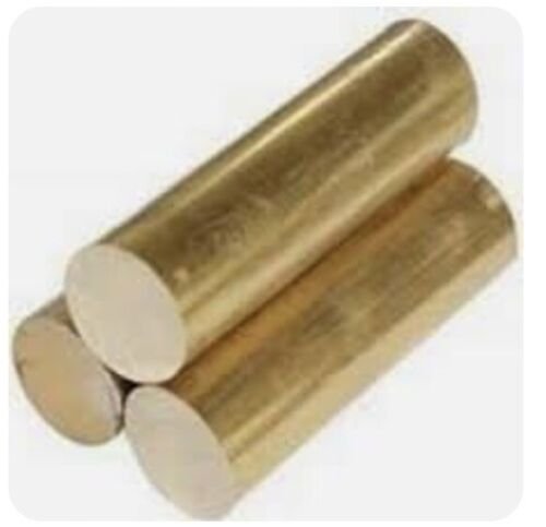

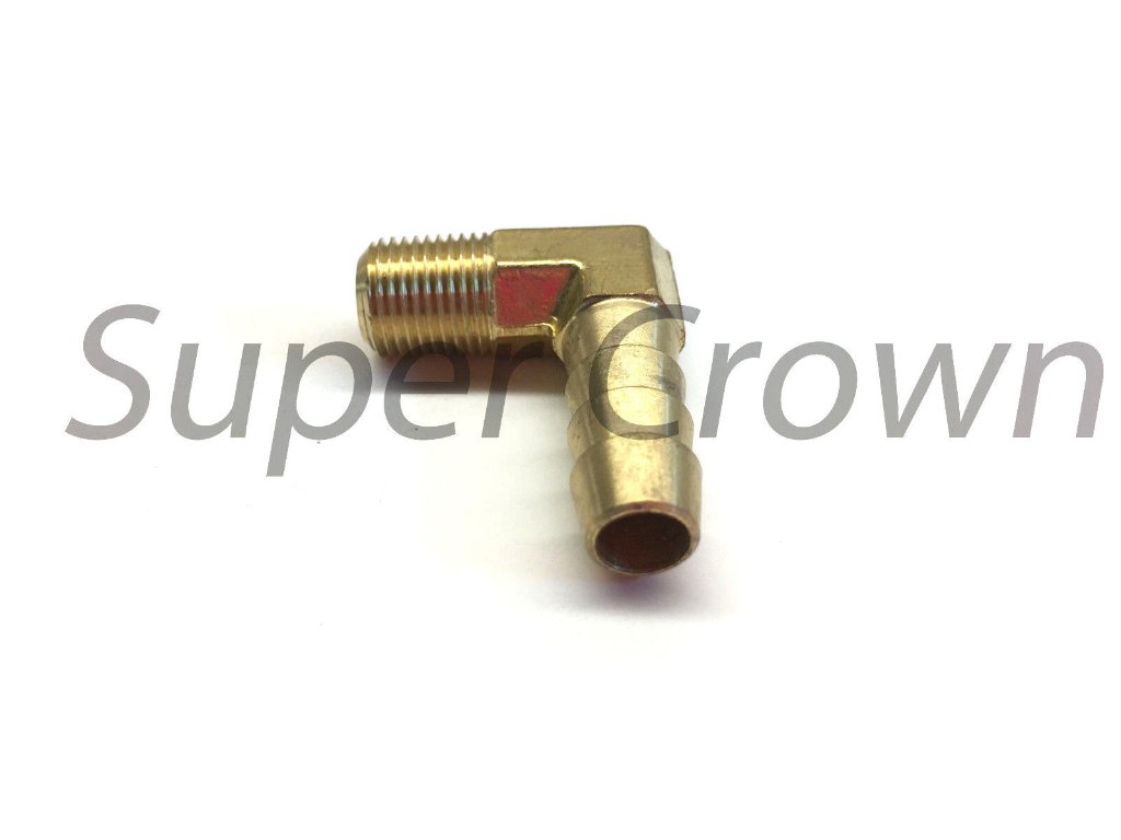

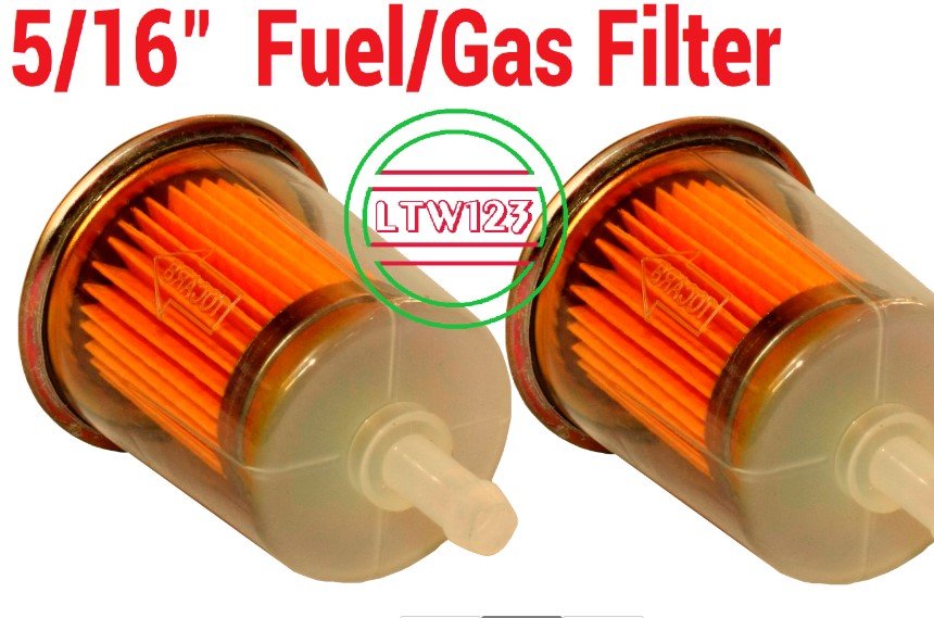

I am making an adapter out of a piece of 1" x 1-3/4 long brass rod , 5/16 hole drilled through , then tapped 1/2-18 on one end , and 1/8 Pipe on the other end , so I can screw it on my fuel bulb with a 1/8 Pipe x 5/16 Barb 90 degree and use 5/16 rubber fuel line , a 5/16 inline Fuel filter ( let's not argue the merits or not of that ), then onto 5/16 steel line with bubble flares to slip the rubber fuel line on, and at the carb a 5/16 double barb fuel shut off into a 5/16 barb x 1/8 pipe 90 degree......
the reason is , A) need to replace the old nasty copper line B) Not keen on the felt packing, or using a section of rubber hose as a packing material , brass compression ferrules don't belong there , C) 5/16 line and 1/8 Pipe fittings are all 5/16 internal diameter which is better flow that 1/4 inch fuel line , which May or May not have bearing on whether or not an inline fuel filter will or will not starve a Model t of fuel .
By Putting the fuel filter at the top , more head pressure , gravity flow , maybe yes, maybe no ?

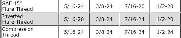

5/16 tubing uses 1/2-20 and 1/2-24 depending on what type of flare:
Screenshot 2022-11-03 050018.jpg (19.42 KiB) Viewed 3861 times

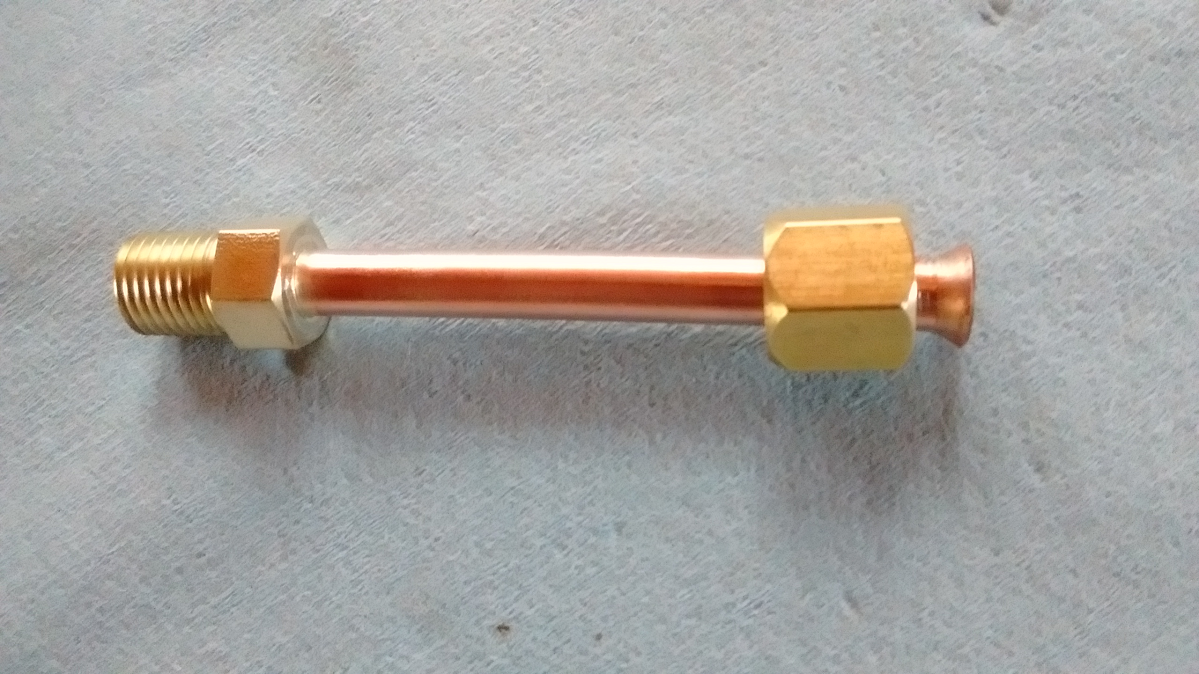

You've made a bunch of declarations and followed up basically with "don't question me on this", so there really is no point in offering any suggestions from experience. Instead, I'll offer 2 statements and a question:
S1: 1/2-18 is the thread used universally for liquid fuel lines on cars of the period, along with flared fittings on carbs for larger cars. As for modern applications for that particular thread, I have never seen one, but that doesn't mean they don't exist.
S2: If you use a 5/16 line, you are still trying to dribble it past a too-small hole in the float valve (assuming you are using an NH)...you could hook up a fire hose to it and not get more fuel than can be delivered by a correct 1/4" line. One small constriction will undo any manner of changes performed elsewhere short of increasing delivery pressure (and that is not necessary). There is a solution to that restriction, but that is not what is being asked in this thread so there is no point in going there.
Q1: Do rubber hoses and plastic fittings belong anywhere on a gravity feed fuel system?
Now, for the benefit of anyone who is interested in these things, below is a reproduction of a factory adapter to adapt a Model T to an accessory carb Zenith S4BF...where both 1/2-18 as well as flared fittings are involved:

You can always cut the 1/2-18 spud off of the outlet and tap the hole for a pipe thread and then use a pipe thread to tube flare adapter.

There is more to a thread profile than simply pitch. Witworth threads are 55 degree, UN threads are 60 degree. You may also be surprised at the size of 1 Whitworth, approximately 1-5/8”
I am impressed at the amount of effort that the OP went thru to find an off the shelf tap in this size, but sometimes tools simply need to be custom made. Most any lathe will cut just about any thread pitch, regardless of diameter, and so a little effort can save the cost of custom tooling. Many folks fear cutting internal threads on a lathe, with a little practice they are just as easy as external threads. You can always try running the spindle in reverse so that you are not threading to a blind stop

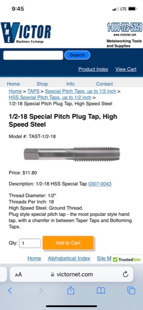

https://www.victornet.com/flypage.html
Try here. Dan
I did order one Dan... thanks !

That's good Scott ....and useful. But my intent was not to argue any benefits or drawbacks ... we all have opinions . And yes , you are correct , my hope here was and is to overcome ANY fuel loss or starvation WHILE using an inline filter of the minimal type as used in gravity feed systems like tractors, motorcycles, etc. Basically this is an experiment. I may be right , I may be wrong. but easy enough to take an inline fuel filter out and replace it with a piece of rubber fuel line.
One thing there is no argument for , fire in a Model T is ugly , dangerous and destructive......
IN regards to do rubber hose and plastic belong anywhere ? The answer would be yes, many cars and vehicles have had rubber hose and plastic in gravity feed systems.
That one is beyond my scope of training or budget , but yes, if one were a machinist and had the time , money, tooling and knowledge , that would be a good solution. At one time my 87 year old Dad could have done it, buy age has caught up to him . Sadly , as folks get older and die off, we have lost great resources .

Concerning an inline filter: Most old tractors and motorcyles had the fuel tank located directly over and well above the carburetor with a short fuel line. Most tractor filters were a bowl and screen type, designed for use on a gravity system, not a paper filter for general use on pumped systems. If your speedster has a clean tank, the original type filter is entirely adequate and capable of trapping a good deal of dirt and water without clogging. If you are using a hand pump or some type of fuel pump, a modern type filter would be OK. Most modern filters are for use on fuel injected, pumped systems. They have very high filtration, and very little tolerance for any significant amount of water or the kind of debris found in most older fuel systems. As for rubber fuel line, I've had a number of issues with it failing, both on automobiles and on lawn mower type engines. I suspect that modern fuel blends are very hard on rubber-type fuel line not specifically designed for them.

I am sorry. I am afraid all I can do is frustrate you some more! However, maybe it can trigger a thought in someone that knows something I don't?
When I was making the fuel lines for my 1915 runabout (about a year ago), after buying a new gasoline tank, restoring an old brass fuel "potato", and having the era carburetor "restored" and digging out all the original fittings I had and wanted to use? I still needed those two special thread fittings. Being on a tight budget and having boxes and buckets of plumbing materials and hardware, I dug through all the small stuff I could find. I had already eliminated the cans full of original era stuff which did have a couple really odd/special pieces I could have made work, but I didn't want to destroy them for whatever era thing for which they might actually be needed.
Between my own hoarder tendencies, and my dad's true hoarder status, I had a few boxes and buckets of all sorts of odd, stupid, junk, in the small plumbing and brass fitting lines of stuff.
In there, I found TWO odd fittings, that the internal thread on one end was a perfect fit onto both the "potato's" threads and the original elbow fitting to go into the carburetor. The other end had something different (a type of flare fitting), and was connected to short ends of what appeared to be aluminum tubing. A simple modification using a hack saw and the drill press made them work perfectly to connect my fuel line.
Something out there does exist. I don't know what it is, and don't think at this point I could find the removed ends that I cut off.
Pure speculation on my part. A few things they were in a box with had me thinking they MIGHT have had something to do with automotive air conditioning????
Good luck! And don't go crazy over this.
Another thought? Years ago, I couldn't find a proper fitting, and wanted to use a larger fuel line on a speedster. I found that a small (3/8 pipe maybe?) coupler fitting would thread onto the "potato's" threads with some minor difficulty due to close but not proper threads. Thread count was close, but not right, and of course taper versus straight threads. However, some good sealant and it made a solid and reliable adapter to standard available brass fittings.
Not the smartest thing I ever did? And today I wouldn't trust the sealant with modern gasoline. However, you should be able to get a pipe fitting coupler in brass for that size! That, threaded on not too tight, and then soldered should make a solid and reliable adapter. Again, not the best suggestion. But not the worst either.

...for $1.75 plus shipping for a pack nut, I'd be inclined to do it right, but then again, that would leave one less thing for the next guy to do over, and where's the fun in that?
Good stuff Wayne! And yes, my dad said " go out and look through my fittings..... that is a whole drawer on an old navy battle ship machinist cabinet ! He is 87 .... and had I had that potato in my hand , I might have done it ! I may yet ! I get the feeling from some folks here that if it isn't original it is sacrilege....But this is a Speedster , it will never be original ....it certainly wasn't the way I bought it and the way it was built 40 years ago in Oregon.... and I can say , without a doubt , it is far better now than when I got it ...no plexiglass windshield , real safety glass ! Speaking of not original, I am out the door to get my last 2 rims and an extra from the powder coater , and two green ones for the camp trailer !!! Ca-ching $$$$...

A screen and bowl type filter will usually give the best results on a gravity-fed, carburetor system with a vented fuel tank. Regardless of any filter type used, a reaonabley clean fuel tank is a must.
A dirty tank will quickly clog most modern throwaway paper filters, and will require frequent filter service on the earlier, bowl and screen type filters. A functional fuel shut off valve is a good thing to have on any gravity fed fuel system. A Model T and other early cars with a gravity system and updraft carburetor are capable of draining an entire tank full of gasoline onto a garage floor if the float valve should leak, or if the float istelf develops a leak and no fuel shut off is present, or not used, or itself leaking. I would never park an early car with a vented carburetor and fuel tank in any enclosed space with an ignition source, such as a hot water heater or other heating device that had a pilot light or spark igniter. Any car, lawn mower, ATV, etc ought to be stored in a well ventilated space with absolutely no source of ignition present.
That is truly sound advice about the shut off and parking with an ignition source. 20 years or more ago , there was a Central Fire fire Captain here who was cleaning a motorcycle tank in front of his garage, outside, with a gas water heater in the back corner of an attached garage. The vapors carried back into the garage , it flashed , and the short version is , he died because of it . Fuel is very dangerous ! I have witnessed while camping at Big Basin , someone throw white gas on a campfire in the next camp site : It went through the fire , hit the tent behind , and POOF in 3 seconds that tent was fully ablaze on the ground , and it was a huge tent . Thank god no one was in it .

Gasoline vapor is highly flammable, if not outright explosive, and it is heavier than air. Absent air currents, it can do some remarkable things.
