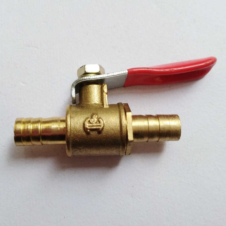

A screen and bowl type filter will usually give the best results on a gravity-fed, carburetor system with a vented fuel tank. Regardless of any filter type used, a reaonabley clean fuel tank is a must.
A dirty tank will quickly clog most modern throwaway paper filters, and will require frequent filter service on the earlier, bowl and screen type filters. A functional fuel shut off valve is a good thing to have on any gravity fed fuel system. A Model T and other early cars with a gravity system and updraft carburetor are capable of draining an entire tank full of gasoline onto a garage floor if the float valve should leak, or if the float istelf develops a leak and no fuel shut off is present, or not used, or itself leaking. I would never park an early car with a vented carburetor and fuel tank in any enclosed space with an ignition source, such as a hot water heater or other heating device that had a pilot light or spark igniter. Any car, lawn mower, ATV, etc ought to be stored in a well ventilated space with absolutely no source of ignition present.

.TXGOAT2 wrote: ↑Fri Nov 04, 2022 4:13 pmA screen and bowl type filter will usually give the best results on a gravity-fed, carburetor system with a vented fuel tank. Regardless of any filter type used, a reaonabley clean fuel tank is a must.
That is truly sound advice about the shut off and parking with an ignition source. 20 years or more ago , there was a Central Fire fire Captain here who was cleaning a motorcycle tank in front of his garage, outside, with a gas water heater in the back corner of an attached garage. The vapors carried back into the garage , it flashed , and the short version is , he died because of it . Fuel is very dangerous ! I have witnessed while camping at Big Basin , someone throw white gas on a campfire in the next camp site : It went through the fire , hit the tent behind , and POOF in 3 seconds that tent was fully ablaze on the ground , and it was a huge tent . Thank god no one was in it .
