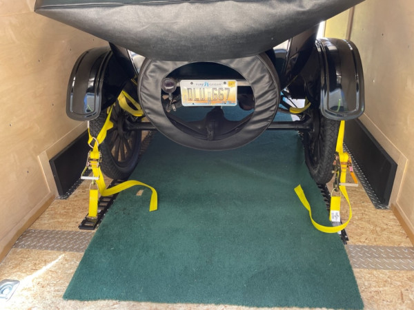

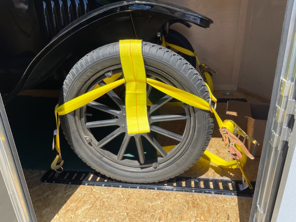

New to the hobby and just bought my first trailer this past June. Right or wrong, I use “basket” straps on all four wheels. I now have tape marks beside the e-tracks where the wheels go, but it would probably load faster to put some kind of stop blocks in front of the front wheels
Miles
1924 Touring “Bonnie”
1925 Express Wagon “Clyde”
- Posts: 407
- First Name: Harold
- Last Name: Schwendeman
- Location: Seattle
Re: Car trailer stuff
Miles- That's exactly the way I tie down Model T's in my enclosed trailer. My reasoning in setting up my trailer with e-track and nylon basket-type tie downs is that THAT'S THE WAY ALL RAILROADS SHIP NEW AUTOMOBILES, and I honestly believe that railroads have found it to be the best way! Additionally, I've found that a good way to store the basket type tie-down straps is to mount a standard 3 ft long length of e-track horizontally near the ceiling of the trailer and just hang them up where they are kept neat, out of the way, and not tangled up. FWIW,....harold
