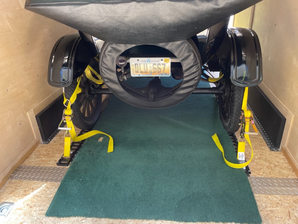

New to the hobby and just bought my first trailer this past June. Right or wrong, I use “basket” straps on all four wheels. I now have tape marks beside the e-tracks where the wheels go, but it would probably load faster to put some kind of stop blocks in front of the front wheels
Miles

Miles- That's exactly the way I tie down Model T's in my enclosed trailer. My reasoning in setting up my trailer with e-track and nylon basket-type tie downs is that THAT'S THE WAY ALL RAILROADS SHIP NEW AUTOMOBILES, and I honestly believe that railroads have found it to be the best way! Additionally, I've found that a good way to store the basket type tie-down straps is to mount a standard 3 ft long length of e-track horizontally near the ceiling of the trailer and just hang them up where they are kept neat, out of the way, and not tangled up. FWIW,....harold

Miles
Looks great. I just screwed in a couple short lengths of 2x4 to use as stop blocks. Works great and removable if needed. Nothing fancy.
