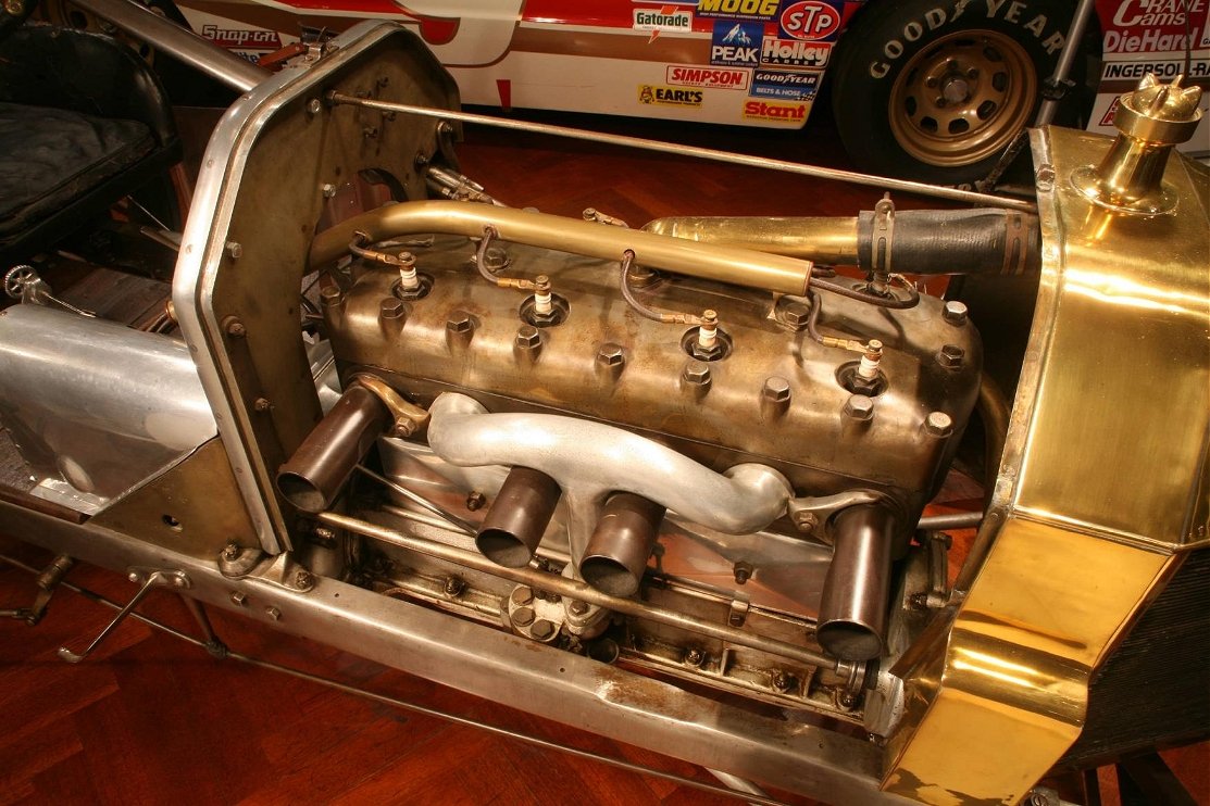

Warwick, the other remaining racer, the largest, also has a 5 bal. Unfortunately, no literature or drawings I’ve found indicate any other carburetors, although it wouldn’t surprise me if they used different types.

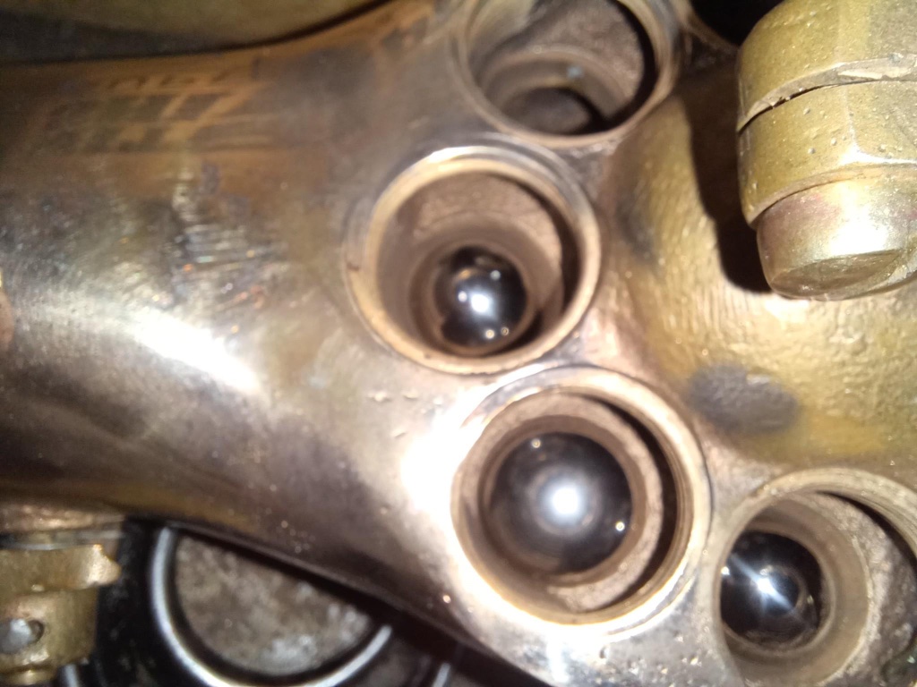

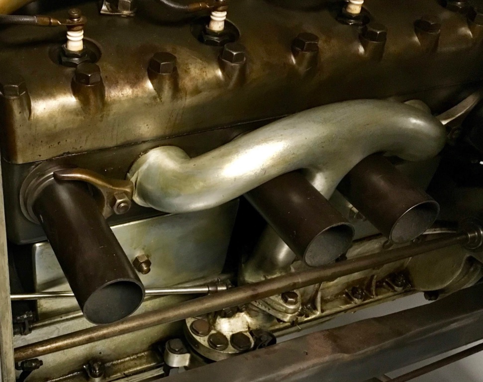

Below, photo of the carb on the 410 c.I. racer at THF:
Aussie16
- Posts: 280
- Joined: Sat Jan 05, 2019 9:24 pm
- First Name: Warwick
- Last Name: Landy
- * REQUIRED* Type and Year of Model Ts owned: 1916 RHD Canadian Touring 1916 Pickup 1926 Fordor 1925 Dalgety Tourer 1916 Speedster
- Location: Trarlagon Victoria Australia
Re: Five ball carb question
Thanks for the great pic of the intake and carb set up. From the pictures, that carb and manifold look custom made to suit the big engine. The 5 ball looks to be made of some kind of alloy and may be of bigger size construction all around?? The carb outlet is different to the normal 5 ball on a 1910 production car and is mated up to a custom inlet manifold. Similar to stock production but still all different and unique? Maybe a standard 5 ball is not suited to the application for low speed and RPM's. Great looking and sounding piece of Ford history. Your mates will be sure to get it sorted for you. I hope to be able to see it and maybe even ride in it one day.

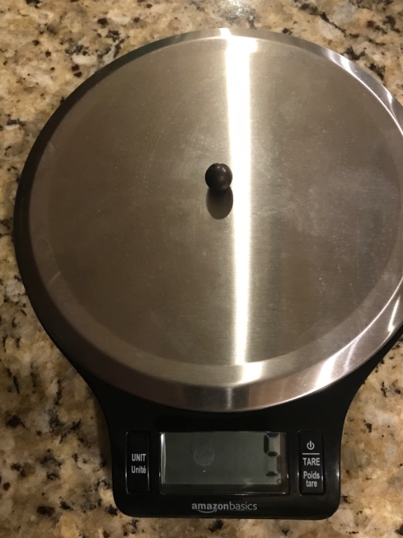

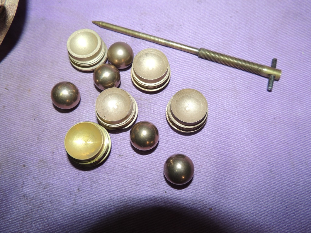

I was curious, so I weighed one of the brass (bronze?) balls from inside my 5 ball on a digital scale. It weighs 5 grams. I will check my other 5 ball carbs that I have to see if there is variation.
Last edited by ThreePedalTapDancer on Sun Dec 04, 2022 9:08 am, edited 1 time in total.

Also, they are bronze balls, not brass apparently. Of same weight. See original ad below.

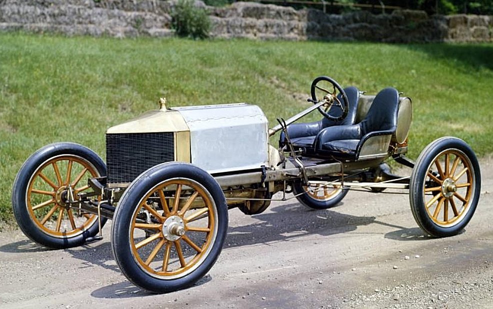

Thanks again everyone. I'll address a few things, and then add several questions. Roger, great pic of the racer at THF, with it's Kingston 5 ball. While THF called it a 1910 racer, it was actually initially developed and raced against the Blitzen Benz in in September 1911. Originally that engine (if I have the research correct, and that's always a moving target as we learn more) used was a389 c.i., and evolved over the summer of 1911 to the 410 c.i. it remains to this day. The engine is "hidden" in the T style chassis by pushing it forward into the V nosed radiator (no fan). It's so wide the outcropping on the right side of the brass radiator was needed to allow an oil filler (consider where the oil filler is on a T). The Bosch dual ignition mag was moved behind the firewall under the "lunch pail," but that wasn't done until the summer of 1912.
In early 1912, this racer made two official runs on ice (Lake St Clair), mimicking Henry Ford's record setting run years before with 999. It achieved a top speed of 109 mph. The racer beat the Blitzen Benz the fall before on the Michigan State Fairgrounds track, clocking 50 seconds from a standing start. At the time, the Blitzen Benz held the world one mile circular track record, I believe about 48.25 seconds, but FROM A FLYING START." After the timed match race, the Ford driver, Frank Kulick, offered a match race against the Benz, and Bob Burman, the Benz driver, for $5,000 (about $155,000 today). Burman replied "no, not with this racer."
Ford, with Kulick driving, also raced two other "specials" that day, this 300 c.i. (Actually 298, to make the 231 to 300 c.i. Class) and a 228 c.i. (161-230 c.i. Class) racer at the same meet, with both winning 5 mile races.
Ford and Frank Kulick did not again run in a track race, but the big racer and 228 c.i. did run in the 1912 Algonquin (near Chicago) hill climb, setting course and overall records on both hills.
Below, a photo of the racer taken at the Ford Detroit Branch store, winter of 1911-12, after the 1911 win over the Benz. The mag hasn't moved to rear of the firewall yet:
Frank Kulick seated aboard the big racer at the 1912 Algonquin Hill Climb. This is the last time the big racer would compete, setting records for both hills and the overall hill climb. THF has the trophies from all the Ford wins at Algonquin, although, like the racer, they are not on display. The mag has moved to the rear of the firewall. The outcropping is noticeable on the right side of the radiator brass for the oil filler. The frame is lowered by using a straight front crossmember and a rise toward the rear of the elongated frame. Under frame trussing like that used on several earlier Ford racers and the Model K helped hold the strain of large motor on a longer T style frame:

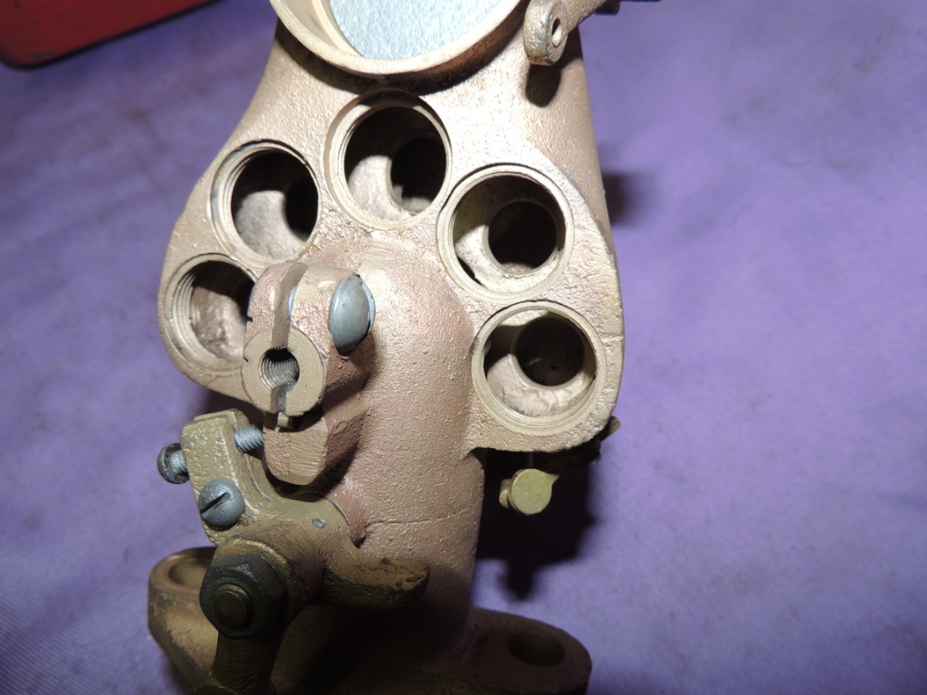

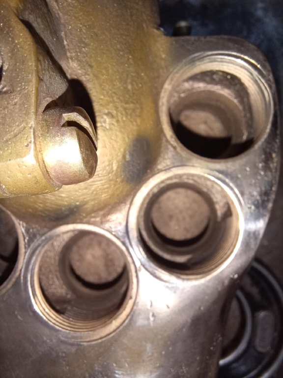

More questions.
“I’m about to open my mouth and remove all doubt…”

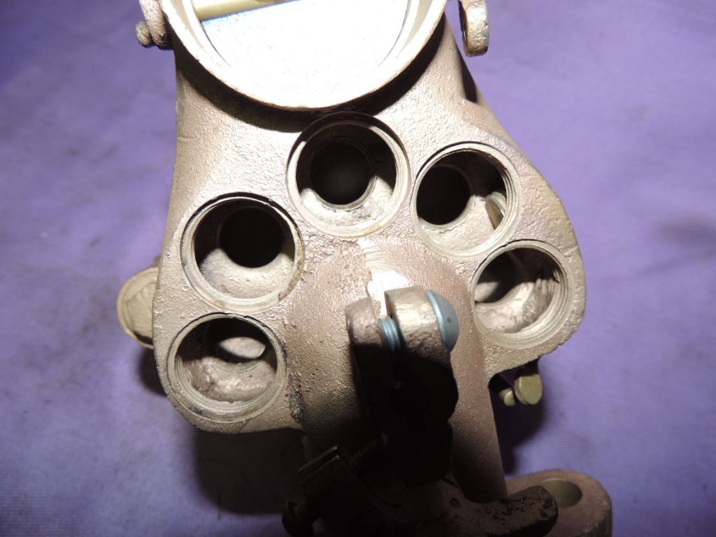

Seats measurements are .663, .638, .625, .638, .628.
The balls currently in the carb are steel, .688. Anyone have an idea what they should be?
- Posts: 6708
You're describing balls as being 11/16" or so in diameter...that seems large to me. Perhaps my eyes are deceiving me, but in your picture, at least 1 ball appears larger?
If undisturbed/molested, the screw-on cap has a skirt in which the ball just fits when it lifts. This is your clue to the correct size ball.
As far as the through holes, I think someone has mucked around and wallowed out some sizes. There should be 5 different sizes of holes, and each seat has a different shape from the factory, to control the flow of air vs the amount of lift. They are not all supposed to be just a random chamfer...some are chamfers (largest hole(s)) and some resemble bowls with barely line contact with the balls at the innermost opening of the bowl (the smallest hole). Repairs through the years may have simply ground identical seats into them which all conform to the tool used (which alters the factory seat shape). When you say "seat measurements" you should be using a ball gauge or plug gages to measure the through-holes...that is the meaningful dimension.
I almost wonder if someone might have removed the seats? Do you see any evidence of threads going through where a seat would have been?
I don't have one in my shop right now to compare but am going on memory.
- Posts: 4391
Scott,Scott_Conger wrote: ↑Mon Dec 05, 2022 11:17 amYou're describing balls as being 11/16" or so in diameter...that seems large to me. Perhaps my eyes are deceiving me, but in your picture, at least 1 ball appears larger?
Does it maybe appear that with Rob's carb, all 5 seats & through-holes are the same size and that the variable here is the ball diameter/weight? The idea being that differing ball weights would lift sequentially, in the same way that equally weighted balls would lift off of differing seats/through-holes.
I realize this doesn't jive with the dimensions that Rob reports, but it does seem to agree with the photos he provided. I also realize that was not the scheme that Kingston used, (that I know of at least).
From my friend who has the carb:
“Scott is correct, the center ball is 11/16", the other two are 5/8" and are in the only seats they won't fall through. The measurements are ID of the hole, showing there really isn't a graduated size in this unit. I suspect that the seats were "cleaned up" at some point and lost the factory setup. I fear that the only way to save this unit is to bore out the seats and thread in New, correctly machined seats. But we don't know what that is at this point!”
Any suggestions?
I don’t have a boat, nor need a small anchor….
Any suggestions?
- Posts: 6708
Rob
at this point I'd start a new thread and request (implore!) sample sizes from owners of cars successfully running them. Once the through-hole diameters are established, then the correct seat geometries can be applied following that information.
I think you're in for some extensive work
A boat might be cheaper

Found a replacement, or parts donor. Hopefully my "anchor" didn't just double in size.....

Rob: Thanks for posting.
The caps appear not to be identical, (or is that an illusion?) apparently to limit the lift of each ball, some lifting more than others? Are all the ball seats identical? Thanks, jb

Just had a quick look at my 5 ball, restored by Stan. Balls all measure .435", ports below all .410". Don't have a scale in my workshop but I am guessing that same size means same weight. Not sure how this chimes with the progressive response to vacuum described above. I haven't yet run this carb myself but I trust Stan's reassurance that he ran it up on his test engine.
Rob
Topic author - Posts: 1580
- First Name: Rob
- Last Name: Heyen
- Location: Eastern Nebraska
Thanks Jem. We’re goi g with the replacement, and trying to determine what the ball size should be. While a larger carb and balls/seats, the relation between the ball and seat may be similar.
Hopefully we try it later this week.
- Posts: 2948
- Last Name: Hjortnaes
- Location: Men Falls, WI
So the balls in Rob's carb are 11/16" (0.688) and 5/8" (0.625), or is that just the size of the holes that the balls drop in to?
Jem's are 7/16" (0.435).
How many different sizes of 5 ball carburetors are there?

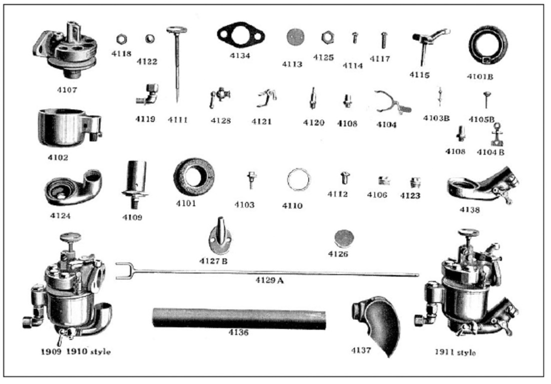

- Posts: 6708
The Kingston Model # 4100 for Model T's had 7/16" balls and was unchanged through its end of use in the Model T. The balls lift about 1/32" when open if the seats are perfect and the caps are made correctly to properly limit lift relative to the reworked seat(s).
The Kingston Factory number for the complete carb was P/N 553
Kingston catalog # for the ball(s) was 4122, the Factory P/N for the ball(s) was 2122 and the FORD P/N for the ball(s) was T3088
The complete carb sold for $9.00

Scott (or anyone), any idea how large the holes/seats were? We’re trying to determine how large replacement balls should be, based on how far down in the seats they should fit? Also trying to determine any rhyme or reason to how the different seats were graduated?
Thank you,
Rob
Thank you,
Rob
- Posts: 6708
The skirts on the inside of the caps should tell you your ball diameter unless they have been cut off. Even if they were, hopefully some sort of tell-tale remains of the diameter of the skirt(s). Of the 5, I'll bet you can cypher out the original ball size from one of them.
