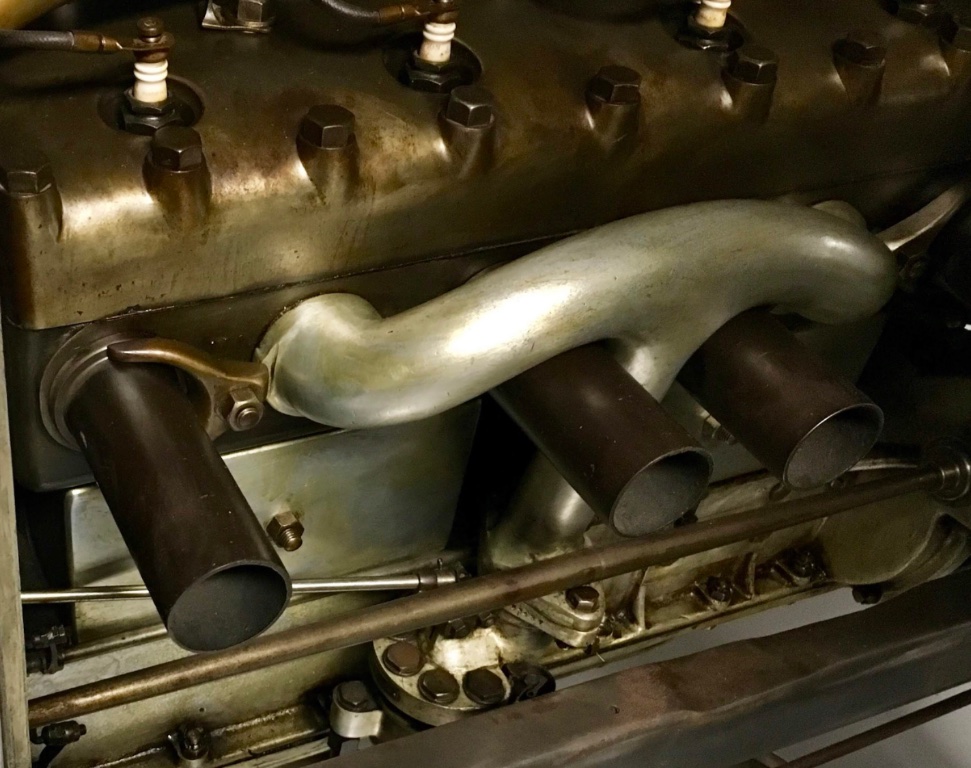

Warwick, the other remaining racer, the largest, also has a 5 bal. Unfortunately, no literature or drawings I’ve found indicate any other carburetors, although it wouldn’t surprise me if they used different types.
Below, photo of the carb on the 410 c.I. racer at THF:
Aussie16
Posts: 270
First Name: Warwick
Last Name: Landy
Re: Five ball carb question
Post by Aussie16 » Sun Dec 04, 2022 5:40 am
Thanks for the great pic of the intake and carb set up. From the pictures, that carb and manifold look custom made to suit the big engine. The 5 ball looks to be made of some kind of alloy and may be of bigger size construction all around?? The carb outlet is different to the normal 5 ball on a 1910 production car and is mated up to a custom inlet manifold. Similar to stock production but still all different and unique? Maybe a standard 5 ball is not suited to the application for low speed and RPM's. Great looking and sounding piece of Ford history. Your mates will be sure to get it sorted for you. I hope to be able to see it and maybe even ride in it one day.
