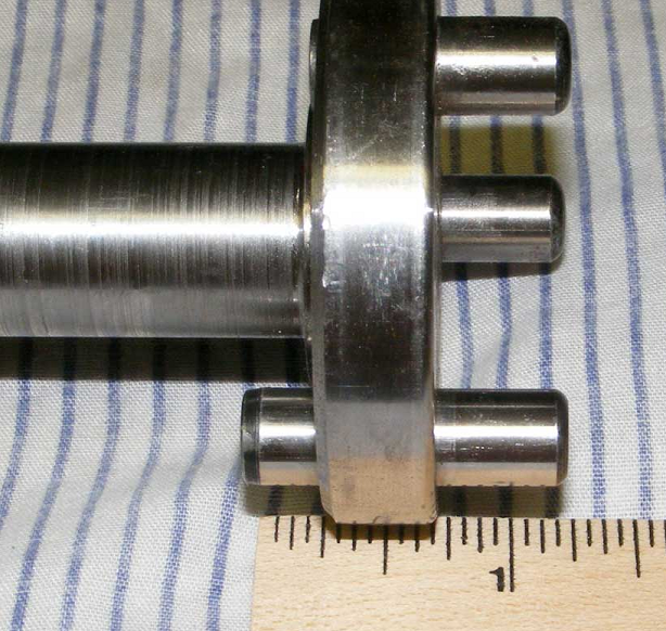

I have 5:1 gearing in an original 14 gear case. Fits & functions fine. Heed fords warning. The center shaft, 3 planetary gears & the long shaft must all be 5-1. Do not mix any 4-1 pieces. The 3 gear pins are all the short length due to no machined travel stop slot in the gear case.
