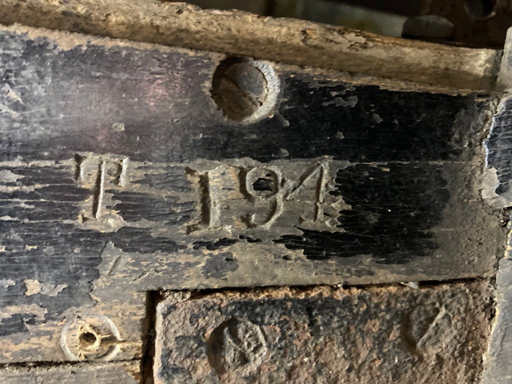

Here are some photos of the restoration. The body number is 27722, and of the original 1917 Coupelets, is the lowest number known to exist. Also, the number "T-194" is stamped onto the passenger side sill just where the floorboard goes up (It is unknown what this number represents.)

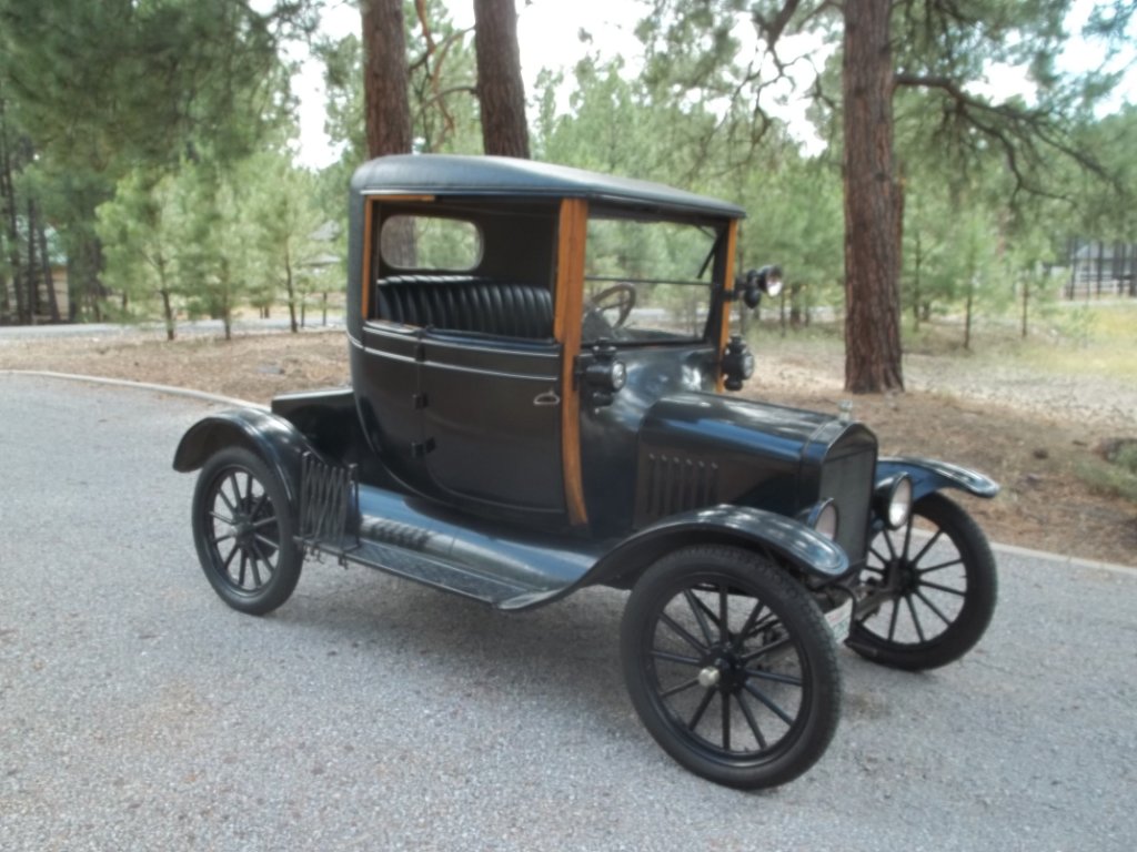

From what I have been able to determine, only five or six of this style of 1917 Coupelets exist today, and only four have their original wood with body numbers. Note the unique gas tank cover.

Years ago, I got permission the ropes at Harold Warp's Pioneer Village and examine and take photos of their 1917 coupelet.
You probably already have this information but, on the Warp car, 28850 is stamped on the seat riser and T1884 on the passenger side floor sill. I could not locate any dates stamped on the body wood but the car was pretty filthy with Nebraska prairie dust so, if there is a date stamped somewhere, I missed it.

Eric, I have seen the Coupelet at Warp's Museum. It also has a 1926 engine, but with that exception, is quite original. I would like to know what the T-194 means, but with the T-1884 Warp car number, maybe it is a sequential number of some sort. Thanks for the information. Russ Furstnow

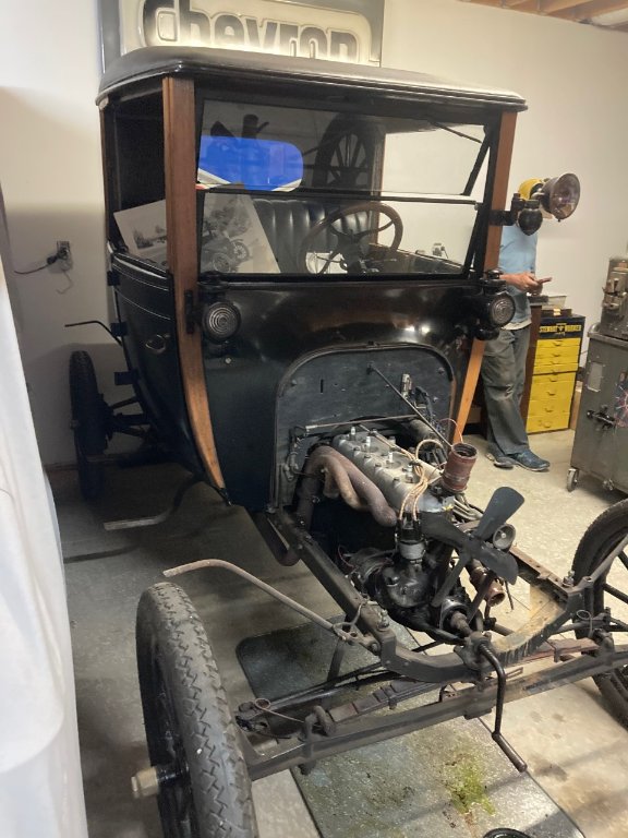

Russ, That is a real treasure. In the picture of it in the garage, what cover is on the touring car next to it? I like the way it goes all the way to the floor. Art

Art, That cover is on my 1909 Touring. I had it made by California Car Cover, and they will make a custom cover, using your specifications for any car. They make a super cover and are great to do business with. The photos shows what's under the cover. Russ

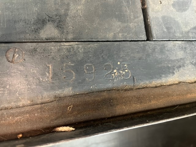

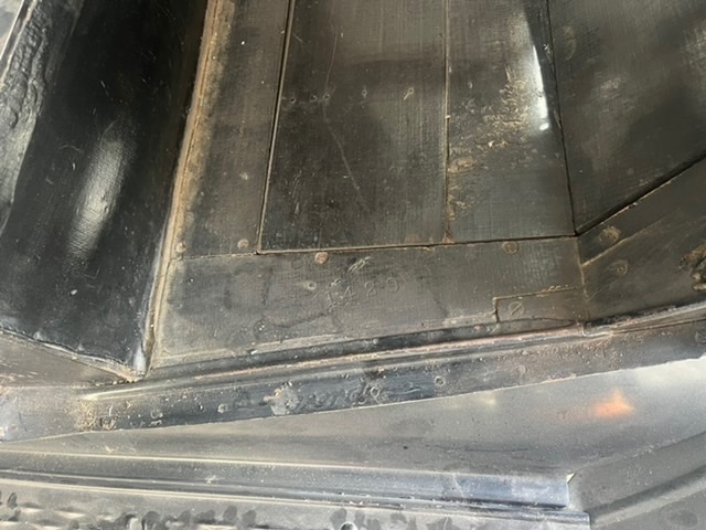

Post by KimDobbins » Tue Dec 06, 2022 12:47 pm
Russ, these are the body numbers on my newly acquired coupelet.
