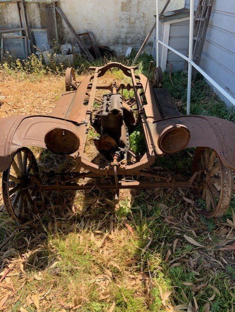

Here are some photos of the restoration. The body number is 27722, and of the original 1917 Coupelets, is the lowest number known to exist. Also, the number "T-194" is stamped onto the passenger side sill just where the floorboard goes up (It is unknown what this number represents.)

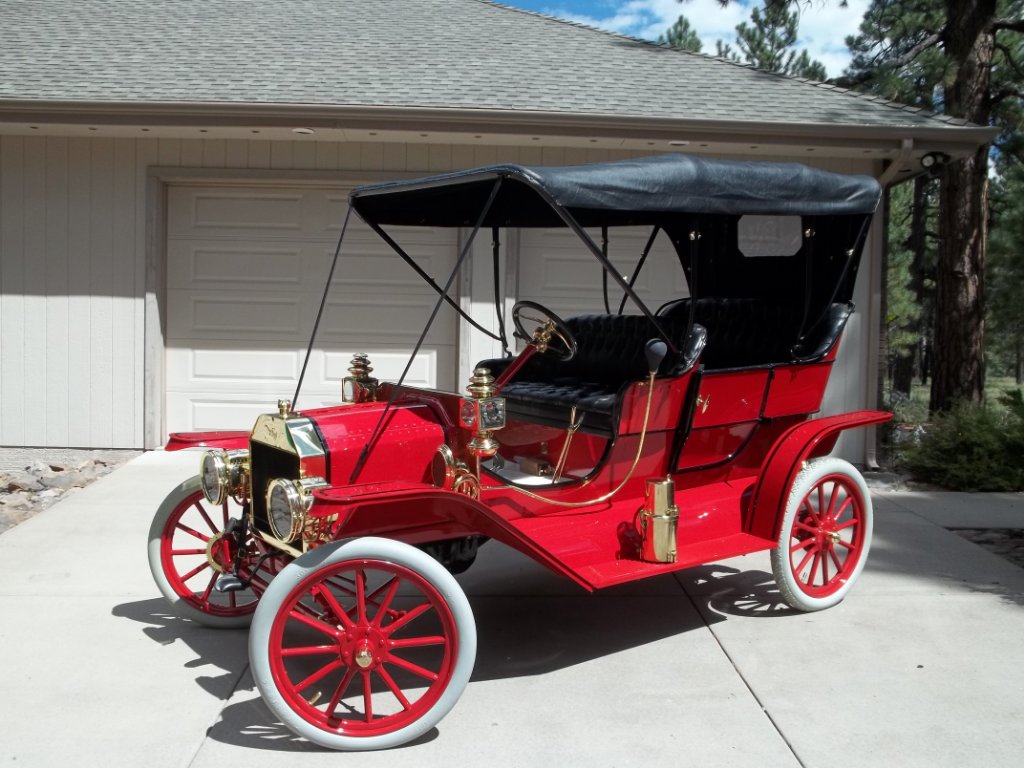

Russ, That is a real treasure. In the picture of it in the garage, what cover is on the touring car next to it? I like the way it goes all the way to the floor. Art

Art, That cover is on my 1909 Touring. I had it made by California Car Cover, and they will make a custom cover, using your specifications for any car. They make a super cover and are great to do business with. The photos shows what's under the cover. Russ
