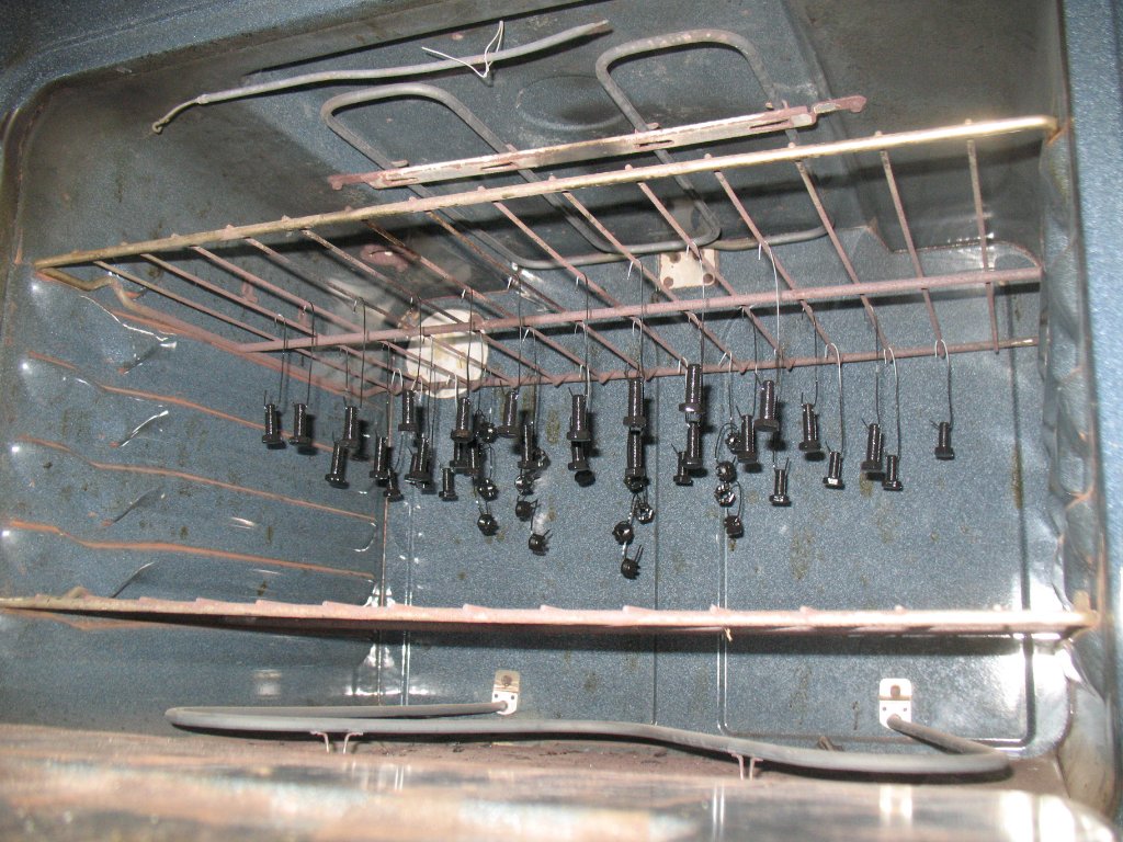

I'm pretty sure appliance enamel is glossy only, whatever the brand. I use it on body parts like headlight buckets, windshield frames, tail lights, etc. I once shot an engine block with glossy and it looked terrible, so I reshot it with satin. I now use satin on all chassis parts, including nuts and bolts. A lot of parts will fit in the oven, and I bake them overnight at about 180º. In the morning they're good to go.

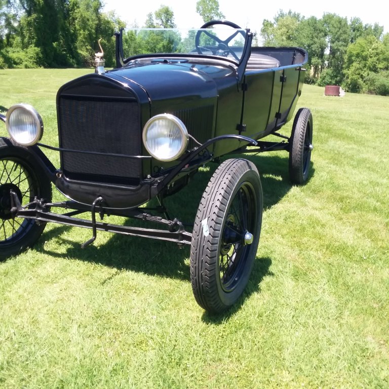

I have used Rustoleum for years and lately,if I want a BLACK glossy finish,I use the Krylon.
My small engines I restore look shiny. Really to shiny but I want them to looks "showy" anyhow.
I think I used Krylon on my pickup fenders as well for the same reason.
