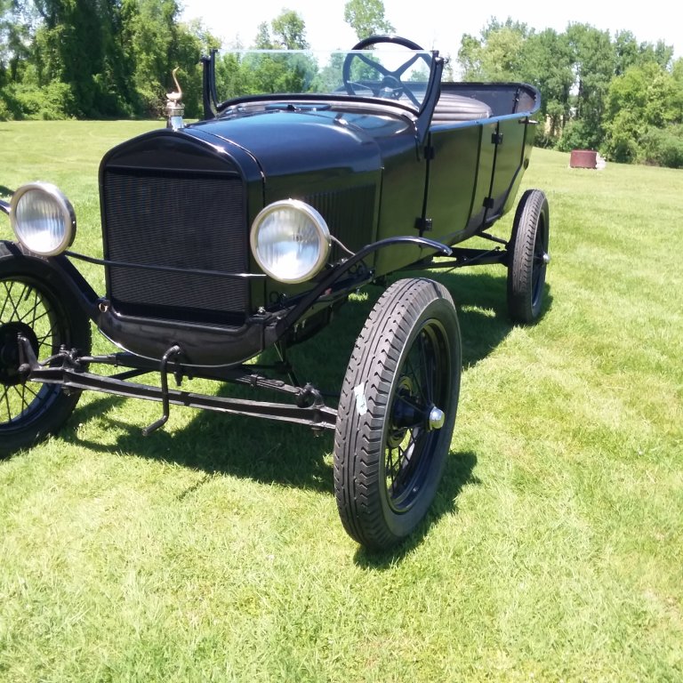

I used this on my '26 project with excellent results. Paint goes on wet with a wide spray stream. Dries to a hard high gloss finish that is wet sandable or can be buffed and polished.
i sprayed it over rustoleum gray or red primer, wet sanding between primer and gloss black.
Only negative is that the metal surface must be clean and decontaminated before priming and painting. Primer did not react, but color coat did. Bubbled madly. Drove me nuts.
Prep it right, and you'll get a nice finish that's easily repaired.
