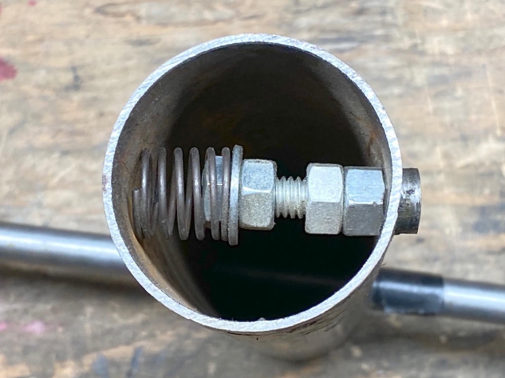

The axel sleeve tool pin is attached to a flat spring and that spring is held to the tool with a carriage bolt and nut. You should be able to tighten the nut to get some more spring force on the pin. When removing to old sleeve make sure to turn it in the direction to collapse the sleeve, the V notch in the sleeve points that direction. There should be holes in the outside end of sleeve removing tool, turn the tool with something to collapse the axel sleeve in order to free the axel sleeve dimple from the outer axel housing, then work the sleeve up and out of the axel housing.

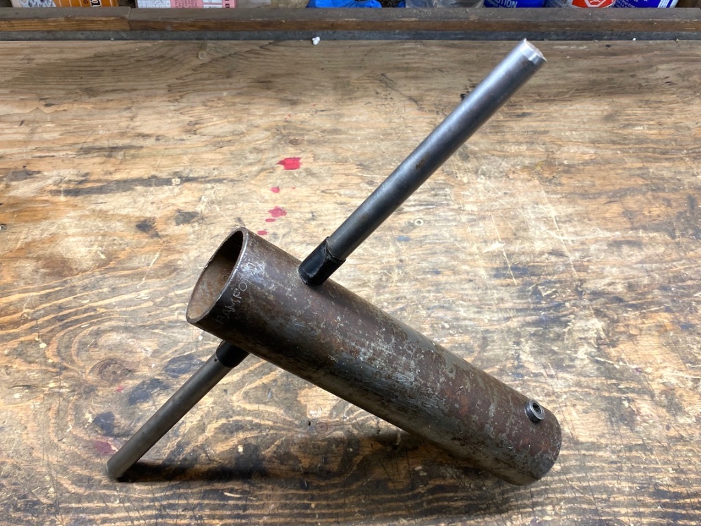

The muffler pipe tool is not great, only adequate to marginal. Make sure the pip has a good deal of spring tension. Increase if possible.Scott_Conger wrote: ↑Sat Dec 10, 2022 8:09 pmWell, they can be hellaciously stubborn

The sleeve hole needs to be clear. I find a 90 degree scribe or pick will clean the hole of the old grease.

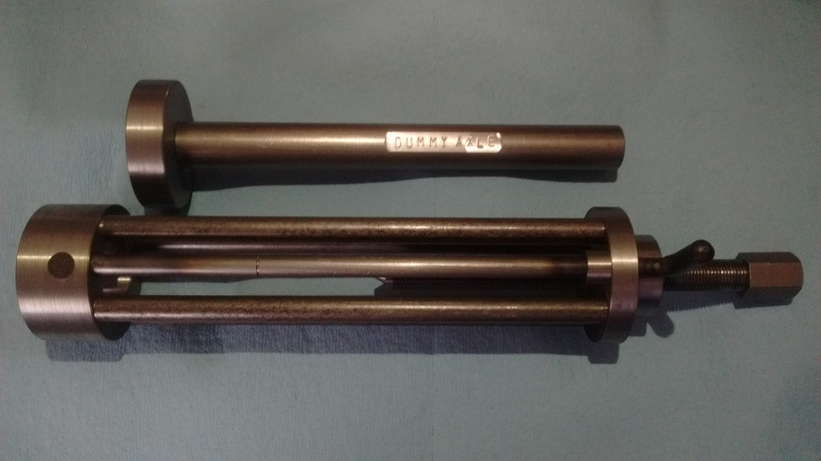

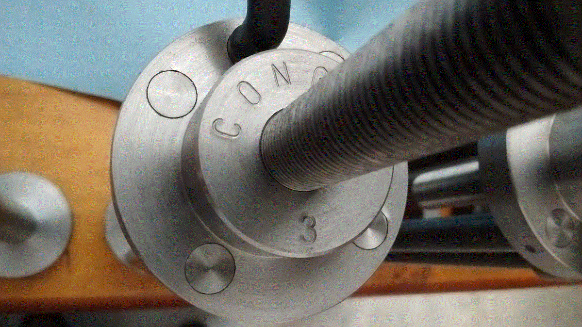

Several years ago I made some reproduction Cantrell-Miller sleeve pullers. Now THOSE things pull out sleeves...
The Stevens tool for that is a massive affair and I have no desire (for now) to reproduce them

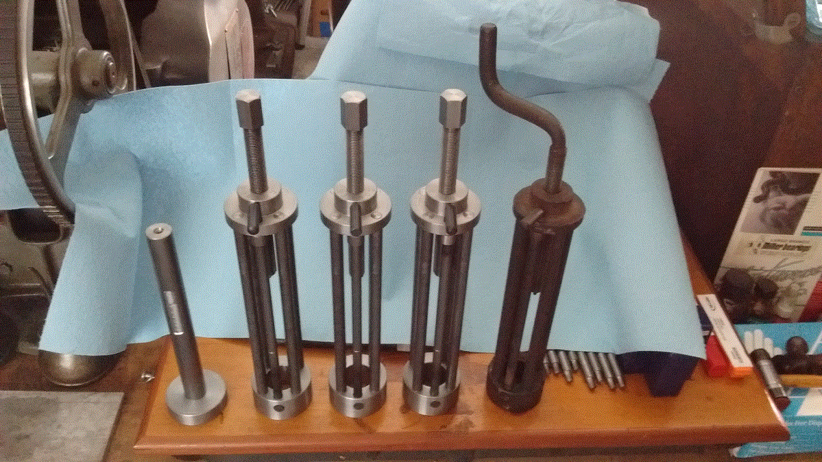

Three Cantrell-Miller-Conger sleeve pullers and dummy axle next to an original:
- Posts: 5254
Re: Pulling outer bearing sleeves
I also made 3 of these pullers also. Too bad they are not vendor offered. I didnt see a profit in it myself.
They work extremely well. My dummy axle was made from a transmission center shaft. The handles I made 2" longer for better leverage.

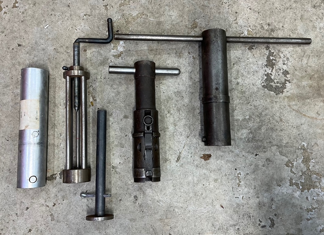

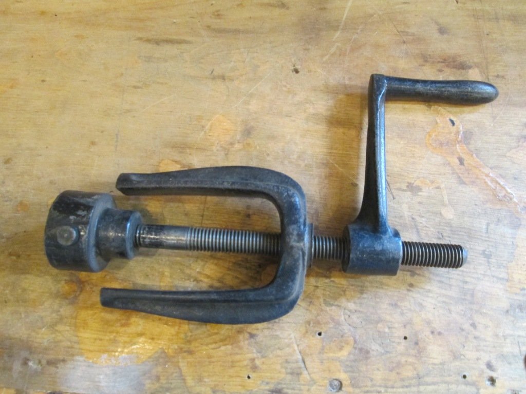

I guess you could say I have a thing for sleeve pullers.
- Posts: 5254
Which of the right 4 do you prefer?

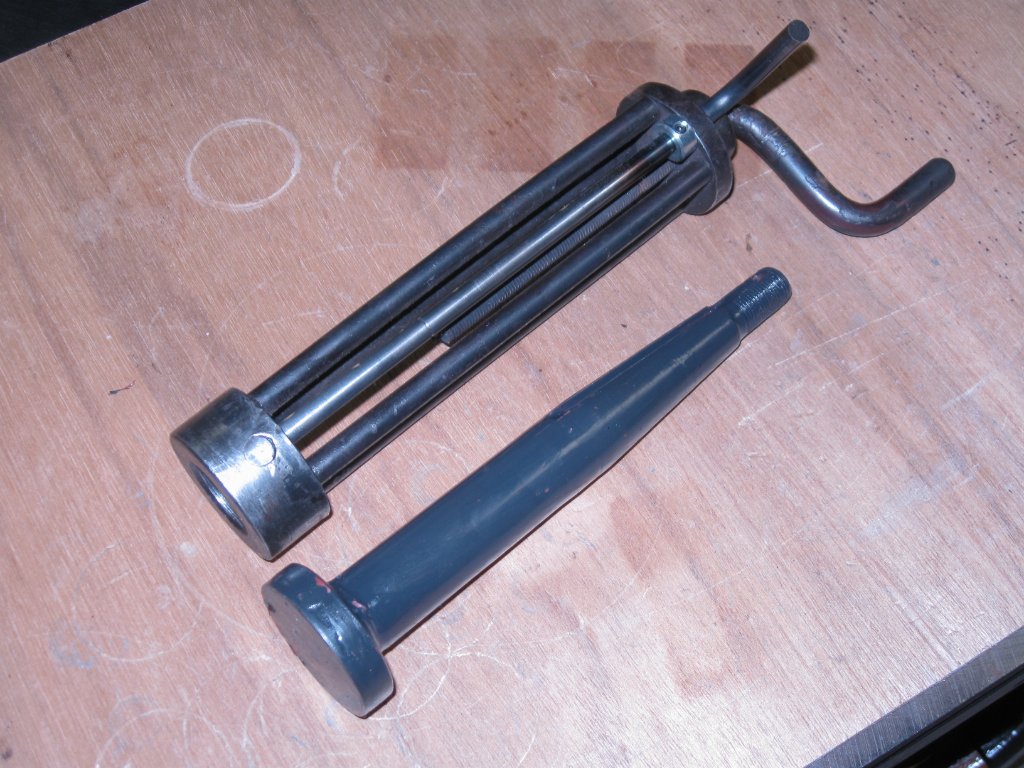

Kind of late to the party, but here is the sleeve puller I made a few years ago. Seems to work fine and it's always fun to build something from "on-hands" instead of store-bought.
In the lower photo, the plunger pin and right hand nut are actually one piece and made from a 5/16" extension nut.

Clever idea making the pin out of the right hand nut.
