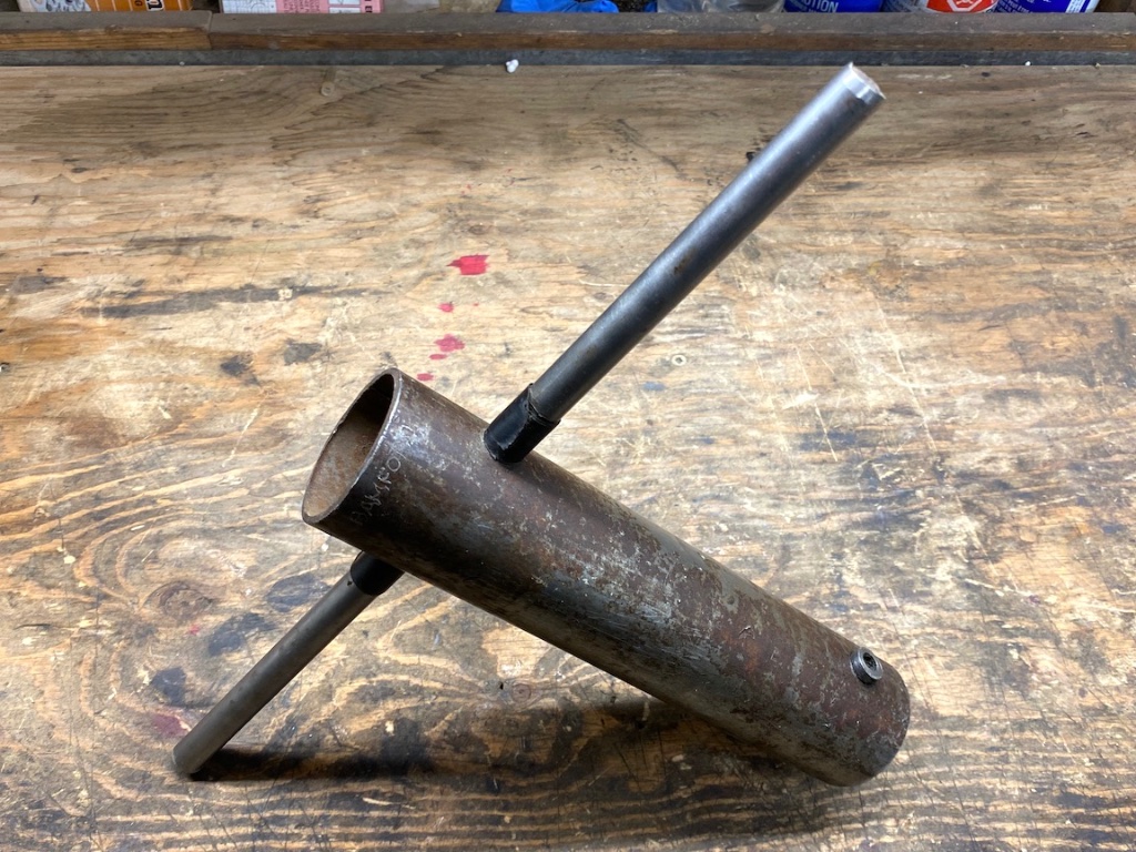

Kind of late to the party, but here is the sleeve puller I made a few years ago. Seems to work fine and it's always fun to build something from "on-hands" instead of store-bought.
In the lower photo, the plunger pin and right hand nut are actually one piece and made from a 5/16" extension nut.

Clever idea making the pin out of the right hand nut.
