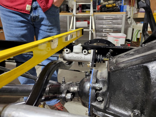

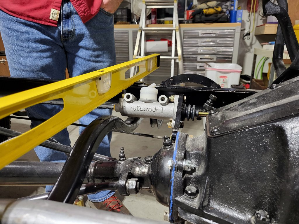

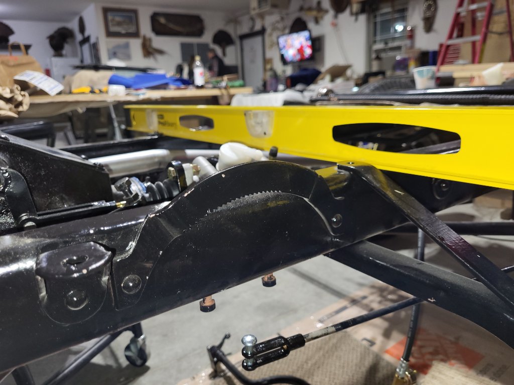

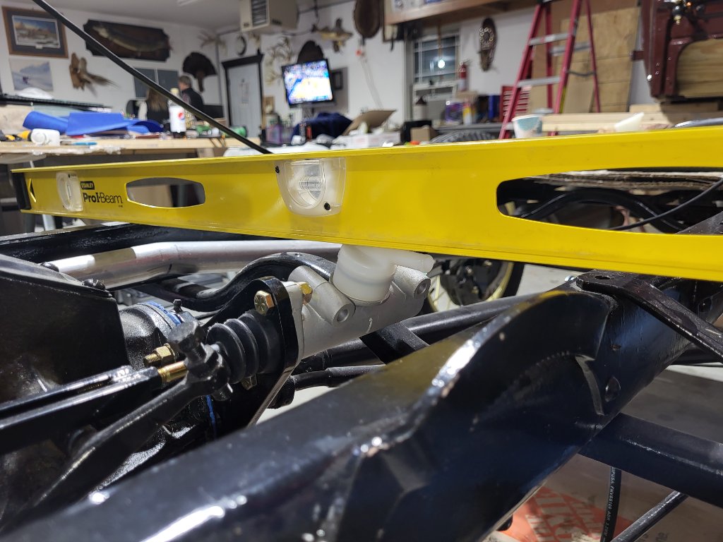

It looks like the master cylinder for my disc brakes will not fit under the floorboards. What experience have others had with this situation?

I knew the floorboards did not set on the frame. I had set the new floorboards in place in the body, and without measurements, it appeared there likely would not be room underneath for the cylinder. Meaningful measurements will be difficult. My post was meant to see if others had actually had problems with interference between the cylinder and floorboards.
