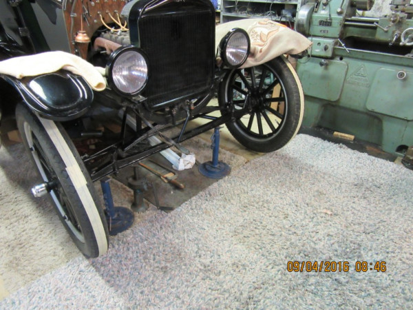

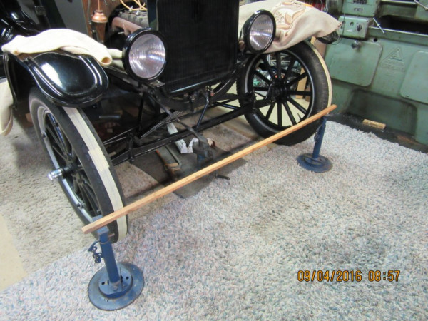

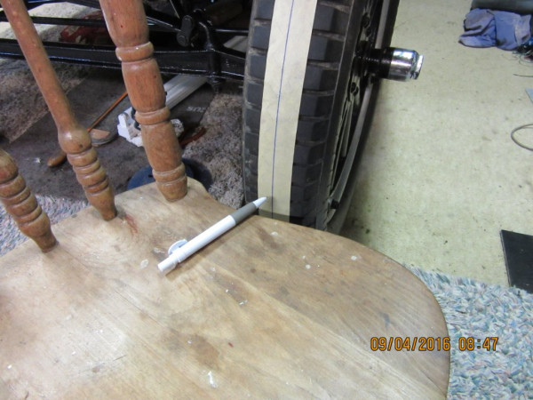

- Posts: 4496
Re: Wheel Alignment on a 1915 Touring
This is the best method, (in my opinion). Notice that the dimensions are taken with the front wheels back on the ground. I would even roll the car ahead a few feet before measuring.
