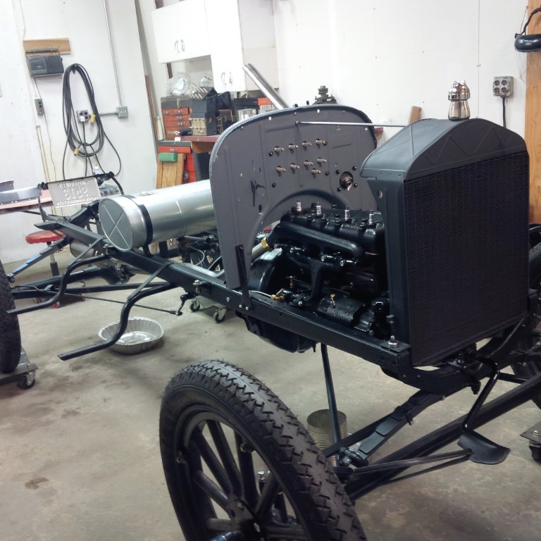

Post by rickd » Fri Jan 06, 2023 11:10 am
