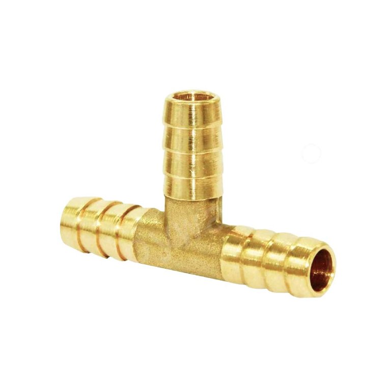

Scott-
Larry and I have been talking about converting 1/4" or 5/16" T barbs. The outside diameter needs to be 3/8", inside 1/4", and a total length of 7/8"
Cut the ends off and drill it out. Easy peasy. Way more easy than the labor you and I put into making ours. I look for ward to seeing a picture of yours.
Ideally, if the raw castings could be obtained before any machining is done, it would be easy. But right now I've got other projects going on.
RV was going to make some square nuts for me. Guess I'll have to make those for myself too...
Keith

The picture Keith posted will do the job. I did it. Its is a bit smaller than the original, but will work well. They are available off ebay, and have a China origin. I think I paid $7.00 for two.

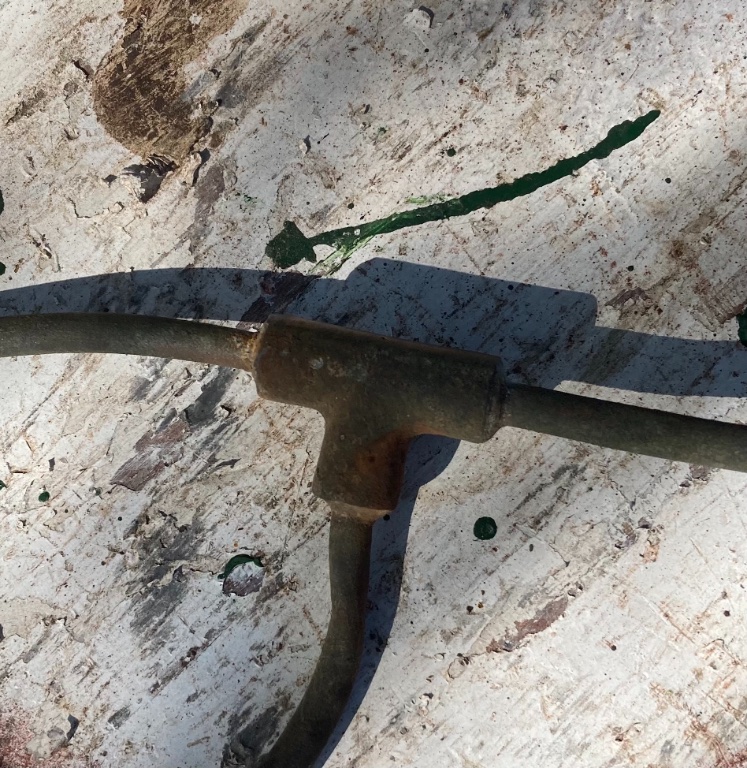

Mark, Here’s a pic of the tee of which I made mention. I tried a magnet on it with no attraction so it must be brass or bronze. And I’m surprised Original is going to china for his new repurposed gas headlamp tee.
I’d recommend cutting the gas line in 3 places about an inch from the tee so you’d have something to grasp when unsoldering. Postage should be about $4 and the bubble envelopes are $1.5 so $5.5 should get it to you .... if still interested.

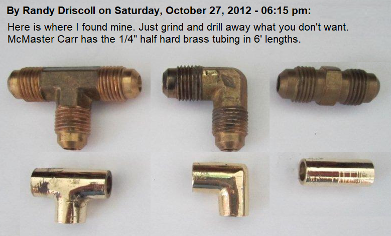

Hi Keith:
Mine looks like the new one to the left above. Pretty much same approach, and really easy to do once you get to taking off material. As noted, I did have to punch the 1/4" clearance hole...I presume the barbed donor does not require this step.

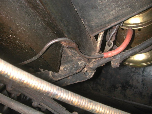

Re: Gas line tee
Scott what "sharp bends" for the passenger side? There were no sharp bends for 1911.
What year are you working on?
Here is an image of (I believe) Kim Dobbins' 1910 passenger side:
Scott Rosenthal
Topic author - Posts: 397
- Joined: Sun Jan 13, 2019 11:29 am
- Last Name: Rosenthal
- * REQUIRED* Type and Year of Model Ts owned: 12 Towncar, 12 Touring, 09 Touring
- Location: Cincinnati OH
Re: Gas line tee
Yep, that's that's the one Keith. Using a coil.spring to bend it vs. brake line bending tool. Pretty much same as Bruce's photo shows. Made the brakets some time.ago, so just about to solder it all up. Did you solder ferrules on your tube ends, and did you use hose clamps or not?
