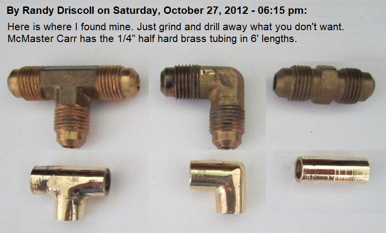

Looked everywhere for acetylene line brass tee, then saw where Keith T. posted a photo of the one he made. Here's mine...Thx Keith.

I used a std 1/4 compression T, but found I still had to drill it thru...took a half hour to make. These, the clamps, and the square nuts could be a nice kit for some enterprising other. RV said he was planning to make the hardware...not sure if any were produced.

Larry and I have been talking about converting 1/4" or 5/16" T barbs. The outside diameter needs to be 3/8", inside 1/4", and a total length of 7/8"
Cut the ends off and drill it out. Easy peasy. Way more easy than the labor you and I put into making ours. I look for ward to seeing a picture of yours.
Ideally, if the raw castings could be obtained before any machining is done, it would be easy. But right now I've got other projects going on.

The picture Keith posted will do the job. I did it. Its is a bit smaller than the original, but will work well. They are available off ebay, and have a China origin. I think I paid $7.00 for two.

Mine looks like the new one to the left above. Pretty much same approach, and really easy to do once you get to taking off material. As noted, I did have to punch the 1/4" clearance hole...I presume the barbed donor does not require this step.
