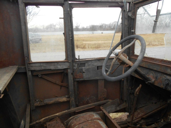

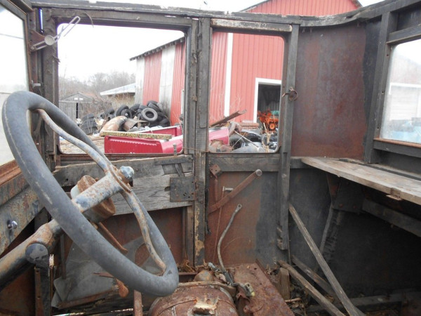

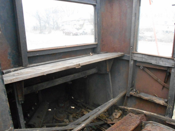

Hi Ron. I am hoping these help.

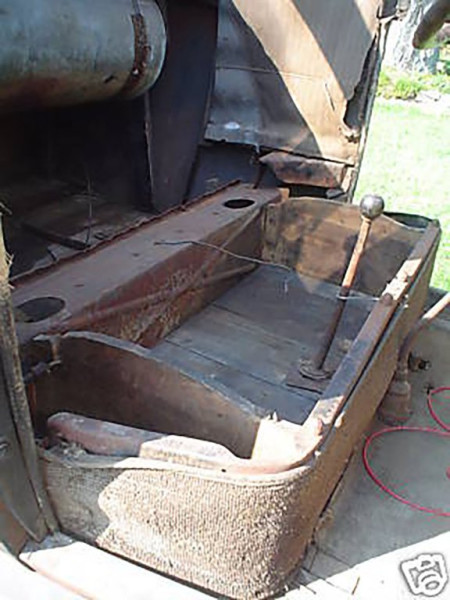

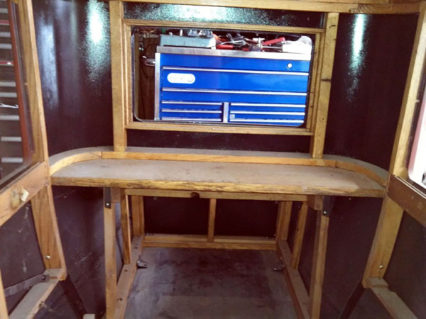

Post by Rich Eagle » Mon Jan 23, 2023 4:28 pm
Maybe this one too.

I suspect the metal support just back of the gas tank is screwed or bolted. They didn't weld much of anything on these bodies. I don't have a picture of that area. Maybe someone else does.

The metal support just behind the gas tank is screwed in to the wood rear floor. There is NO welding anywhere on Model T bodies with wood construction.
If you’re determined to move the seat parts back remember you will need to fill in the wood floor section that you will leave open when it’s moved back. I’m 6’3” and if I wanted to move the the seat back farther my head would hit the rear window. That’s not for me. So I’ve accommodated myself in my 24 Coupe and for me it’s OK.
There is no wood flooring directly under the seat section on an original car and when it’s moved back and that section will be left open.
The photo that Rich shows of the front seat removed is someone’s long ago custom build that was added for the accessory transmission and it was filled in with wood to cover up the original open area.
Good luck with your endeavor to want to do this.
