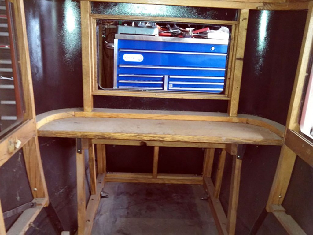

I am certain the package shelf can be removed to give more leg room. From the photos I have seen this would involve moving the gas tank back along with the seat riser and then reconstructing the seat back support. I know its not a project for everyone but at 6'3'' its worth the effort to get an additional 4 inches or so.
Any photos of the seats removed would be appreciated as the car is currently out of state.
Ron
Ron

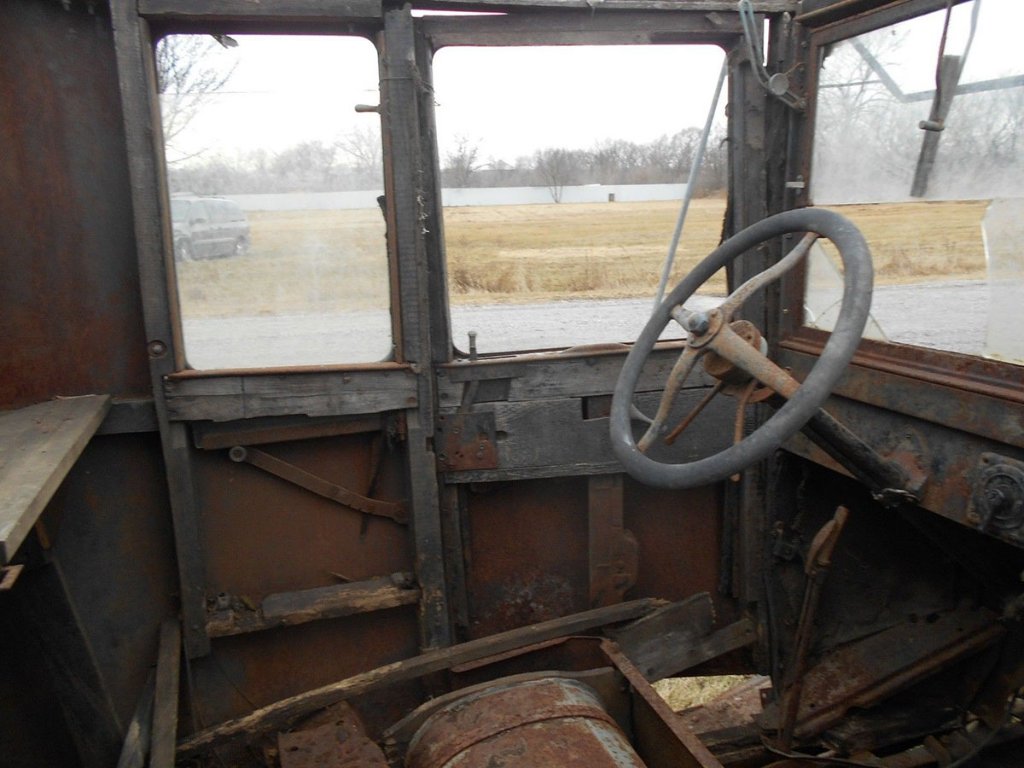

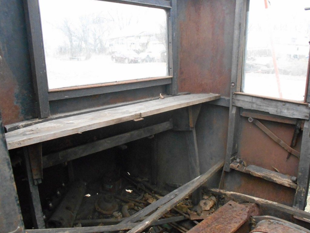

Thanks Rich
Is the metal support just back of the gas tank welded or bolted to the floor/frame? If this piece cannot be moved back I will need to look into relocating the gas tank to the trunk or shrinking down the tank. My hope is that it can be moved back allowing me 4" or so to push the gas tank back. Thank you so much for the photos.
Ron

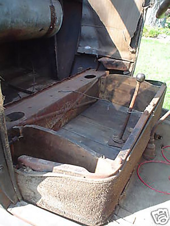

Basically I am looking to remove the package shelf and push the seat riser back to get the leg room in the pre 1924 Coupe's that had the gas tank in the trunk. Thanks again for all your help as I will make this work.....little metal fab and wood construction is not going to stop me lol
Re: 1924 Coupe Interior Photos
I suspect the metal support just back of the gas tank is screwed or bolted. They didn't weld much of anything on these bodies. I don't have a picture of that area. Maybe someone else does.
- Posts: 4531
The metal support just behind the gas tank is screwed in to the wood rear floor. There is NO welding anywhere on Model T bodies with wood construction.
If you’re determined to move the seat parts back remember you will need to fill in the wood floor section that you will leave open when it’s moved back. I’m 6’3” and if I wanted to move the the seat back farther my head would hit the rear window. That’s not for me. So I’ve accommodated myself in my 24 Coupe and for me it’s OK.
There is no wood flooring directly under the seat section on an original car and when it’s moved back and that section will be left open.
The photo that Rich shows of the front seat removed is someone’s long ago custom build that was added for the accessory transmission and it was filled in with wood to cover up the original open area.
Good luck with your endeavor to want to do this.
