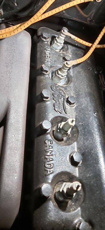

Ron, my Prus alloy head has the Ford script and Made in Canada. I added them. I made a little dam with plasticine for each word, and filled it with Devcon. Then i drew the lettering on the hardened Devcon and hand carved the lettering using an Exacto knife and my Dremel tool . It even has the casting date of the original iron head. Once painted, no-one has ever noticed it was there, let alone questioned the origins of the head.

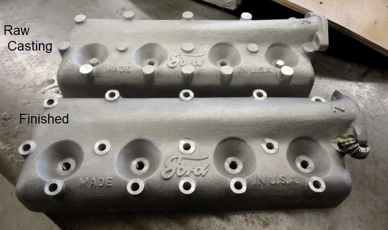

Here is the guy in Michigan that has new hi compression aluminum heads with Ford script and made in usa. These are the Z combustion chambers. He states that a model t engine will develop approx 27 horse power with this head. The new head holds an additional quart of water. The head weighs 15 pounds. The price is $330 including shipping and boxing. The Ford script is nice and sharp and well defined. I just received my 2nd head from him and the quality is perfect. The machined head surface is just a din finish, which is the same spec that I use on Ferrari's and Subaru aluminum heads.
contact, Steve Zajicek
586-983-9771(Warren Michigan)
You won't be dissapointed!!

Wasn't it Ralph Zajicek who made the Z head? Perhaps Steve is a son/relative. Z heads have been available for a long time.

Allan, I would be interested in your work. Do you have pictures of how you made the "Made in Canada"?

Vonau, I did not take pictures when doing the work. I copied the embossing from the original cast iron head that was on the motor, and included the casting date, just because I could!

I have a Z head on my '17. It does have "Ford" cast into it. The engine has been run on a dyno and achieved 27.32 HP at 1750 rpm with a NH carburetor, 22.65 HP at 1750 rpm with a Holley G.

The 'Z' Heads have always been high heads and had Ford Made In USA on them. Prus heads are high heads and are plain with no markings. They are the only heads being produced (in stock configuration) presently that I'm aware of.

I'd love to see a photo if you have one handy.Allan wrote: ↑Mon Jan 30, 2023 11:03 pmRon, my Prus alloy head has the Ford script and Made in Canada. I added them. I made a little dam with plasticine for each word, and filled it with Devcon. Then i drew the lettering on the hardened Devcon and hand carved the lettering using an Exacto knife and my Dremel tool . It even has the casting date of the original iron head. Once painted, no-one has ever noticed it was there, let alone questioned the origins of the head.

Let me correct a previous post that new heads with Ford script not made anymore WRONG!!!! I just purchased my 2nd one and had it delivered last week. It is true that from time to time they might not have one in stock but a couple of weeks after you order and its on the way to you.

That is excellent craftsmanship, Allan. Very well done.
