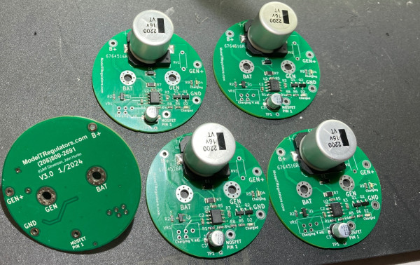

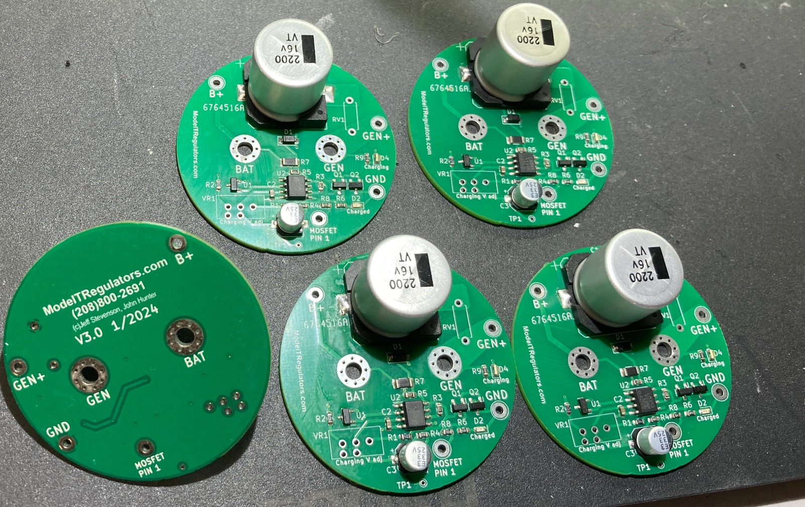

Yup. Essentially it accomplishes the same exact thing albeit in a somewhat different way electronically speaking. I just checked and your package just made a pit stop in HONOLULU, HI. It should get to you in Australia on Thursday!
Good news to report on the regulator front. I finalized & tested the fully assembled circuit boards and a couple hundred of them will be here next week. I gotta say, hand building 150 of these things so far one at a time was taxing my tired, old, sometimes unsteady hands. I also just got 3 samples of the new cutout tops and they are literally perfect, so now I don't have to scrounge around any longer for more cores. 1000 of those will be here in March.
It's been an inspiring and humbling journey getting to this point and I have LOTS of folks in our community to thank for helping me get here. I have renewed appreciation for all the vendors who produce products for our hobby. Model T guys are such cheapskates (I'm squarely in that category btw), and it really takes some out of the box thinking to bring stuff to this market and do it in a cost effective way.
Jeff
