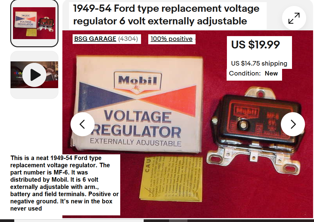

I virtually don’t know anything about voltage regulators so be gentle ha. This horse has been beaten to death but I’m not sure I’ve read anything on the forum about using a 1940’s-50s automobile voltage regulator on a model T. I’m sure someone will be able to find an old post but thought I’d ask anyway. I’m a glutton for punishment, I have a 49 F100 that has a 6 volt system, generator & a voltage regulator on the firewall and I was wondering if it would be reasonably easy to use one on a model T. It appears that the Fun projects one (i have 3 T models that have them) will not be available for now & possibly into the future. Yes I know it’s not what Henry did but l’d like one anyway. So you guys with a ton of electrical expertise please teach me so I can learn. Best John

Why not buy one made for your 1949 F100 https://www.google.com/search?client=fi ... 9++49+F100JTT3 wrote: ↑Wed Feb 01, 2023 6:16 pmI virtually don’t know anything about voltage regulators so be gentle ha. This horse has been beaten to death but I’m not sure I’ve read anything on the forum about using a 1940’s-50s automobile voltage regulator on a model T. I’m sure someone will be able to find an old post but thought I’d ask anyway. I’m a glutton for punishment, I have a 49 F100 that has a 6 volt system, generator & a voltage regulator on the firewall and I was wondering if it would be reasonably easy to use one on a model T. It appears that the Fun projects one (i have 3 T models that have them) will not be available for now & possibly into the future. Yes I know it’s not what Henry did but l’d like one anyway. So you guys with a ton of electrical expertise please teach me so I can learn. Best John
If you don't trust eBay then local Parts Suppliers would be able to get one
Model T VR's are currently being made by our forum Admin www.modeltregulators.com
