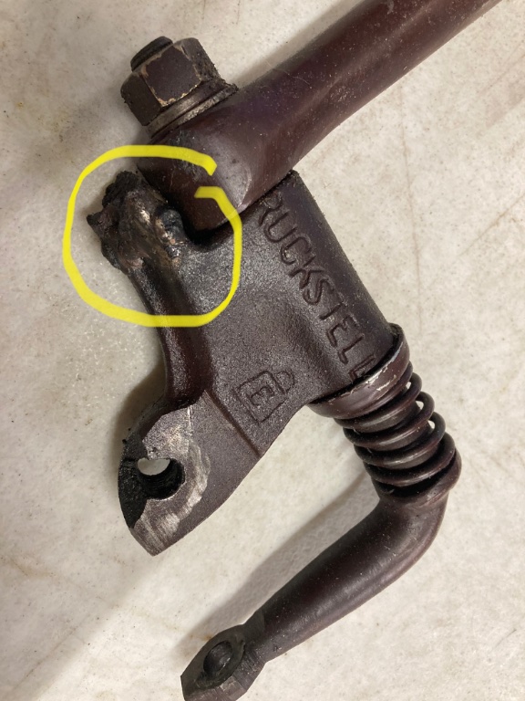

Current status: Shifter broke where someone had previously welded the casting down where it attaches to the transmission. Easy enough fix, just need to order a new shifter.
In the meantime, the axle is in low and we've been graced with a few sunny days following more arctic-like weather. I'd like to drive the car and not be in low axle gear all the time.
Should I support the rear, get the wheels spinning (no, not with the motor running), and ease the Ruckstell back into high? I tried the lying on my back method and jiggling the shifter rod back and forth to no avail. All wheels on the ground.
I don't have a good understanding of what goes on back there with the Ruckstell. Might be some magic involved for all I know. Or maybe the spell wore off.
Thanks for any suggestions.

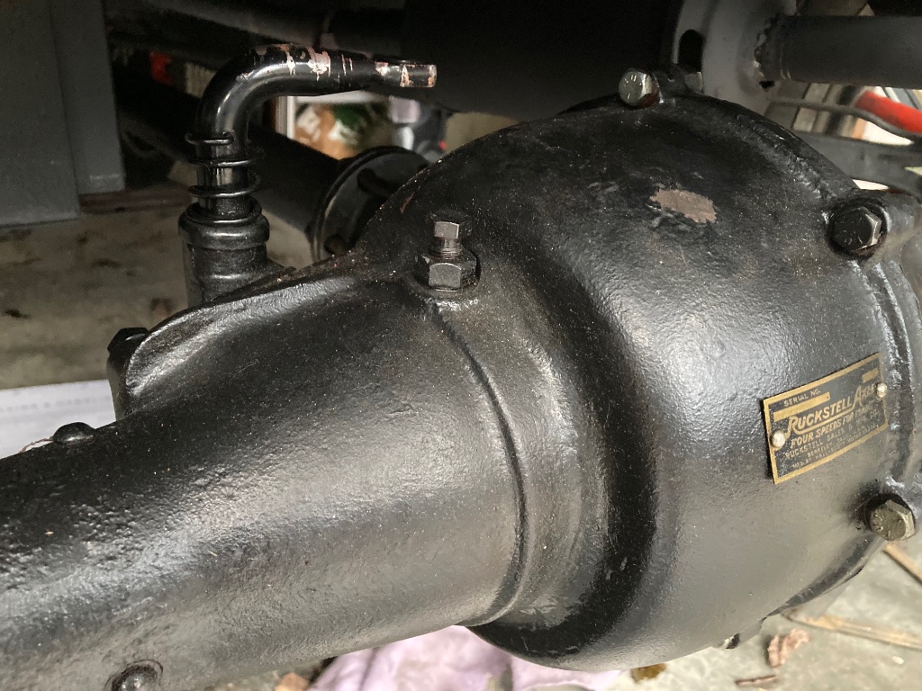

Thanks everyone for your input. Here are a couple visuals. Are there any unusual precautions I should take when removing the shift housing to look inside and clean? Springy things ready to fly out? Still in my first year of Model T ownership so I’m treading very softly here, don’t want to damage anything else.
I circled where the shifter was welded or more likely brazed. I know most of you have a more discerning eye than the general population, just wanted to enhance the visual aide and besides I like playing with my phone’s photo editing feature.
Gerrit
Gerrit
- Posts: 5254
Re: Shifting the Ruckstell at a Standstill?
The shiftlock unbolts as a unit. Nothing to fly off & get lost.
When you have it off you can manipulate it in a vise to check its function. Also move the internal locking sleeve with a screwdriver. It should engage/disengage easily with the correct lineup.
You might send a picture of the plunger & locking teeth area so we can access condition.

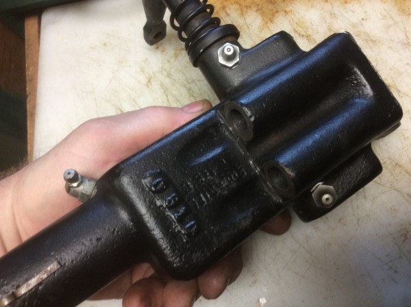

I would look for another part. Yours is pretty bad. It is a late one too, made by Eaton.

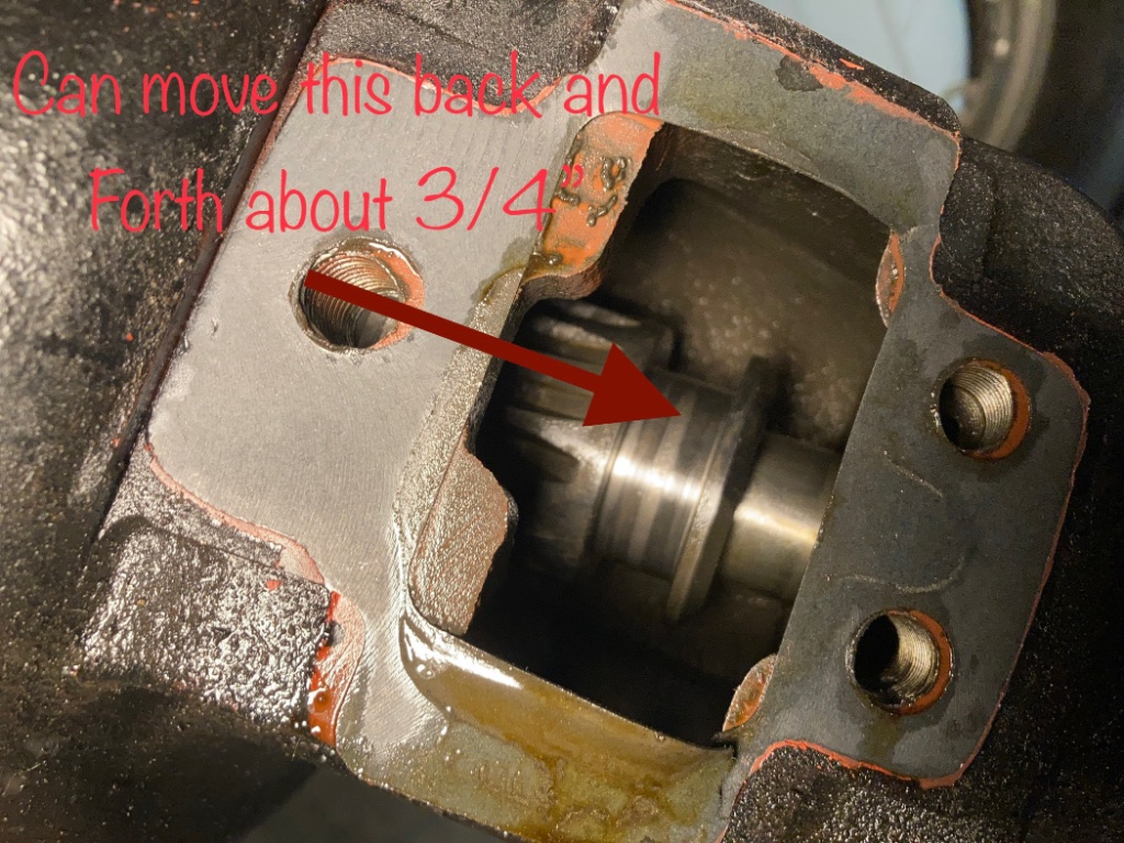

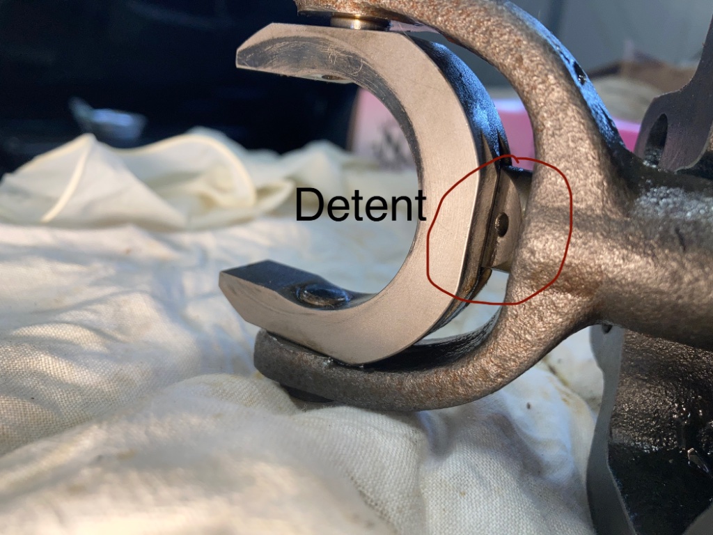

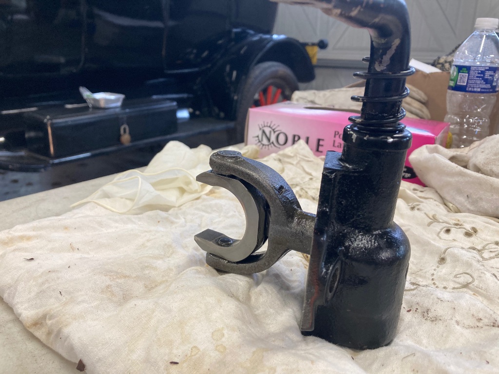

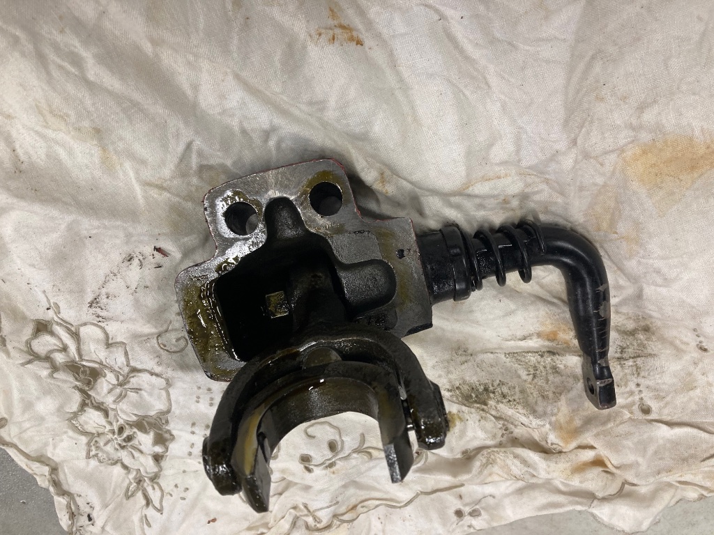

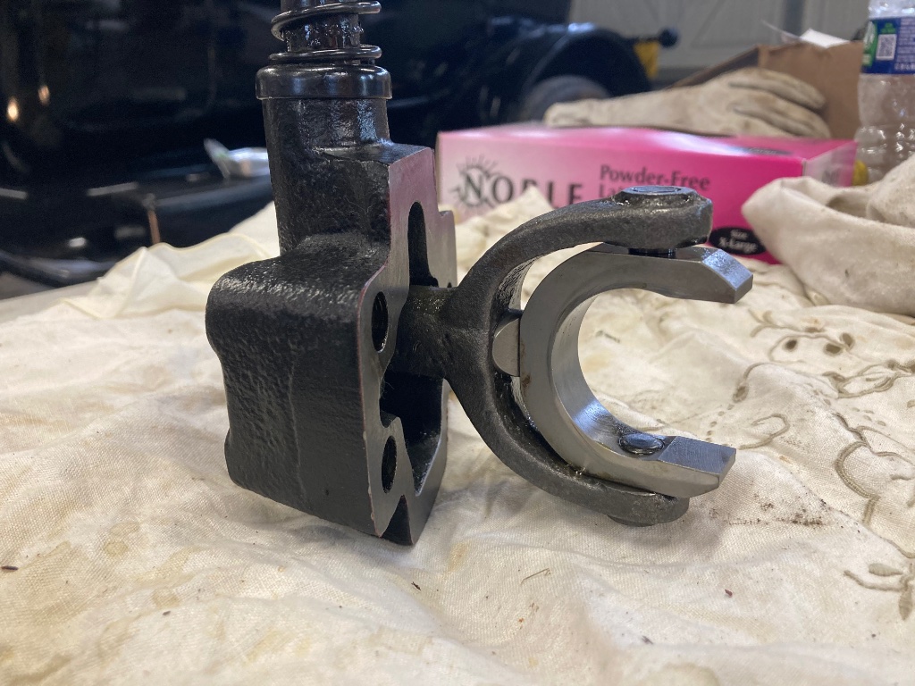

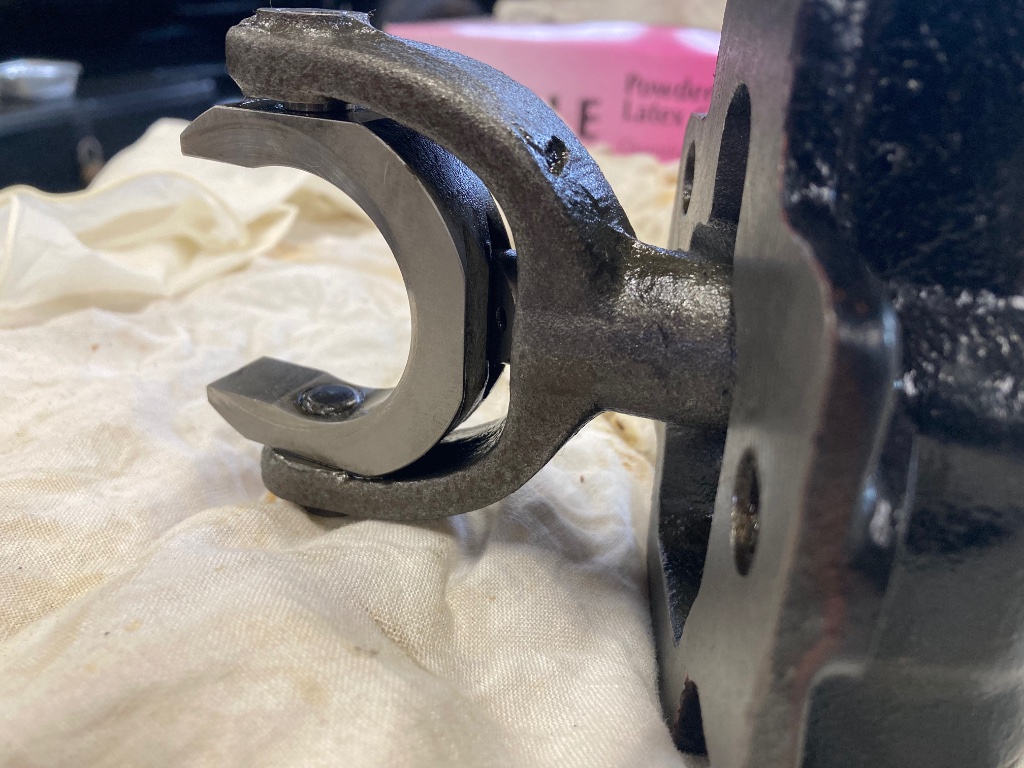

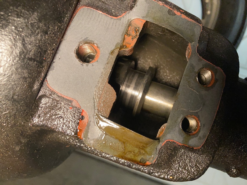

Brief update with visuals. The shift lock assy came off easily. The shift rod and fork appear to move as one with no slop or play.
I’m also able to slide what I call the shift collar or bushing back and forth on the axle. Still not going into direct drive, though.
Feel free to ask anything that might put more light on this situation and thank you everyone for the advice. Go Chiefs.
Gerrit

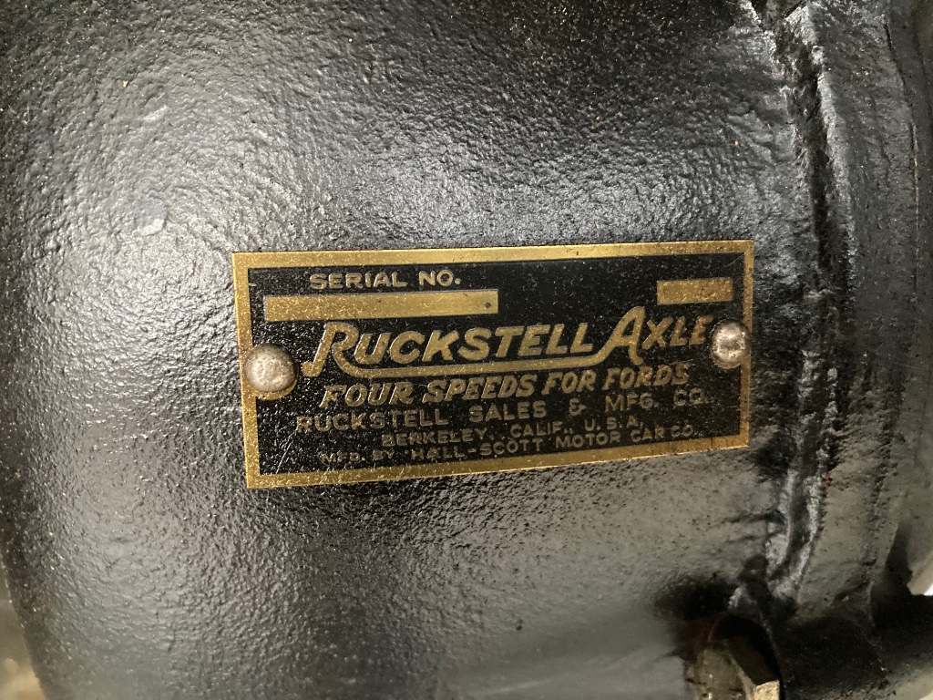

It looks like I’ve uploaded duplicates of the same photo. Not my intention, but I don’t know how to undo it so I’ll leave as is.
Gerrit

take a look at this video toward the end https://www.youtube.com/watch?v=0blycihFifg
you'll see the "3/4 inch" movement you're mentioning and then with a slight manipulation to get things lined up perfectly, it throws fully into direct drive
are you moving either the differential or wheel some when trying to get the sliding gear to move?
It's time to try to find someone locally/nearby with experience, or you're going to end up tearing this thing down and I'm not yet convinced that this would be completely necessary (unless simply to learn how it all works, but that's a labor-intensive way to learn just for the sake of learning)
- Posts: 5254
Slider movement looks ok. The shift collar teeth should be clear of the lock plate. The axle should be rotatable.
Check the plunger in the shift lock. It will be stiff, but movable. The shiftlock has been rebuilt or is new.
If the plunger body casting is original, you may have an oversized plunger locking up in its hole as I alluded to previously.
See if you can get that plunger to retract & return. Since you are able to easily move the slide collar, you issue is with the plunger and or spring.
- Posts: 5254
The video doesnt show the lock plate engagement. It sits on top the bearing.
As shown the collar down still rotates because or the missing lock plate.
When it appears locked, the collar is up to high & into the brass bearing plate clearance teeth.
Misleading of the actual function positions.
- Posts: 6800
Thanks John. I guess I didn't view it with a critical enough eye to realize that.

Thanks for the replies and suggestions. I’ll have more time tomorrow to investigate further.
Quick question: should I be looking for the mechanism to be moving outward towards the road wheel to disengage the Ruckstell? To reiterate, it’s now stuck in Ruckstell. At the moment I’d be happy with direct drive since I rarely used the gear reduction. The video was helpful, gave me a better understanding of how it works.
Gerrit
Gerrit

5 WoodenWheels wrote: ↑Sun Feb 12, 2023 9:28 pmThanks for the replies and suggestions. I’ll have more time tomorrow to investigate further.
Guess I should have been more clear: the Ruckstell disengages towards the left rear (driver side) wheel?
Sometimes I write something then realize I’m the only one who could possibly understand what I was talking about
Gerrit
- Posts: 5545
The sliding clutch gear (the thing you are looking at in the hole) slides towards the passenger side to engage the underdrive, to drivers side to disengage.
- Posts: 5254
There is also an in between spot, just as the sliding collar disengages the lock plate. Thats a neutral spot.
- Posts: 1217

Thanks for the replies. Now that I’m on a more intimate basis with the Ruckstell, is there a way for me to manually get it out of underdrive? You know, in case I’m itching for a wild night on the town and want to go faster than 15 mph?
For those reading this far, you get another photo. I see there are two detents in what I’m calling the shift fork. Is it possible the wrong one is engaged? Does it matter? It looks like I may have to take apart that assembly but I’ll accept any reason you may give NOT to do that.
Gerrit
Gerrit

at great risk of looking silly twice in a single thread, I'll say that there is no right or wrong detent position. Those detents are what keep the sliding gear slid over one way or another; in planetary mode or direct mode.
As clean and dry as things look, is it simply possible that the detent is partly seized in it's hole and making the shift extraordinarily difficult?
Kevin Pharis
- Posts: 1656
- First Name: Kevin
- Last Name: Pharis
- Location: Sacramento CA
Those detents are stout! You will need to clamp the shift fork or housing in a vice, and use a crescent wrench for leverage to toggle the throwout collar. If you can not get the collar to toggle over, ensure that the plunger is free by using a screwdriver to pry the plunger back
- Posts: 5254
Using the hole in the plunger, try to pry it down into the hole.
The spring is stiff, but the plunger must retract to move to the next detent.

Looks like I may have dragged a red herring through the discussion by mentioning “detents.”
Goal is still to disengage the Ruckstell. I welcome any thoughts on how to accomplish that. I’ll study the problem on my own as well.
BTW yes I cleaned the assy up to get a better look at parts I’m totally unfamiliar with but am getting to know better. That’s why it all looks so clean. I’ll reassemble with a good coating of grease.
Not loving the Ruckstell.
Gerrit
Gerrit
- Posts: 5254
That C shaped thing in the shift lock has 3 sharp teeth. The detents are the 2 valleys between the sharp teeth. It would be possible to put in a vise & shift to the other detent spot. However that doesnt solve the problem. You want to be able to use rux as needed.

You stated in an earlier post that your sliding gear moves approximately 3/4”. This sliding gear has 2 gear sections on the same shaft. The gear section you can see thru the shifter hole simply engages and disengages into a locking plate anchored into the housing by 2 conical tipped bolts and jam nuts. The inboard gear section rides inside the sun gear and bronze thrust plate. When the sliding gear is pushed inward toward the center section, the sliding gear connects the sun gear to the locking plate engaging the Ruxtell gear reduction. As you slide the sliding gear outward toward the wheel, the sliding gear will disengage from the locking plate, and the inner gear section will engage into both the sun gear and the bronze thrust plate, now in direct. If the sliding gear is over traveled toward the wheel, you will find that the inner gear segment will disengage from the sun gear leaving the rear axle in neutral. The shift tower holds the sliding gear in the proper location for each gear. Pretty sure the sliding gear only travels about 1/2” when shifting…

Thanks for the additional info. I’ll study the exploded diagrams and the parts I see in front of me and make some sense of all that. I’ll check back with any progress.
Gerrit

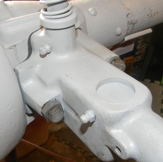

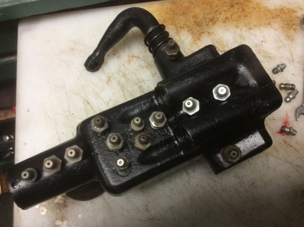

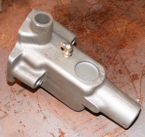

Gerrit you have the 2nd iteration of the shift lock I believe. They are really simple to disassemble. Just a possibility that I experienced with the same type shift lock. The tooth that is spring loaded that goes into the “detent” may have a jagged edge that is catching & keeping you from shifting . I found that to be one of my issues among many, so I took that tooth and dressed it with a file. It worked to a point but on disassembly I noticed that the “detents” on the yoke had wear ridges that were so deep it changed the angle for the tooth to slide over and were a major part of the problem. I choose to replace both pieces later for fear of getting locked into neutral but used the T for a few months with little issue. In addition the late Stan Howe, RIP, was an advocate of tapping a hole in the shift lock assembly for a zerk to keep it lubricated. Picture & examples from various posters. Just a few thoughts & I’m probably wrong, your mileage may vary.
