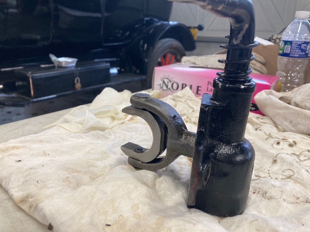

Thanks everyone for your input. Here are a couple visuals. Are there any unusual precautions I should take when removing the shift housing to look inside and clean? Springy things ready to fly out? Still in my first year of Model T ownership so I’m treading very softly here, don’t want to damage anything else.
I circled where the shifter was welded or more likely brazed. I know most of you have a more discerning eye than the general population, just wanted to enhance the visual aide and besides I like playing with my phone’s photo editing feature.

Post by speedytinc » Tue Feb 07, 2023 6:38 pm
The shiftlock unbolts as a unit. Nothing to fly off & get lost.
When you have it off you can manipulate it in a vise to check its function. Also move the internal locking sleeve with a screwdriver. It should engage/disengage easily with the correct lineup.
You might send a picture of the plunger & locking teeth area so we can access condition.

Post by 5 WoodenWheels » Sun Feb 12, 2023 8:28 pm
Brief update with visuals. The shift lock assy came off easily. The shift rod and fork appear to move as one with no slop or play.
I’m also able to slide what I call the shift collar or bushing back and forth on the axle. Still not going into direct drive, though.
Feel free to ask anything that might put more light on this situation and thank you everyone for

Slider movement looks ok. The shift collar teeth should be clear of the lock plate. The axle should be rotatable.
Check the plunger in the shift lock. It will be stiff, but movable. The shiftlock has been rebuilt or is new.
If the plunger body casting is original, you may have an oversized plunger locking up in its hole as I alluded to previously.

Thanks for the replies. Now that I’m on a more intimate basis with the Ruckstell, is there a way for me to manually get it out of underdrive? You know, in case I’m itching for a wild night on the town and want to go faster than 15 mph?
For those reading this far, you get another photo. I see there are two detents in what I’m calling the shift fork. Is it possible the wrong one is engaged? Does it matter? It looks like I may have to take apart that assembly but I’ll accept any reason you may give NOT to do that.
Gerrit
Posts: 6800
Re: Shifting the Ruckstell at a Standstill?
Post by Scott_Conger » Mon Feb 13, 2023 4:23 pm
at great risk of looking silly twice in a single thread, I'll say that there is no right or wrong detent position. Those detents are what keep the sliding gear slid over one way or another; in planetary mode or direct mode.
As clean and dry as things look, is it simply possible that the detent is partly seized in it's hole and making the shift extraordinarily difficult?
Kevin Pharis
Posts: 1656
First Name: Kevin
Last Name: Pharis
Location: Sacramento CA
Post by Kevin Pharis » Mon Feb 13, 2023 4:52 pm
Those detents are stout! You will need to clamp the shift fork or housing in a vice, and use a crescent wrench for leverage to toggle the throwout collar. If you can not get the collar to toggle over, ensure that the plunger is free by using a screwdriver to pry the plunger back
Posts: 5254
First Name: john
Last Name: karvaly
Location: orange, ca
Post by speedytinc » Mon Feb 13, 2023 5:27 pm
Using the hole in the plunger, try to pry it down into the hole.
The spring is stiff, but the plunger must retract to move to the next detent.
5 WoodenWheels
Posts: 178
Joined: Thu Feb 03, 2022 2:30 pm
First Name: Gerrit
Last Name: Marks
Location: Frederick, Maryland
Post by 5 WoodenWheels » Mon Feb 13, 2023 5:44 pm
Looks like I may have dragged a red herring through the discussion by mentioning “detents.”
Goal is still to disengage the Ruckstell. I welcome any thoughts on how to accomplish that. I’ll study the problem on my own as well.
BTW yes I cleaned the assy up to get a better look at parts I’m totally unfamiliar with but am getting to know better. That’s why it all looks so clean. I’ll reassemble with a good coating of grease.
Not loving the Ruckstell.
Gerrit
Posts: 5254
First Name: john
Last Name: karvaly
Post by speedytinc » Mon Feb 13, 2023 6:05 pm
That C shaped thing in the shift lock has 3 sharp teeth. The detents are the 2 valleys between the sharp teeth. It would be possible to put in a vise & shift to the other detent spot. However that doesnt solve the problem. You want to be able to use rux as needed.
Kevin Pharis
Posts: 1656
First Name: Kevin
Last Name: Pharis
Post by Kevin Pharis » Mon Feb 13, 2023 6:09 pm
You stated in an earlier post that your sliding gear moves approximately 3/4”. This sliding gear has 2 gear sections on the same shaft. The gear section you can see thru the shifter hole simply engages and disengages into a locking plate anchored into the housing by 2 conical tipped bolts and jam nuts. The inboard gear section rides inside the sun gear and bronze thrust plate. When the sliding gear is pushed inward toward the center section, the sliding gear connects the sun gear to the locking plate engaging the Ruxtell gear reduction. As you slide the sliding gear outward toward the wheel, the sliding gear will disengage from the locking plate, and the inner gear section will engage into both the sun gear and the bronze thrust plate, now in direct. If the sliding gear is over traveled toward the wheel, you will find that the inner gear segment will disengage from the sun gear leaving the rear axle in neutral. The shift tower holds the sliding gear in the proper location for each gear. Pretty sure the sliding gear only travels about 1/2” when shifting…
5 WoodenWheels
Posts: 178
First Name: Gerrit
Last Name: Marks
Post by 5 WoodenWheels » Mon Feb 13, 2023 6:23 pm
Thanks for the additional info. I’ll study the exploded diagrams and the parts I see in front of me and make some sense of all that. I’ll check back with any progress.
