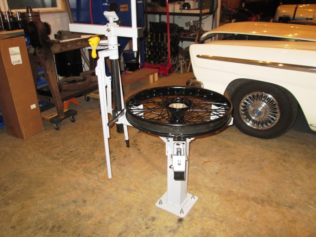

Posts: 5467
Re: I don't think Hank done it this a-way . . .
Post by RajoRacer » Fri Feb 10, 2023 11:17 am
OR - you can purchase one of these - has a bead breaker too !
