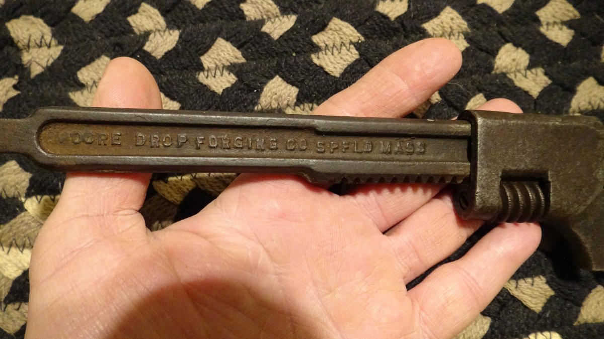

There are many styles but most will have Ford somewhere on them, Ford appears to be in the center of the top jaw of the one you found. I haven’t seen one like that I don’t think. Nice find though. On the attached picture you’ll see the wench on top of the Ford.

Those wrenches are good for a display, but not very good for using on the car. They tend to slip and round off the nuts or bolt heads.

what does the end of the handle fit in? I should know but I can't think of it

26-27 T and model A I believe, the square end is for the differential plug. Jim

Jim has it correct. The same tool with the square on the handle end, fits the 27 T differential plug, and the A model. Moore also made some of the earlier versions of this tool. The Ford script is found on many, and there were also other makers. Some had the T tool number cast in the handle or even on the fixed head of the handle. If your car is earlier than 1926, one without the square end is called for.

I was led to believe that wrench was upgraded and issued for the Model A Ford to adjust the service brake at each wheel.

I'm sure you meant wrench. Not all 26-27's used the new style filling plug.

I don't plan on using, at least not the wrench (spelling correct this time) part, but the plug end may come in handy.
