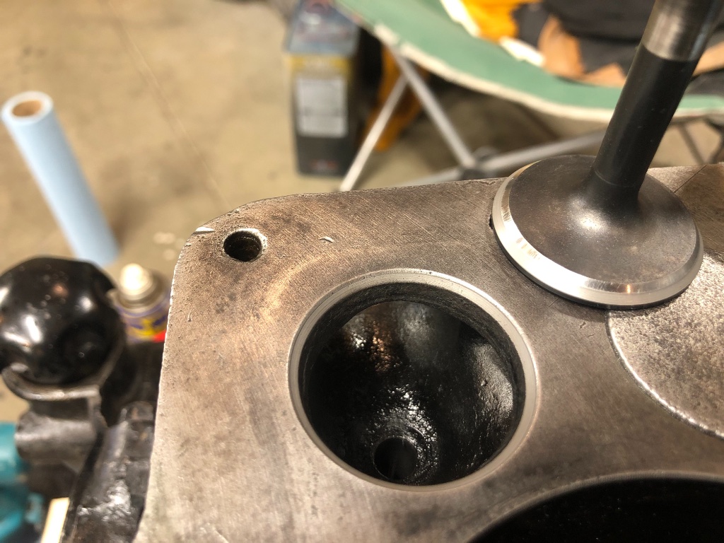

So I’m in the middle of a rebuild, it’s a 27 engine still original and ran, but puffed a bit of smoke when throttled. I’m currently restoring the car and am now focusing on the engine.
My plan/ budget is to just do a minimal rebuild right now as I want to try and salvage the cast iron pistons and it ran not too bad to begin with.
I am replacing the valves because it had the original two piece ones and understand they can be prone to failure.
I ordered new .015 oversized valves with the reamer and the green timesaver thinking I could just lap these in. I just started with the first valve to see how it goes and think I just ruined it by lapping too much? It took a long time and in the end left grooves.
Now I’m thinking cutting new seats is the way to go?
Didn’t really wasn’t to spend a bunch of money on cutters for a single job, anyone out there close to Saskatchewan Canada who has a set, I could bring block or willing to loan?
Or might it just be cheaper to take to a machine shop at this point? Problem with that is they are usually so busy it seems to take forever around my area to get any work done.

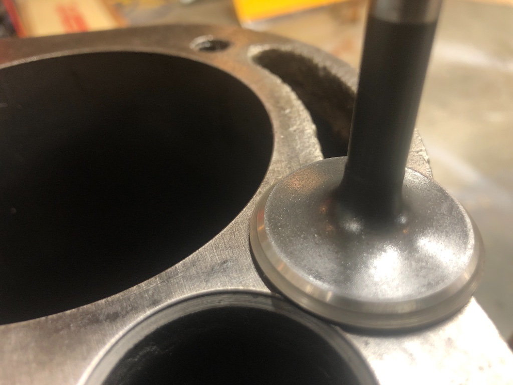

Are you saying that you now have a step between the lapped & un-lapped face of the valve?

No step, just very small grooves, or is that normal/ ok?

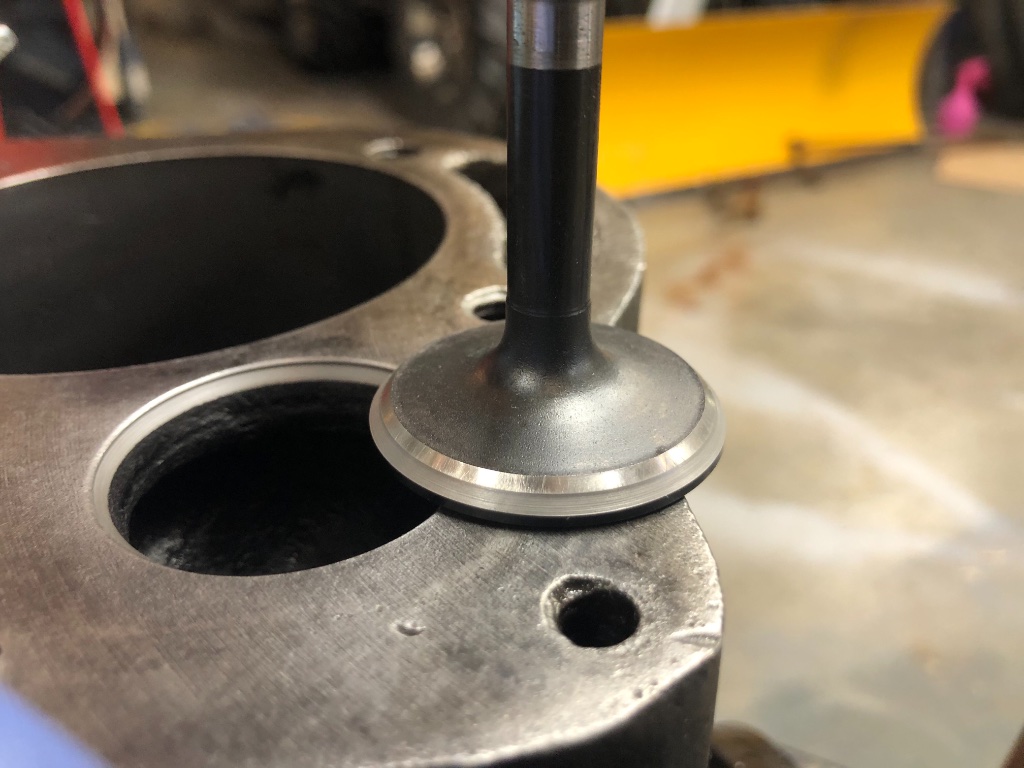

Trying to get a good photo. I read that in another post grooves from lapping are bad? Because when they heat up and expand the grooves won’t line up? Just trying to clarify what is acceptable.

I wouldn't worry about that. It won't be long before someone will mention that lapping should not be done and that the right way to do this is with an expensive cutter that produces a proper 3 angle valve seat. All of that is true. But, for what you're doing and with your budget, you'll be fine. You don't need to do extensive lapping. Just enough to confirm full 360 degree contact on the valve face and the seat is all you need to accomplish.

The valve is not ruined. For best results and lasting valve job, the seats would need ground or cut, the stems would need to be fitted correctly in the guides, new springs would be advisable, and the valve lash would need to be correctly set. The valve seat width is critical, and the valve seat should contact the center of the valve face. Little, if any, lapping would be required. It's also important that the valve lifters be a good fit in the block, and that the cam is in good shape. Getting all this right with no experience and no tools can be very difficult. The first thing to do is to obtain printed matter explaing the various steps and procedures and specifications and reading up. Then you can determine if you want to proceed with doing it yourself. It is entirely possible to do a good job with (specialized) hand tools, but it must be done right with the proper tools for good results that will last. The appearance of the lapped surface on the new valve is normal, but there should nmot be a "step" or ridge where the lapped surface meets the original surface of the valve face. Keep in mind that the cast iron valve seat in the block is softer than the new valve, and some blocks have had hard seat inserts added.

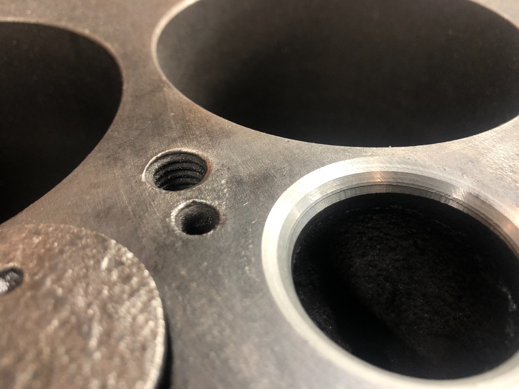

I dont like the lip in the block above the lapped section of the seat. During a valve job, a cutter or stone removes this sharp edge with a 30 degree cutter/stone. Its also the way to move the contact surface lower on the valve face. The seating surface should not be to the top edge of the valve.
The created pocket is the equivalent to removing cam lift that amount.
The grind rings you see indicate to me to coarse a compound. Do less with the coarse & follow with some fine lapping compound.

I would encourage you to do the job right. A good & proper valve job is important to your performance.

For the price of sending to a machine shop, you could buy yourself a set of Neway cutters. When you're done, you'll have a proper narrow seat and will own the tools forever. You will be one popular guy.
With very wide seats and low valve spring pressure, you spread the seat force over a much larger area and thus have way less seat pressure than was designed. A small piece of carbon stuck on the seat and bingo you have a burned valve/seat. With a proper narrow seat, you will more than likely chop the carbon up and that's that...just a small miss that goes away in a few seconds vs a miss that goes on for awhile and you induce wear that should have otherwise taken 10's of thousands of miles.
I realize you're on a budget, but at some point, investing in good tools doesn't cost, it pays.

I think they look good. Did you lap back and forth or in one constant circular motion? What grit lapping compound did you use? The best way is to use a fine compound and lapping back and forth with the suction type lapping tool? Using a course lapping compound will leave ridges. You can remove the ridges with a few back and forth laps with the fine 1200 grit lapping compound. Less lapping is best leaving a narrow seat. Jim Patrick

So I started with the timesaver Green (very fine) using a suction cup method, I was having trouble getting a grind 360 degrees around so I thought maybe needed a different compound, so I tried using the permatex valve grinding compound, and used that for a bit also made the mistake of trying to duct tape a drill to the other end of the lapping tool, it was a lot more coarse and did speed things up but realized that was a mistake after I noticed some grooving so went back to the timesaver by hand.
But it was hours to do the one valve and my arms are ready to fall off

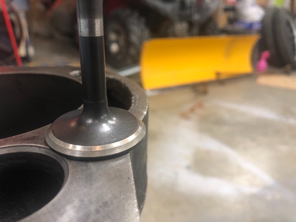

Just a thought. Looking at your second photo, it appears that the lapped area of the valve appears grey and the unlapped portion appears silver. If that is correct then your valve is seating deep into the block, grinding the seat will only make the valve seat deeper. Ideally you want the lapped surface on the valve to be in the middle of the valve edge, at least that is what I was always taught. The correct fix may involve installing seats in the block.

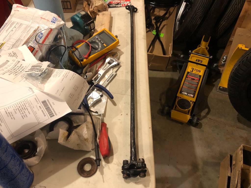

I’m going to straighten out the old drag link best I can then put the other salvage one I have beside it to measure, I’m hoping it will be the same, I can’t believe there are so many different lengths all of which are close to each other. None of the suppliers have replacement drag links listed for the 26-27?
- Posts: 8671
Re: Replacing valves - did I just ruin this valve
I have a '27 roadster that handles very nicely. I'll measure the drag link sometime today and post the result.
- Posts: 8671
The drag link on my '27 roadster measures 30 3/4 inches, caps off.
- Posts: 6818
I just reread to see that the drag link is bent...Unless it's kinked, there is no reason not to straighten a bent drag link and use it with confidence
Pizman
Topic author - Posts: 66
- Joined: Fri Aug 27, 2021 7:08 pm
- First Name: Brent
- Last Name: Pizzey
- Location: Warman SK
- Board Member Since: 2013
I measured the other one and it’s shorter, so I straighten the original one best I could. Thanks Txgoat for measuring yours, I confirmed mine is the same length.
- Posts: 6818
Take it to a friend with a little 12 ton press and take that last bend out of it (about 6" from foreground). Should barely take a tweek to get perfect and Should be just fine after that.
- Posts: 4485
Did you mean 1/2 ton?Scott_Conger wrote: ↑Thu Mar 09, 2023 8:35 pmTake it to a friend with a little 12 ton press and take that last bend out of it (about 6" from foreground). Should barely take a tweek to get perfect and Should be just fine after that.
- Posts: 6818
Not really.
a 12 ton press is a pretty standard, almost Hobby-type press commonly found pretty much everywhere (I've never seen a 1/2 ton press). Apply as much pressure as needed with the part thoughtfully supported and guarded (it won't be much pressure in the grand scheme of things).
my point being that it is an easy job that can be controlled and tweaked in a small press as opposed to mounting it in a vice, dropping an 8' pipe over it and yanking.
My own press was bought from a hobbyist who "had it 20 years and never used it even once". I use it constantly. As purchased, it was more of a big rubber band than a press as it did more stretching than squishing. I've upgraded it and improved it so much over the years that it's like my grandpa's original axe...replaced the head twice and handle 3 times, but it's still grandpa's axe.

Great video Flivver! Where does a guy go to get those valves and keepers you used in Canada? How does the valve stem length compare to the model T ones?
I cut my seats but am wondering if I too should have used larger head valves as some of these sit fairly low in the block.

Thanks Scott, great idea, my friend has a shop press like you speak of, I’ll take it to him and see if we can get the last bends out.Scott_Conger wrote: ↑Fri Mar 10, 2023 9:50 amNot really.
My own press was bought from a hobbyist who "had it 20 years and never used it even once". I use it constantly. As purchased, it was more of a big rubber band than a press as it did more stretching than squishing. I've upgraded it and improved it so much over the years that it's like my grandpa's original axe...replaced the head twice and handle 3 times, but it's still grandpa's axe.![]()

You will find that you have to "over bend" a little for it to rebound to straight. Keep at it...don't go crazy, and it will be very straight when you're done.

The part numbers are given in the video. With those, you can find everything at an autoparts store and/or tractor parts store. I ordered the valves online at Rockauto I think, and the keepers were from my local tractor dealer.
The valve length was just right for adjustable lifters - I did not grind them down at all.
Pizman wrote: ↑Sun Mar 12, 2023 9:21 amGreat video Flivver! Where does a guy go to get those valves and keepers you used in Canada? How does the valve stem length compare to the model T ones?
