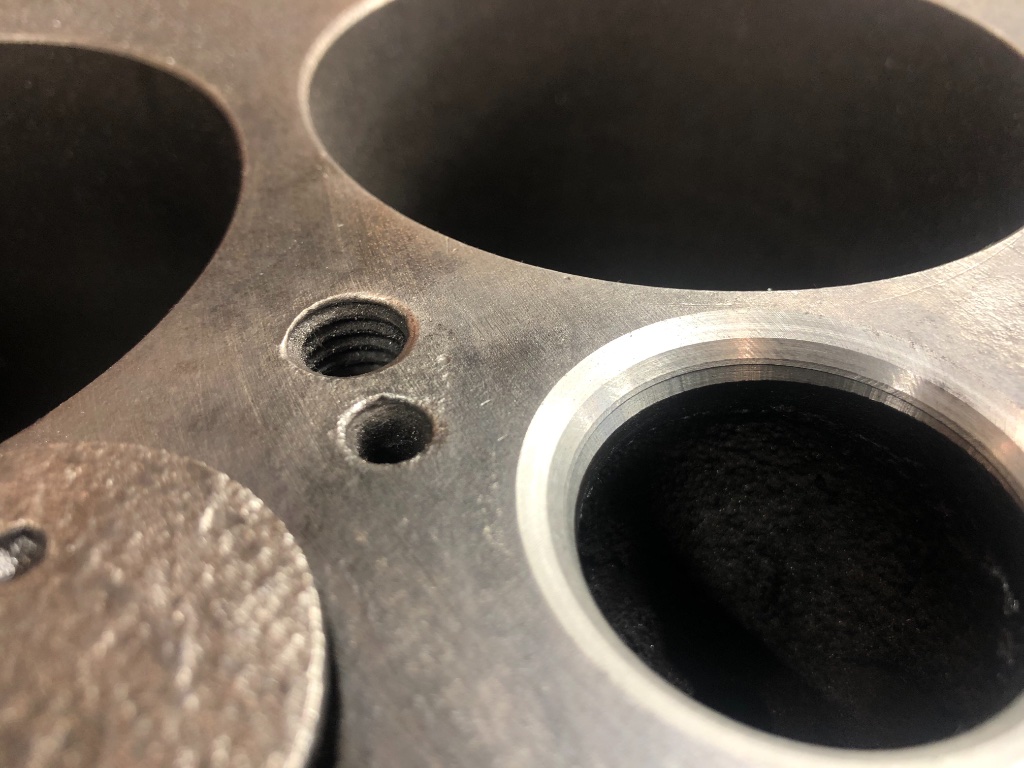

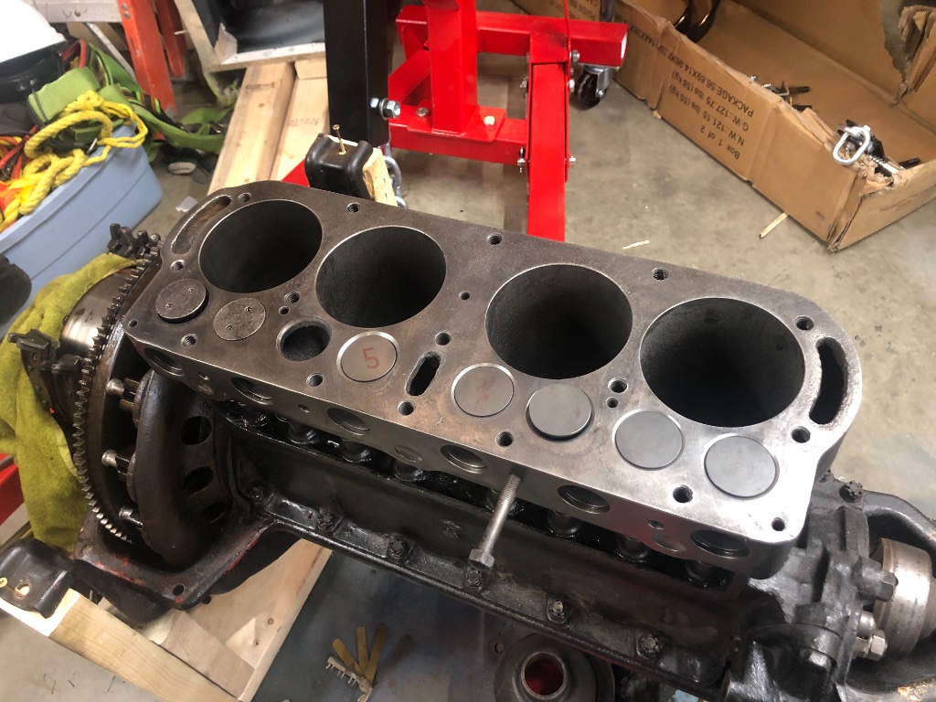

So I’m in the middle of a rebuild, it’s a 27 engine still original and ran, but puffed a bit of smoke when throttled. I’m currently restoring the car and am now focusing on the engine.
My plan/ budget is to just do a minimal rebuild right now as I want to try and salvage the cast iron pistons and it ran not too bad to begin with.
I am replacing the valves because it had the original two piece ones and understand they can be prone to failure.
I ordered new .015 oversized valves with the reamer and the green timesaver thinking I could just lap these in. I just started with the first valve to see how it goes and think I just ruined it by lapping too much? It took a long time and in the end left grooves.
Now I’m thinking cutting new seats is the way to go?
Didn’t really wasn’t to spend a bunch of money on cutters for a single job, anyone out there close to Saskatchewan Canada who has a set, I could bring block or willing to loan?
Or might it just be cheaper to take to a machine shop at this point? Problem with that is they are usually so busy it seems to take forever around my area to get any work done.

Are you saying that you now have a step between the lapped & un-lapped face of the valve?

No step, just very small grooves, or is that normal/ ok?

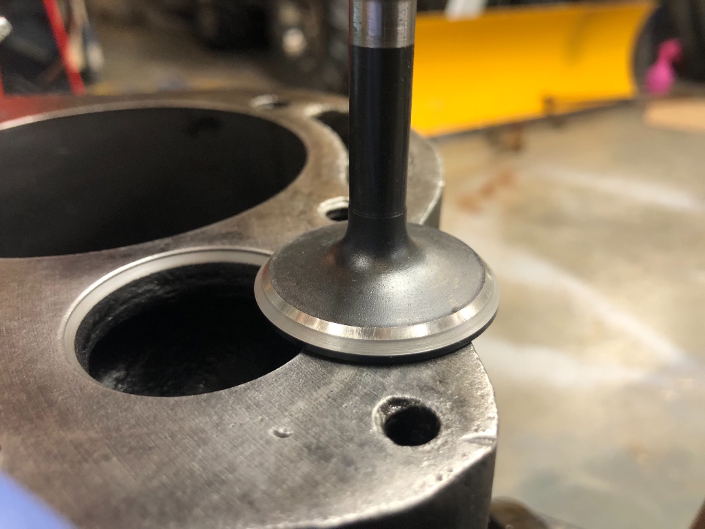

Trying to get a good photo. I read that in another post grooves from lapping are bad? Because when they heat up and expand the grooves won’t line up? Just trying to clarify what is acceptable.

I wouldn't worry about that. It won't be long before someone will mention that lapping should not be done and that the right way to do this is with an expensive cutter that produces a proper 3 angle valve seat. All of that is true. But, for what you're doing and with your budget, you'll be fine. You don't need to do extensive lapping. Just enough to confirm full 360 degree contact on the valve face and the seat is all you need to accomplish.
Posts: 8694
Re: Replacing valves - did I just ruin this valve
Post by TXGOAT2 » Sun Feb 26, 2023 6:54 pm
The valve is not ruined. For best results and lasting valve job, the seats would need ground or cut, the stems would need to be fitted correctly in the guides, new springs would be advisable, and the valve lash would need to be correctly set. The valve seat width is critical, and the valve seat should contact the center of the valve face. Little, if any, lapping would be required. It's also important that the valve lifters be a good fit in the block, and that the cam is in good shape. Getting all this right with no experience and no tools can be very difficult. The first thing to do is to obtain printed matter explaing the various steps and procedures and specifications and reading up. Then you can determine if you want to proceed with doing it yourself. It is entirely possible to do a good job with (specialized) hand tools, but it must be done right with the proper tools for good results that will last. The appearance of the lapped surface on the new valve is normal, but there should nmot be a "step" or ridge where the lapped surface meets the original surface of the valve face. Keep in mind that the cast iron valve seat in the block is softer than the new valve, and some blocks have had hard seat inserts added.
Posts: 8694
Post by TXGOAT2 » Sun Feb 26, 2023 6:56 pm
People used to hand-lap cast iron valves to cast iron seats. Done correctly, it can give a good result. However, grinding valves used to be considered periodic maintenence. A proper valve job with modern valves will last for tens of thousands of miles.

I dont like the lip in the block above the lapped section of the seat. During a valve job, a cutter or stone removes this sharp edge with a 30 degree cutter/stone. Its also the way to move the contact surface lower on the valve face. The seating surface should not be to the top edge of the valve.
The created pocket is the equivalent to removing cam lift that amount.
The grind rings you see indicate to me to coarse a compound. Do less with the coarse & follow with some fine lapping compound.

I think they look good. Did you lap back and forth or in one constant circular motion? What grit lapping compound did you use? The best way is to use a fine compound and lapping back and forth with the suction type lapping tool? Using a course lapping compound will leave ridges. You can remove the ridges with a few back and forth laps with the fine 1200 grit lapping compound. Less lapping is best leaving a narrow seat. Jim Patrick

So I started with the timesaver Green (very fine) using a suction cup method, I was having trouble getting a grind 360 degrees around so I thought maybe needed a different compound, so I tried using the permatex valve grinding compound, and used that for a bit also made the mistake of trying to duct tape a drill to the other end of the lapping tool, it was a lot more coarse and did speed things up but realized that was a mistake after I noticed some grooving so went back to the timesaver by hand.
But it was hours to do the one valve and my arms are ready to fall off😬

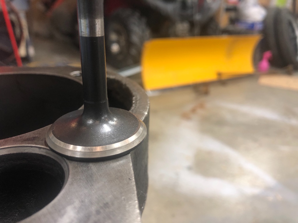

Just a thought. Looking at your second photo, it appears that the lapped area of the valve appears grey and the unlapped portion appears silver. If that is correct then your valve is seating deep into the block, grinding the seat will only make the valve seat deeper. Ideally you want the lapped surface on the valve to be in the middle of the valve edge, at least that is what I was always taught. The correct fix may involve installing seats in the block.
Hope this helps,
