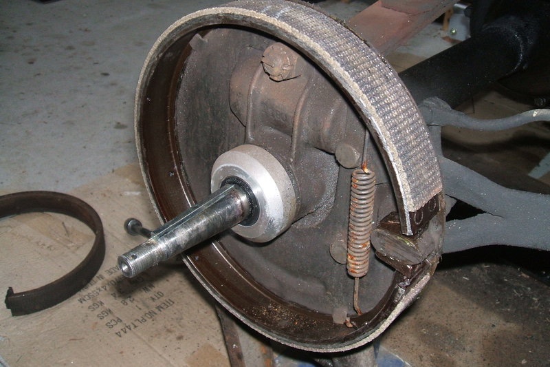

This is driving me nuts and I cant figure it out, so I built a rear axle from parts and when I put on my right rear hub without the brake band on I can here something dragging on the brake drum, it least it sounds like it's dragging on the drum, I can't figure what the hell it is.
Without the hubs on I and rotate the axles and I don't here it, with the hub on I hear it, I put a feeler gauge between the brake drum and backing plate all the way around and there is no interference, I put some putty on the dust cap that holds the felt washer to the end of the axle tube and put on the hub, when I take the hub off and the putty shows I have 1/16" to 1/8" clearance, drum is not touching the brake cam.
What is making this noise that sounds like something is dragging on the brake drum, not a metallic sound more like the drum is dragging on a thick piece of paper, doesn't happen on the left side, I've tried both drums, same result.

I don't know what's dragging, but I do know what's missing: if you have a gap between the inside of the hub and the dustcap, it is because you are missing the felt seal which seats on the hub and presses against the outside of the dust cap (what is pictured in this link is a standard wood spoke hub, but your hub has the same recess): http://www.mtfca.com/discus/messages/82 ... 1541005897

On a 1926-27 T rear axel it is the backing plate clips and the brake band return spring that keeps the brake band centered. With the brake ban removed and if the brake rod is not connected then the brake cam can rotate so that the lobe end of the brake cam is hitting the brake drum. Try connecting up the brake rod and put the hand brake lever all the way released forward with out the brake band in side. Do you still hear the noise when rotating the wheel ? If yes then your brake rod lenght needs adjustment, if no then the noise was the brake cam lobe hitting the drum.

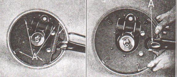

There are 4 brake shoe clips (A in the left picture) that are riveted to the round backing plate that holds the brake shoe centered and against the backing plate. It is common for the curved portion that holds the shoe in place, to wear through until they break, leaving nothing to hold the brake shoe in place, allowing the brake shoe to drop and rub against the brake drum. That may be your problem. I have attached a photo of one of the clips. These are sold by Snyder’s, Part # T-2560-CL. Size-wise, they are only about 1” long x 1/2” wide. When I restored my rear end, all four of my clips were broken so I bought new ones and riveted each one in place with 2 pop rivets. Jim Patrick

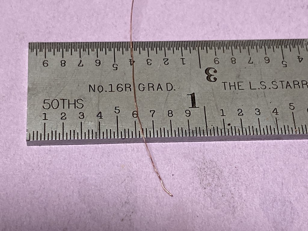

Well I've had the hub on and off a half dozen times to try and nail down the noise then I found this little piece of copper wire stuck in the paint hanging off the edge of the backing plate, didn't think anything of it and pulled it off but the next time I put the hub on the noise was gone. I cant believe it was this wire, I've tried to reproduce the sound with that wire but its just to damn small, all I know for sure is the sound is gone now.
