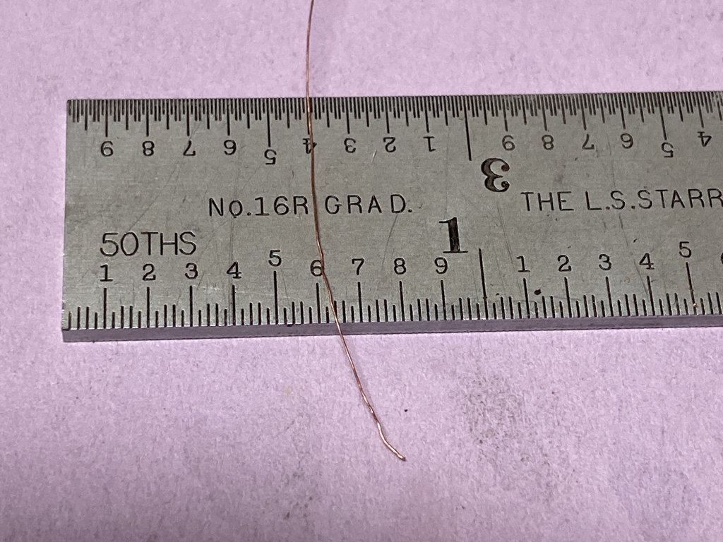

Well I've had the hub on and off a half dozen times to try and nail down the noise then I found this little piece of copper wire stuck in the paint hanging off the edge of the backing plate, didn't think anything of it and pulled it off but the next time I put the hub on the noise was gone. I cant believe it was this wire, I've tried to reproduce the sound with that wire but its just to damn small, all I know for sure is the sound is gone now.
Thanks all for the advice
