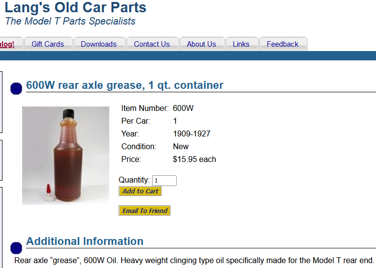

Post by TRDxB2 » Fri Mar 17, 2023 4:07 pm
One of the most frequently asked questions with multiple responses. You likely to get confused - oil vs grease and related viscosity
Just buy this https://www.modeltford.com/item/600W.aspx

Post by TWrenn » Sat Mar 18, 2023 10:33 am
I agree. Another area that's way over-thunk! It's made specifically for this purpose, I use it with no issues. I keep a bottle on hand for the infrequen "top-offs".
