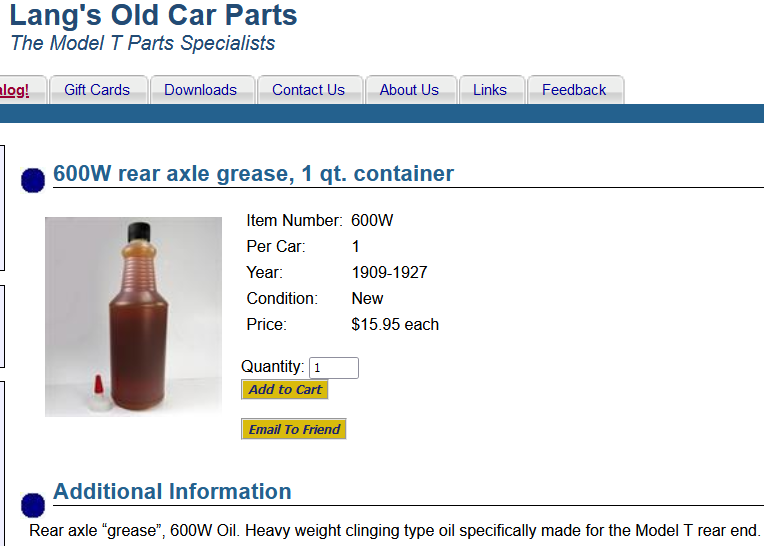

One of the most frequently asked questions with multiple responses. You likely to get confused - oil vs grease and related viscosity
Just buy this https://www.modeltford.com/item/600W.aspx
Posts: 4684
Re: Just curious, what is Fluid Grease in differential
Post by Norman Kling » Fri Mar 17, 2023 4:34 pm
On a standard differential use 600W but if you have Ruckstell use sae90. On the early cars the fluid should be 1 1/2 inches below the oil hole but on your 1927 the oil filler hole is lower and it should be filled just till it reaches the oil hole.

I do use 600W oil, I am not trying to find out what to use I am just curious what "Fluid Grease" was back in 1927
I agree. Another area that's way over-thunk! It's made specifically for this purpose, I use it with no issues. I keep a bottle on hand for the infrequen "top-offs".
