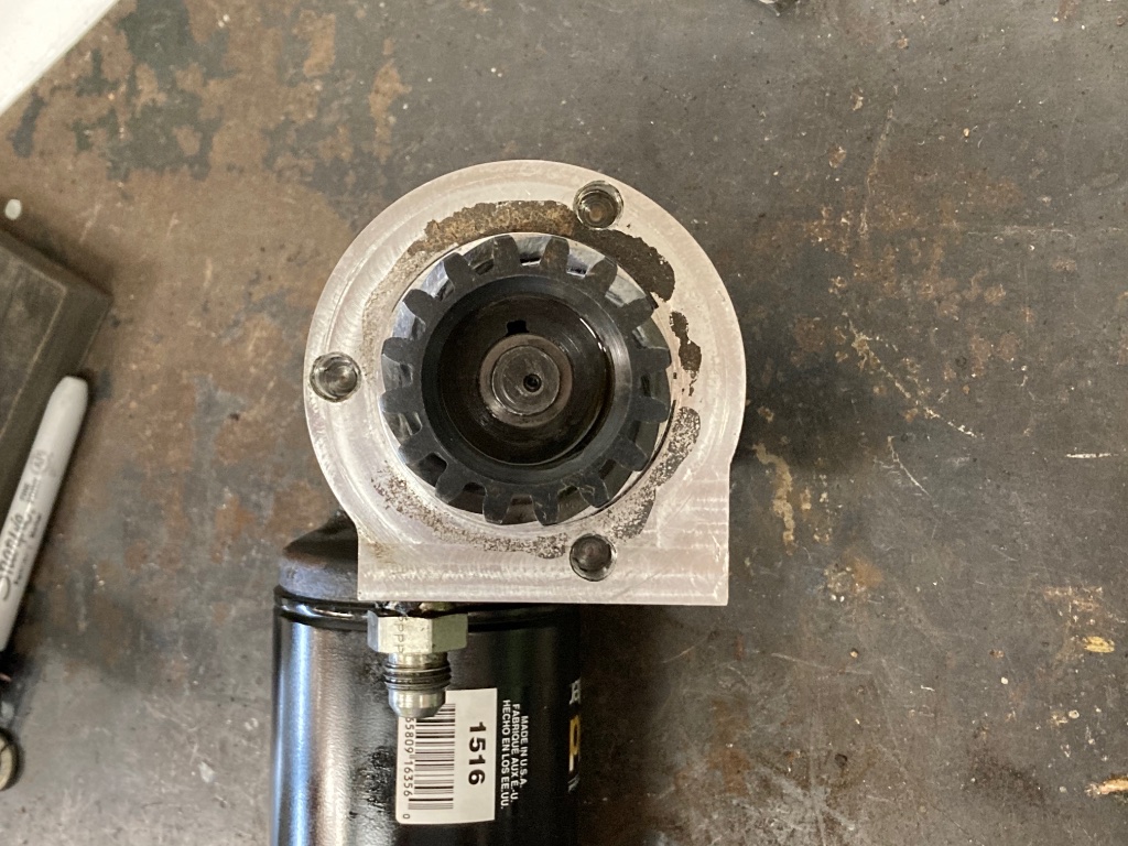

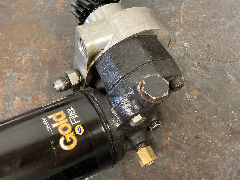

I just took mine off my speedster engine to install my alternator/oil pump drive… but my dad quickly claimed it for himself.
I do suggest seeking out an iron Melling pump rather than the lower precision aluminum alternatives. The iron pump I removed had very little noticeable wear after 10+ years. I am happy to make up a sketch of the adapter I removed if this helps

Here a quick look at what I made all those years ago…
Rough material dimension is 3.5” x 3.5” x 2.0”. Could probably take an inch off the length as the “snout” isn’t necessary. When I made this, I wanted to add a ball bearing to take the radial gear load but never did. After all these years the pump is in good shape, so bearing not needed. A simple register into the generator bracket will do
