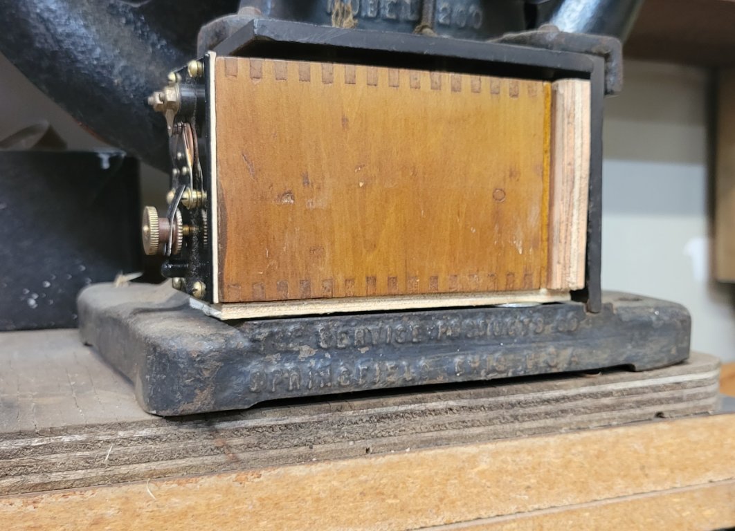

Norman, I have four HCCTs and those coils don't work in them at all, due to the size difference.

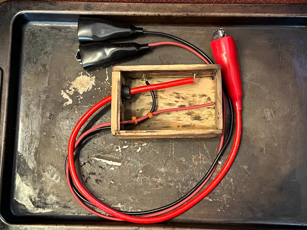

I haven't tried it, but it looks like it would be easy to make a box to insert the coils you have and connect to the tester. maybe someone on the forum can help you. You might try Ron Patterson.

Norm and James . . I happen to have a connector that I believe will match up with a Heinz coil, all you need is to match the coil against the connector and attach wires to your tester and you're welcome to it. Just email me and I'll send it out to you.

Looking at this adapter, I don't believe it will correspond with the coil box contacts on a Heinze coil. This adapter was for the what I would call the early first series KW coil. That early KW had terminals spaced differently than the KW standard that came out a few months later. ,....... I am certain that Mike Kossor will be helpful with your Heinz coil calibrations

Could be the capacitor is bad or the wrong value. An adapter can be made to test Heinze coils using the ECCT but the test limits will be different. That's why the reason the Heinze Edition ECCT was made. Engine performance reported by Heinze coils users tuned on the ECCT have been excellent. The Heinze coil is really an excellent design.

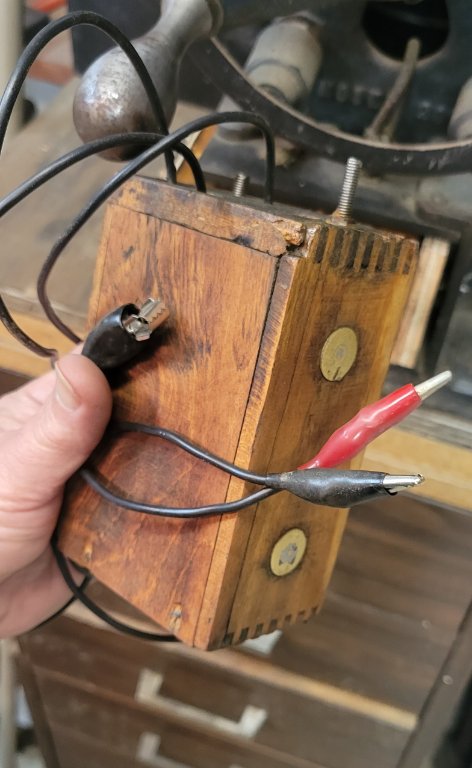

It should be simple enough to make an adapter box to hold, test, and adjust the early coils on an HCCT or even one of the modern electronic test/adjusters. Leftover wooden pieces from coils beyond repair (anybody here have less than a half a dozen of those?) To make the dummy box and connections to fit into the HCCT's. A simple box made of scrap wood pieces to make a test cradle for the odd coil. Be careful with the wiring! Significant spacing MUST be maintained between the low and high voltage wires! And some spacing and fairly short wires should be for the primary and secondary wires.

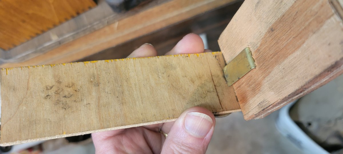

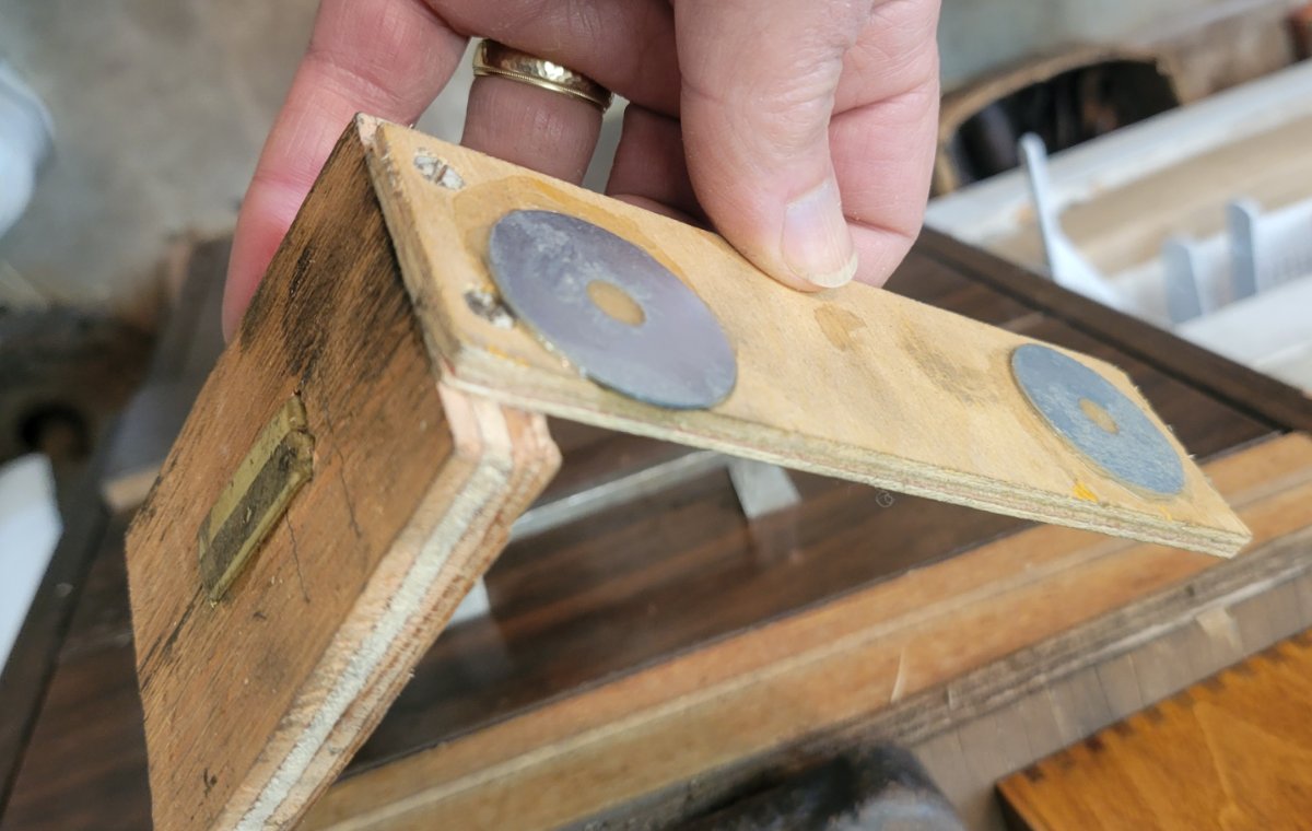

I made this remote coil adapter for my HCCT.
Now I can make any form of coil fixture and connect to the coil.
I then use the HCCT to test and adjust the parameters of the coil.

Re: Old Style Coils VS New Style Coils
Bob, I made one if those, too!
I also made an adapter for Heinze coils for the HCCT.
Keith
Keith
