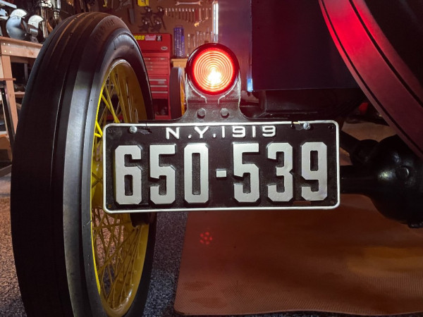

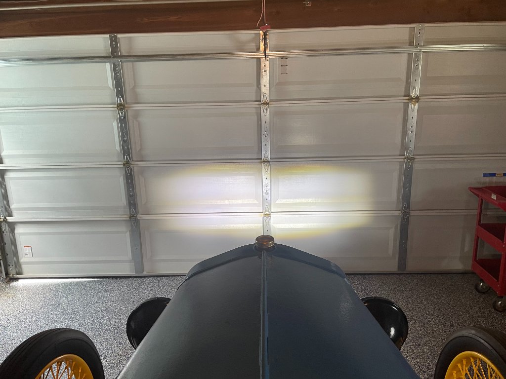

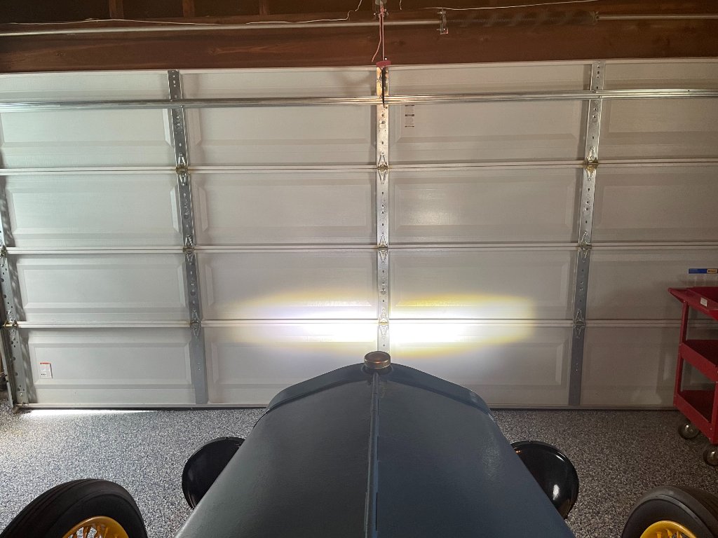

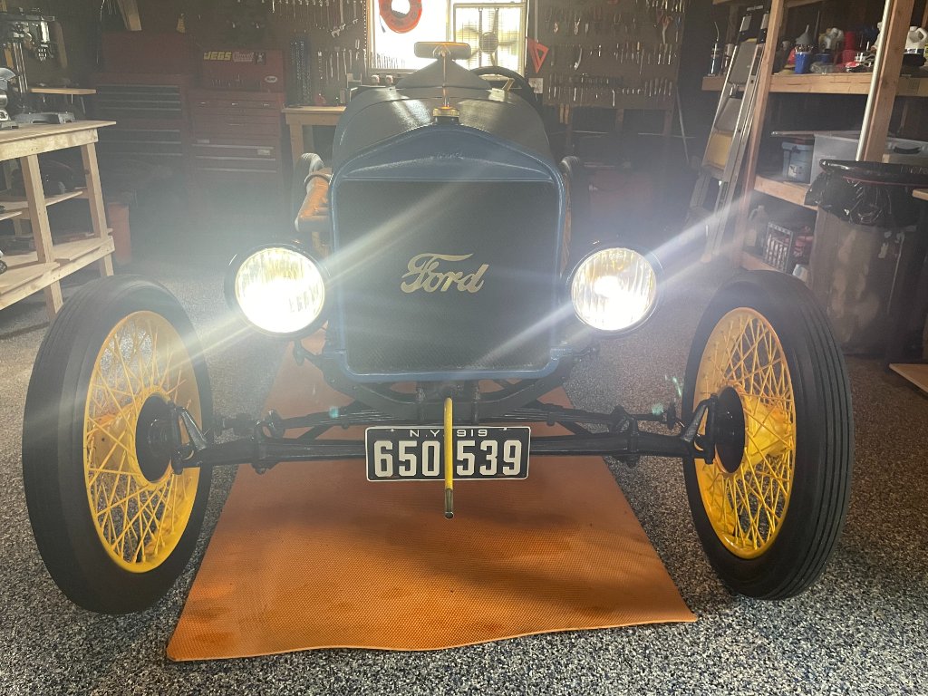

I'm running them on my 1919 racer; both headlights and the tailight. Put them in last August. All good.
Here's a link to the ones I got. A little pricey, but I like being seen when necessary:
https://www.logolites.com/products/led- ... eadlights/
