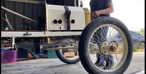

Home from Deans. Now to try sorting….
First start back home:
https://www.dropbox.com/s/c7v8oaj5q8l5h ... 3.mov?dl=0
And a quick test drive. It’s a little too fast on loose gravel to film and drive:
https://www.dropbox.com/s/004qaj3qs1jr9 ... 3.mov?dl=0

Re: Getting the 1910 racer on the road
Thanks Rob. It certainly made my day brighter.

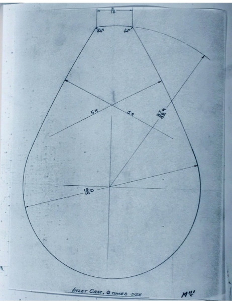

Considering your rough idle makes me wonder what cam do you have in this, or how much lift compared to other cams, like 270, 280, 310, etc.? Just wondering...

Not sure on cam/valve timing? I wish I had paid more attention when it was out. I have one intake lobe drawing:
Kieth,

so if I did my math correct in my brain it has .375 lift , that's a lot of cam compared to a stock T at .250

.375 valve lift, minus valve clearance.
I would call that a radical cam.

Scott,
That may help explain the problems getting it to idle and run smooth at lower rpm. Under load the motor seems to “reach down” and pull through. When I shift in the 2nd video it’s running rough, but pulls through without a miss when I shift to high, even though I don’t change the throttle (because I was holding the camera with my right hand).
One thing about it, it accelerates like a Chebby small block.

On another note, I checked the Model K drawings, and the K motor has the same cam lift as a Model T, .250, if my math is right…
