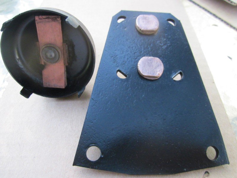

If you only jumped across the posts on the switch & nothing. Did you try check the wiring from the switch to the starter or even tried to jump directly to the starter?
Doubt if its the switch based on jumping across the posts and getting a spark
Repo starter switches are similar to the original switches . Repro switches need to be positioned correctly or else they will eventually fail
One style --
Another style repro switch that can fail when the plunger is to high above the floor board
One style --

Another good point made about the foot starter button. It can happen that the button gets cockeyed and not go straight down and not make contact. The repos will sometimes do that and cause headaches.
Hopefully the switch is the problem but if not it’s the starting point to figure out the issue.
