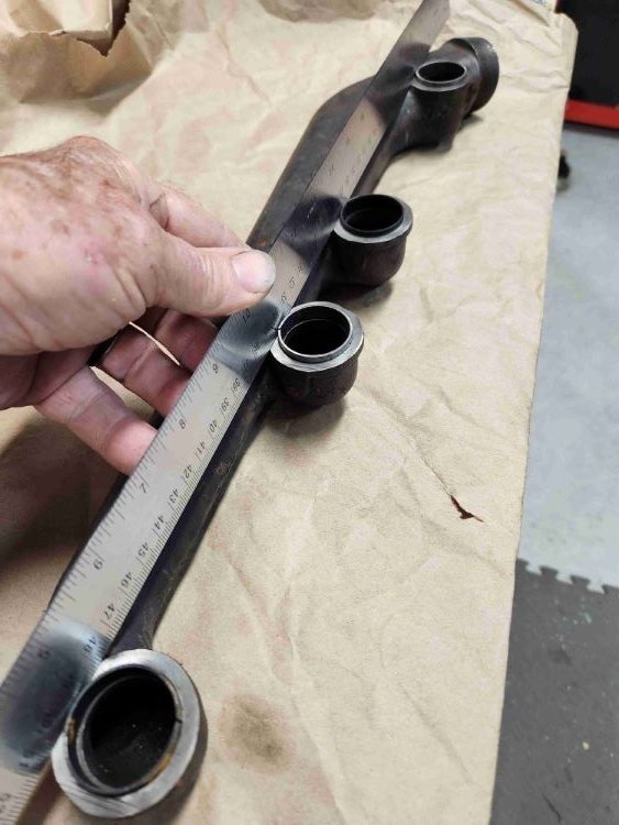

Until you tell us that the manifold is perfectly straight, or define how "un-straight" it is, meaningful advice is impossible.
And after you know your manifold is warped (because the probability is in the 99% range) you will find that a new manifold is one of the best investments you'll ever make.

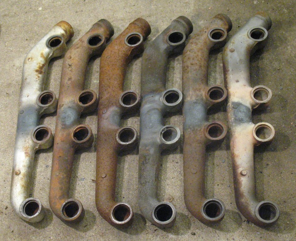

Old manifolds are very often warped, and sealing surfaces may be eroded or corroded.
It's my opinion that old cast iron that has been subjected to high heat stress for many hours over many years loses some of its vital properties, making it difficult to repair and less likley to give good service if it is repaired.
I'd replace the manifold with a new one, using the best gasket arrangement available, and be done with it. Manifold assemblies are best tightened in stages, evenly, and re-tightened after a few operating cycles.
When assembling the exhaust pipe to the manifold, you may encounter misalignment.
I'd try to get the pipe to line up with the manifold reasonabley well, and try to have some clearance between the pipe and the hogshead when the brass nut is tightened up. Applying powdered graphite or Neverseize to the large brass nut and the manifold outlet threads may help get it tight. It won't stand extreme tightening.

Martin, you missed option 5!
Using split gland rings is fraught. they have a nasty habit of mal- forming on fitting, and assuming interesting shapes when fitted and subject to heat cycles. If you use individual copper rings, it is better to cut some solid gland rings from suitable sized exhaust tubing. These can even have a small taper filed in them to aid fitting a slightly bent manifold.
Scott mentioned that it is pointless if your manifold is less than straight, and must used manifolds are bent. Check it with a straight edge. It is critical that the four holes are in line, not across the faces, but from top to bottom.
My option 5 is the set of 6 one piece heavy copper rings the vendors sell. These are reuseable. They are thick enough that a small taper can be filed on one side to aid in fitting. Fitted with a muffler sealant to fill rust pits/heat erosion, these work really well.
I have a different rick to compensate for a bent manifold. Email me if you like.

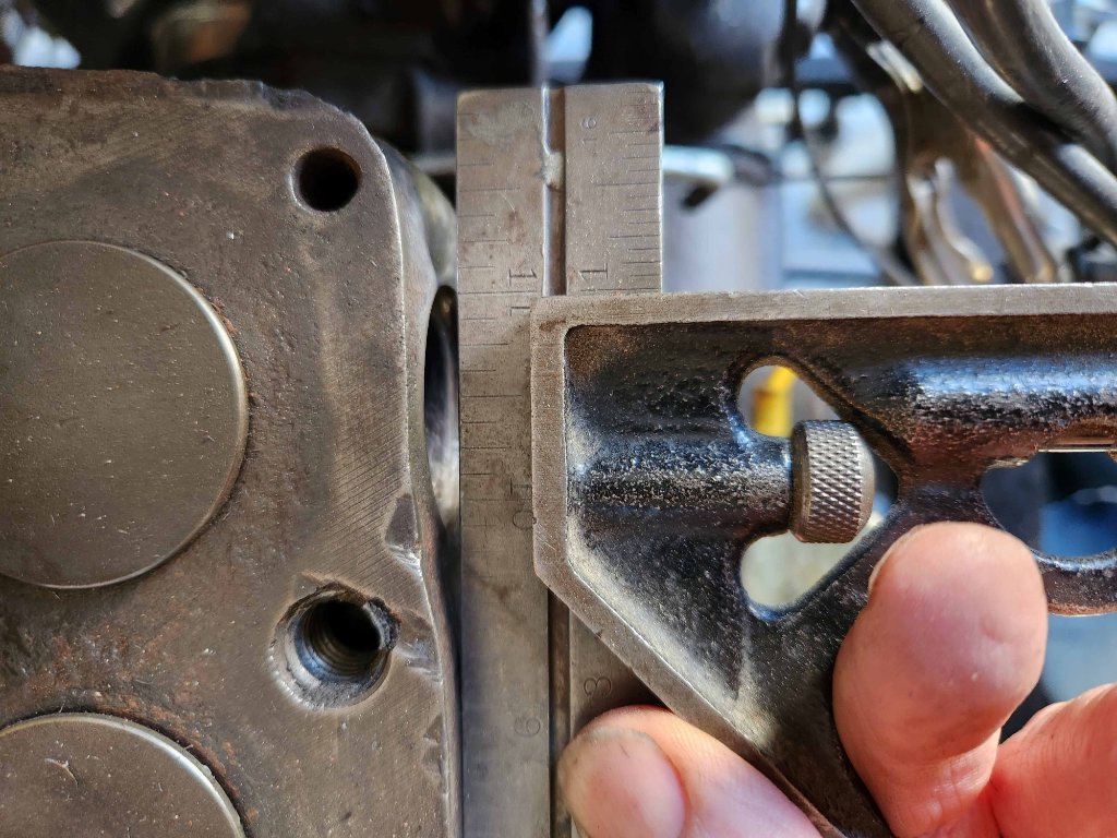

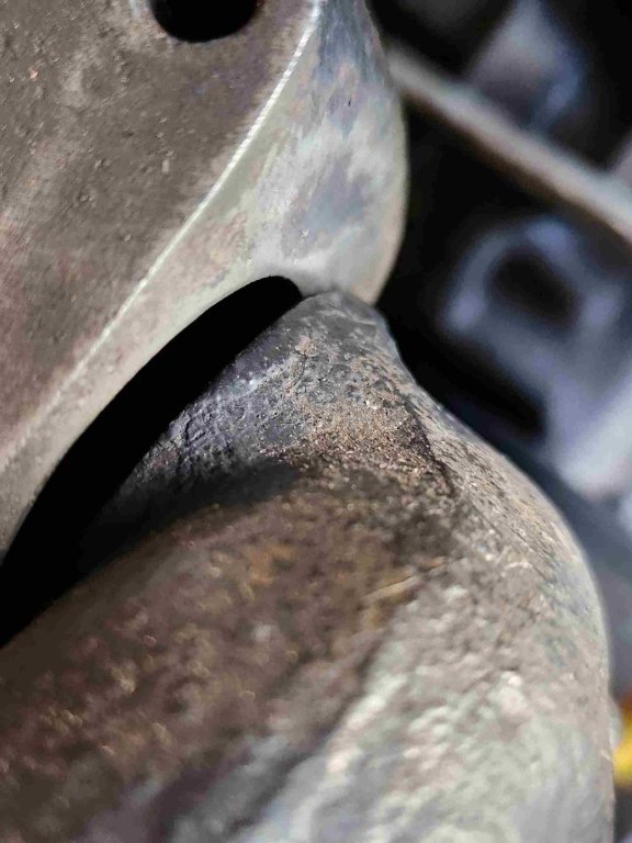

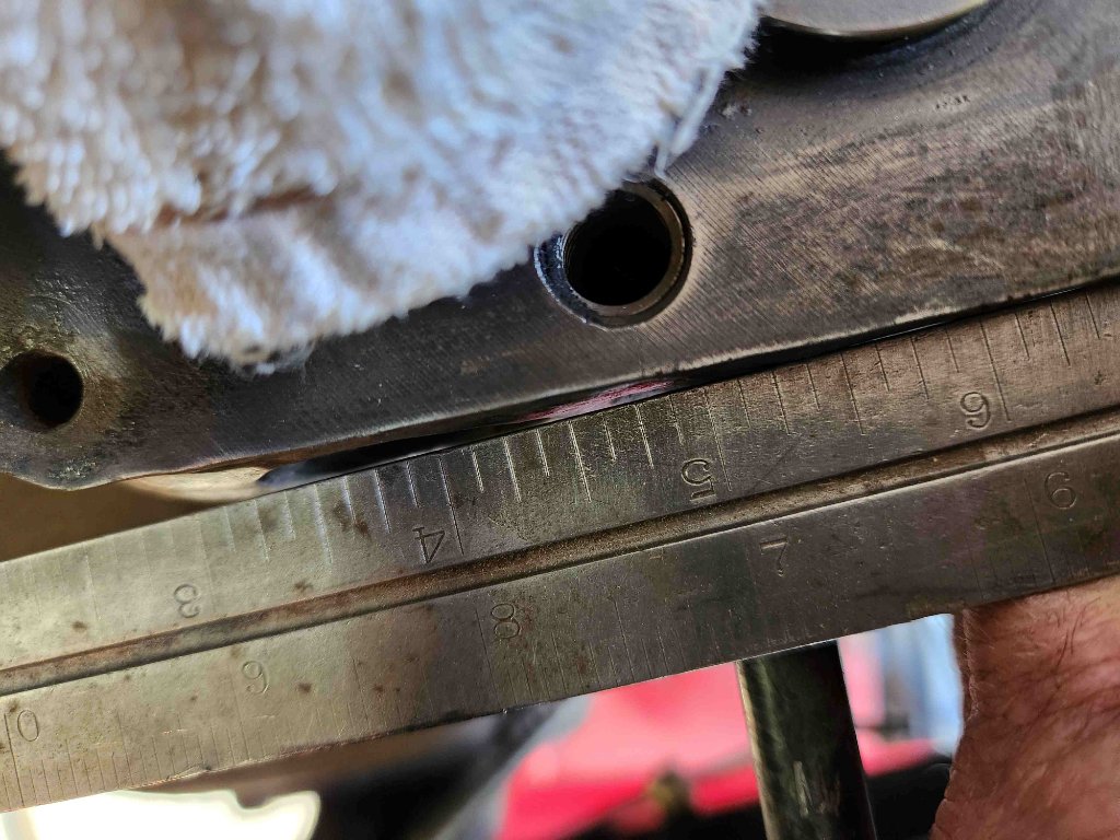

Thank you one and all for the great advice. Its all very helpful and much appreciated. I couldn't get this far without this form...
Regrettably, not great news with today's update.

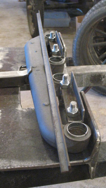

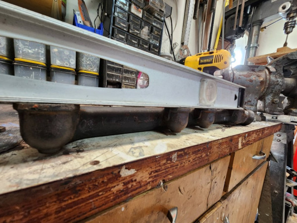

On the manifold; I placed a straight edge on the surfaces and all appears aligned (???)

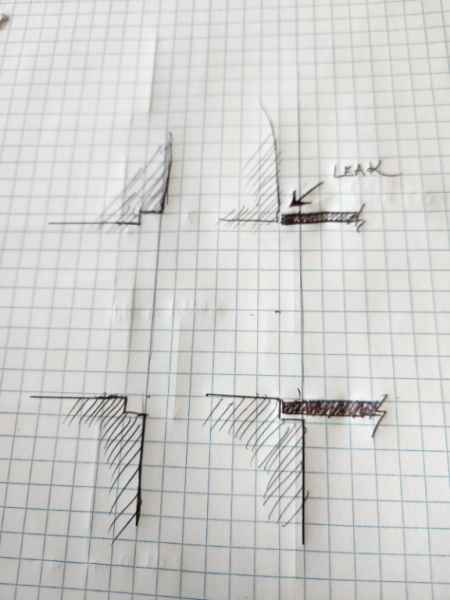

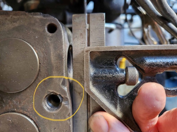

On the bad side - I also placed a straight edge on the block and it is far from straight.

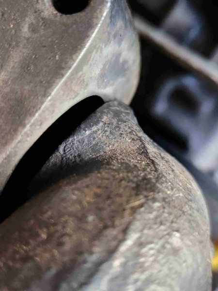

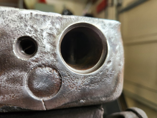

It almost looks like someone ground down the the No. 1 port area ??? (See photos) - No. 4 end is also a bit off plane ...
the strange thing is the counter bored recess for the ring seems equal - hard to imagine a block warping???
Anyone ever seen anything like this?
I suppose I can close the gap with one of the gasket / gland options (including the exhaust pipe cut to size idea... with copper rings...
In the process I could try heating up the manifold (possibly with my welding torch?) and torque to max - and hope for the best.
The last option would be extreme - with milling the block face flat ---
At one point it was working - till I dinked with it ...
Marty

I don't think the block is warped. It may have been cracked and welded, then ground down with a hand grinder by someone who didn't realize the gasket face must be flat.
No telling, with something that old.
I'd want another block. There are still some good ones around. I'd expect that one to give trouble, in one way or another, for as long as you had patience to mess with it.

With the block in that condition, I don’t think a new manifold will help. This may seem crazy, but what about grind some on the block— maybe an eight and the rest on the manifold, to where it fits. OR maybe bolt the manifold up, heat that baby red hot and gently pull it in. When I was a kid, I’d retard the spark and light cigarettes, getting dull red never seemed to hurt the manifold. Just a thought.

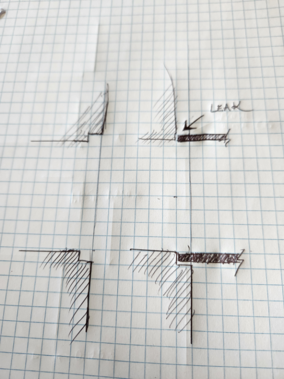

I assume this is your 1922 touring. I see two possible solutions. 1 make a special shim to fill the gap on #1 (you can forget about bending a manifold to fit); 2 get a block that hasn't been boogered up. 1922 was a very busy model year and Ford made lots of engines. It should not be hard to find a good 1922 block.

I like the idea of a spacer. Could be as simple as a taller ring/tube & 2 copper rings stacked.
Not convinced the manifold is in alignment in the plane of the holes with the pictures provided.

This maybe the best place for the solid copper T-3036-cr to be used! Most manifolds are straight that dirrection it's the port alignement that give
the problem. Worped manifolds can be straightened so I don't see why one can not bend one to fit? Before grinding down a block I would think if
that's the dirrection you go I would grind the manifold, it's easyer to find than a block if it dosn't work out. Do you have access to a junk block?
You could clamp the manifold to a junk block with some paper gaskets ( they are cheep) on the three holes that are OK then heat the manifold
& pull with a C clamp in the cylinder. Always heat first never try to put pressure on a cold manofold it will break! High temp. silicone may cover
any small leaks. Try small Dia. rope packing for the pipe. Good luck.

I doubt that there's enough stock left in that block to grind it flat.
That thing may have been dragged behind a wagon for a downhill brake or used in a weight box on some kind of plow. Or else maybe it laid in a mudhole for 60 years or so, and had pits 1/4" deep in the gasket face, and someone ground them out. No telling, really.
I wouldn't spend any money or any more time than you're willing to waste on it.

- Posts: 7287
Re: Exhaust gasket recommendations ?
Martin, you have missed my point. The spirit level shows that the manifold is reasonably straight across the ports, but that is not what causes the problem with a bent manifold. With repeated heat cycles/no gland rings/poor gaskets etc, the manifolds tend to march up and down on the block face, so the four ports no longer line up with the ports on the block. You need to check this line-up by putting the straight edge along the top of the ports. In most cases, the rear port has dropped somewhat. This makes fitting the manifold and gland rings very difficult, so much so that a simple flat gasket is often fitted between the block and manifold. This is a temporary fix at best. Without gland rings the manifold is now free to wander about as the heat cycles dictate. The only thing holding the manifold in place is the clamping force of the four studs and the clamps.
Hope this helps.
Hope this helps.

Hi Alan. Thanks. I neglected to point out that all the ports do all align well with the block... fitting it together has not been a problem. I have put it all together twice. First , with the split steel rings and a flat copper gasket .. then with the one piece copper rings. Thecproblem is a leak at no. 1. Exhaust port. Please see the previous images.. the gap between the manifold and block is too much because the block face is not flat.
Once parts come in I'll update all.. at this point I'm feeling positive about it thanks to everyone's help.
- Posts: 7411
Here's what Allan is describing. Note how #1 and #4 are out of alignment with #2 and #3. A manifold like this should be straightened or replaced.
https://dauntlessgeezer.com/DG82.html
Craig Leach

- Posts: 7287
Thanks Steve. That shows exactly what I was trying to say. When the get as bent as that one, I generally toss them aside. Some I can make staggered glands for, nut that one is too far gone.

- Posts: 7411
Yes, I tried a few that were warped more than ¼", and broke them all. But Joe Bell suggested doing those halfway, letting them cool overnight, and finishing them the next day. I'll try that next time.
Fortunately none of these were warped more than ¼".

A truly lively discussion and thank you all -
The image of the fixture helped - I now understand and appreciate the point made by Alan - (Thanks again !)
Today I took my shiny new steel ruler to illustrate the alignment of the ports on the manifold and block - (see images below)
The manifold ports are straight and even in the X-Y-Z planes. So, I think its ok and at least workable. The block mating surface clearly
is not though and at this point - I just have to stay on course with 'plan B' - and try the gasket- tubing - and compression rings idea-
I'll update all as soon as possible-

Well - the verdict is close to in and things are not looking good for this engine -
I've tried the cut solid tubes - split rings, copper gaskets, copper rings, and the expensive single piece copper rings-
Sadly, the block surface is so badly eroded and worn out of plane that I just cannot get any type of a good seal on all 4 ports.
(see earlier pictures)
Has anyone ever milled / counterbored the intake/ exhaust surface flat?
Any ideal how thick the wall is to the water jacket?

Thanks Scott and Pat for the ideas.
Unfortunately, I need some type of counterbore (CB) to seat the center tube - The surface of no. 1 and 4 is so badly eroded that the CB is barely present at the top of the hole. (see sketch and image) - If I cut down 2 and 3 I still have the interface issue with 1 and 2 -
I did find a similar problem with someone on this board from 2009 who had the same problem - He milled the exhaust / intake port area as far as he could, but he still couldn't get it flat- so he counterbored oversized holes - They are normally 1.25 in dia. and he went to 1.325. and down roughly 0.2 in. The then machined custom interface 'glands'/rings- I may end up trying the same- but first I have to see if I can mill the surface at all -`
see
http://www.mtfca.com/discus/messages/80 ... 1258583194
see
- Posts: 5542
- Last Name: Hatch
- Location: Alabama
There is no real way to tell how thick the block is where you are wanting to deck it. I only take enough to get it fairly flat there.
But I have a question. What is going on where I have circled in your photo. Looks like a grinder got loose on the head surface. Will it seal up?
- Posts: 6803
I've read, reread and reread again and I come to the same thing over and over again:
If, with a straight manifold, the exhaust ports at 1 &4 leak
now, the block is as bad as I've ever seen, it's basically been vandalized umpteen different ways, but there is one piece of information which is being conveniently ignored while advice of all types flies around:but is was all ok before I started tinkering on it
We know a few things, that being 1) where the intake manifold mounts, the block is perfect, 2) the engine used to run, 3) a perfectly sealed exhaust manifold is not necessary for general operation and any erosion from running such a setup is only putting icing on a ruined cake anyway.but is was all ok before I started tinkering on it
so I went back to the original style T3063-CR. And that leaked slightly
YES! buy a tube of high temp silicone sealant, slather it up, put on some T3063-CR gaskets (and I'd remove a little height from #2,3 on the manifold to decrease gaps at #1 and 4) and be done with it. Then drive it for a few years, have fun, and look for another blockdo any of you use hi temp exhaust gasket sealer on the manifold rings?
