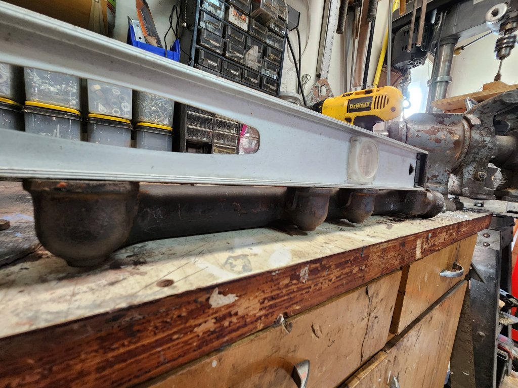

On the manifold; I placed a straight edge on the surfaces and all appears aligned (???)

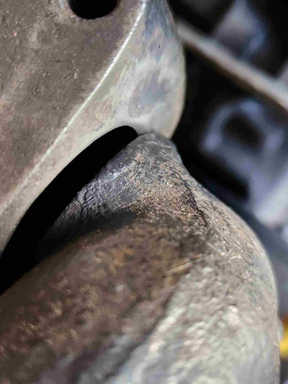

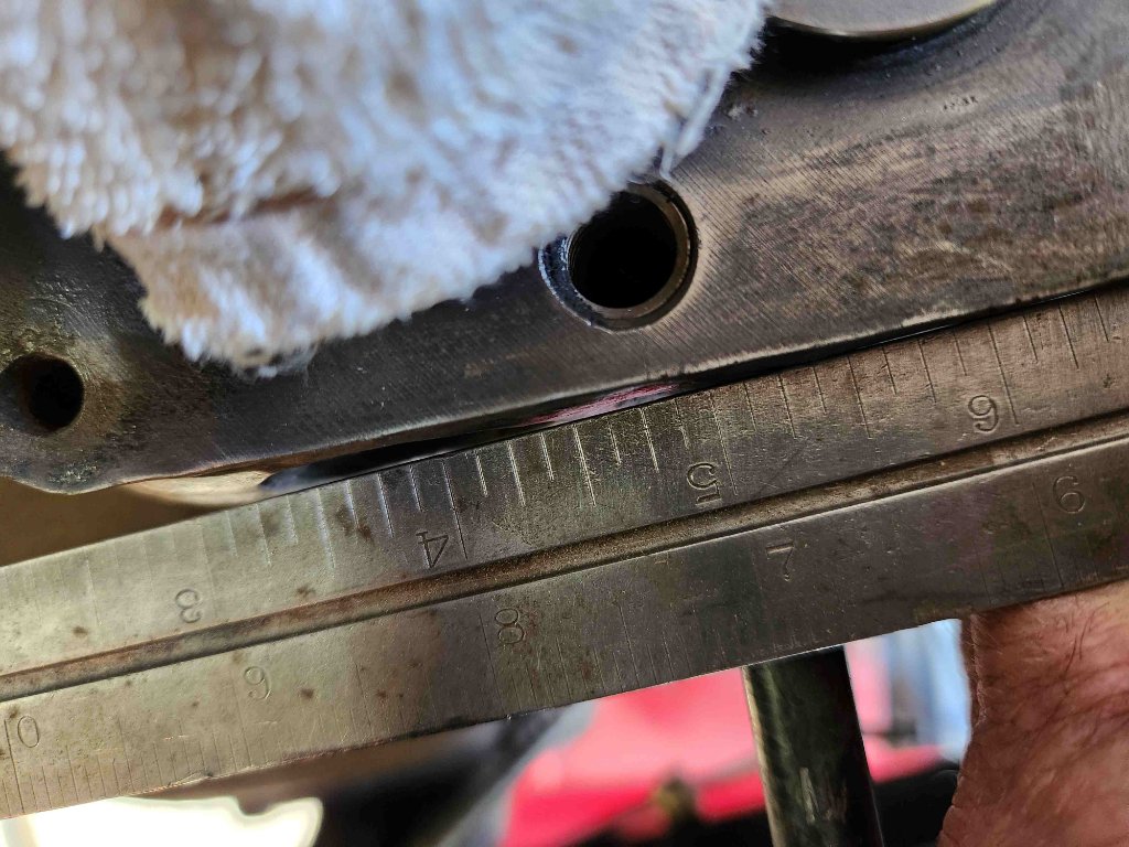

On the bad side - I also placed a straight edge on the block and it is far from straight.

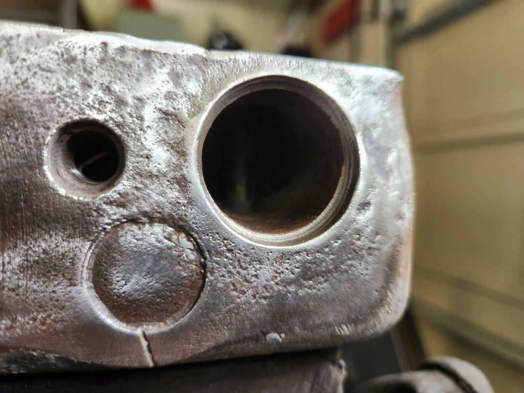

It almost looks like someone ground down the the No. 1 port area ??? (See photos) - No. 4 end is also a bit off plane ...
the strange thing is the counter bored recess for the ring seems equal - hard to imagine a block warping???
Anyone ever seen anything like this?

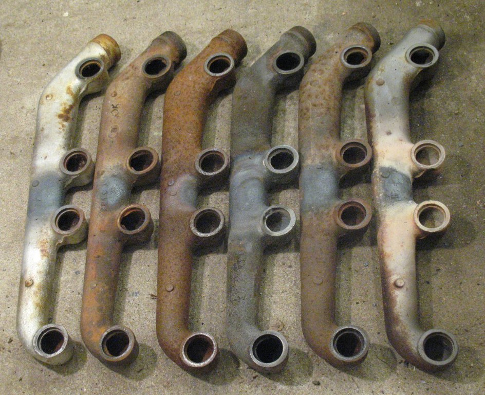

Posts: 7411
Re: Exhaust gasket recommendations ?
Post by Steve Jelf » Mon Jul 03, 2023 11:52 pm

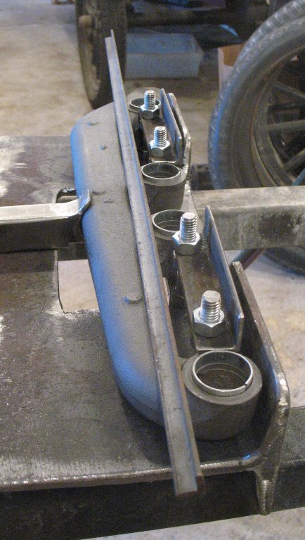

You need to check this line-up by putting the straight edge along the top of the ports.
Here's what Allan is describing. Note how #1 and #4 are out of alignment with #2 and #3. A manifold like this should be straightened or replaced.
https://dauntlessgeezer.com/DG82.html

Thanks Steve. That shows exactly what I was trying to say. When the get as bent as that one, I generally toss them aside. Some I can make staggered glands for, nut that one is too far gone.

It looks like there is a hairline crack form the Helicoiled head bolt hole out to where the gasket face used to be.

Post by Steve Jelf » Tue Jul 04, 2023 9:02 am
Yes, I tried a few that were warped more than ¼", and broke them all. But Joe Bell suggested doing those halfway, letting them cool overnight, and finishing them the next day. I'll try that next time.
Fortunately none of these were warped more than ¼".

A truly lively discussion and thank you all -
The image of the fixture helped - I now understand and appreciate the point made by Alan - (Thanks again !)
Today I took my shiny new steel ruler to illustrate the alignment of the ports on the manifold and block - (see images below)
The manifold ports are straight and even in the X-Y-Z planes. So, I think its ok and at least workable. The block mating surface clearly
is not though and at this point - I just have to stay on course with 'plan B' - and try the gasket- tubing - and compression rings idea-
I'll update all as soon as possible-

Well - the verdict is close to in and things are not looking good for this engine -
I've tried the cut solid tubes - split rings, copper gaskets, copper rings, and the expensive single piece copper rings-
Sadly, the block surface is so badly eroded and worn out of plane that I just cannot get any type of a good seal on all 4 ports.
(see earlier pictures)
Has anyone ever milled / counterbored the intake/ exhaust surface flat?

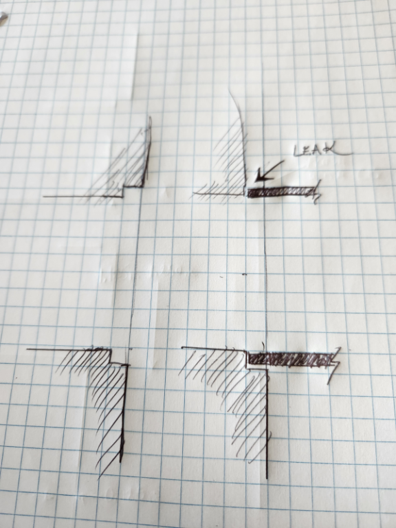

Unfortunately, I need some type of counterbore (CB) to seat the center tube - The surface of no. 1 and 4 is so badly eroded that the CB is barely present at the top of the hole. (see sketch and image) - If I cut down 2 and 3 I still have the interface issue with 1 and 2 -
I did find a similar problem with someone on this board from 2009 who had the same problem - He milled the exhaust / intake port area as far as he could, but he still couldn't get it flat- so he counterbored oversized holes - They are normally 1.25 in dia. and he went to 1.325. and down roughly 0.2 in. The then machined custom interface 'glands'/rings- I may end up trying the same- but first I have to see if I can mill the surface at all -`
see
http://www.mtfca.com/discus/messages/80 ... 1258583194

Post by Dan Hatch » Tue Jul 11, 2023 1:36 pm
There is no real way to tell how thick the block is where you are wanting to deck it. I only take enough to get it fairly flat there.
But I have a question. What is going on where I have circled in your photo. Looks like a grinder got loose on the head surface. Will it seal up?
