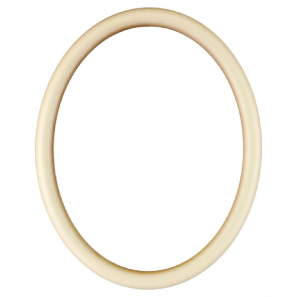

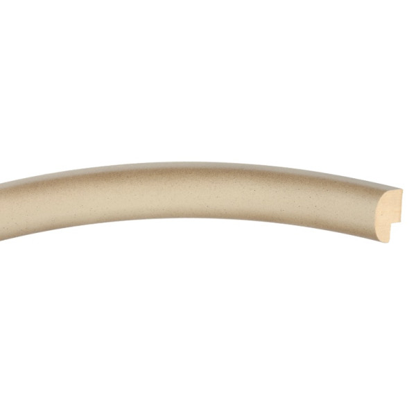

I've decided to settle on getting some pre-made oval frames from a picture company. Attached is the style I'm going with. The frame is very basic. It has a height of 1" and a width of the frame is 1" and a rabbet depth of 3/8 x 3/8 for the glass. The glass I'm using is 3/16 of an inch, which would leave another 3/16" to fill. Normally the picture frame is filled with matting and a backing soy can hang it on a wall. Obviously I'm using it for a window so the question is how to assemble the frame with the glass against the metal on the doors. The metal is 22 gauge. Should I use some sort of gasket material top and bottom of the glass? So the gasket would be against the oval frame and the metal so in a sense the glass would be sandwiched in-between gasket material top and bottom or jut put the gasket just below the glass? I made a simple drawing for you to look at and offer your opinions.... The drawing is not to scale.

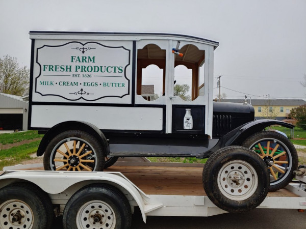

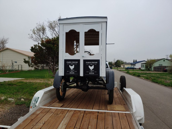

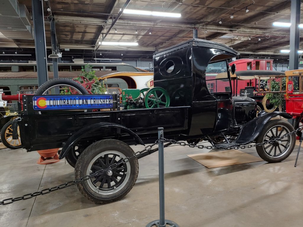

I have a TT C-cab with a small oval window in the back panel. Haven't been able to find the correct size ring. I know they are out there, I just have landed one yet.
The Delivery truck has rectangular windows but I was thinking of mounting them the same as an oval.
There are 6 windows; 2 back doors, 2 front doors, and 2 right behind the front doors. I was thinking of using stove bolts with the heads to the outside. The rest of the truck is put together with stove bolts so the new ones would blend right in. Head outside, washers and self locking (Nylock) nut on the inside and cut the excess bolt threads off even with the nut to minimize anything/anybody getting caught up on them.

I may not have been clear in my original post…. I’m seeking advice on how to best mount the glass in the oval frame in the doors. The oval frame has a 3/8 x 3/8 rabbet. The glass is 3/16 of an inch thick which would leave another 3/16 to fill. Should I use some sort of gasket material between the metal and the backer thus sandwiching the glass between the gaskets?
