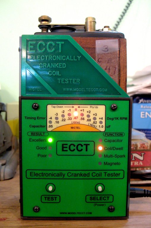

Thanks to Mike Kossor, who noticed my remark that coils don't need to be checked often. He suggested they could get out of adjustment quicker than I thought. So I did some testing.
From my 1915: Of the four coils and a spare, one capacitor tested excellent and four were good. On the coil/dwell test two coils tested good and three were poor, to various degrees. On the multi-spark test all five were poor, again to varying degrees. Ron restored these coils in 2011, and I think they were readjusted last year.
From my 1923: All five capacitors tested Excellent. On the coil/dwell test four were good and one was poor. The multi-spark test found four good and one poor These are Patterson coils from 2008. If they have been checked and adjusted since then it was long ago and I don 't remember it.
Just out of curiosity, I grabbed five random coils out of auction plunder. I've done nothing to them since I bought them at least eight years ago. All of them will at least spark, but all five capacitors tested poor. On the coil/dwell test two tested good and three were poor. The multi-spark test found all five poor. I hope I can find the time for some coil rebuilding next winter.
So what is the bottom line? Obviously my 1915 and 1923 coils have remained good enough to run a couple of cars for many years. And equally obviously, they don't remain well adjusted for many years to keep the cars running at their best. I stand corrected. I intend to make coil testing and adjusting a part of regular maintenance.

Yes, I used one of these:
Considering the sage advice above and my own inclinations, I believe I will test before each driving season and before each big trip. If I find that's too much I can cut back. I hope I can take some time next winter to learn coil rebuilding and have half a dozen ready to go if I need them.
