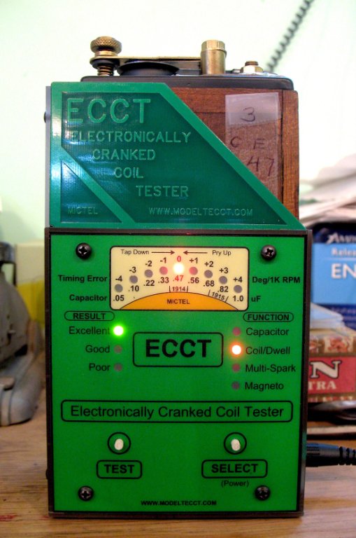

Yes, I used one of these:
Considering the sage advice above and my own inclinations, I believe I will test before each driving season and before each big trip. If I find that's too much I can cut back. I hope I can take some time next winter to learn coil rebuilding and have half a dozen ready to go if I need them.
