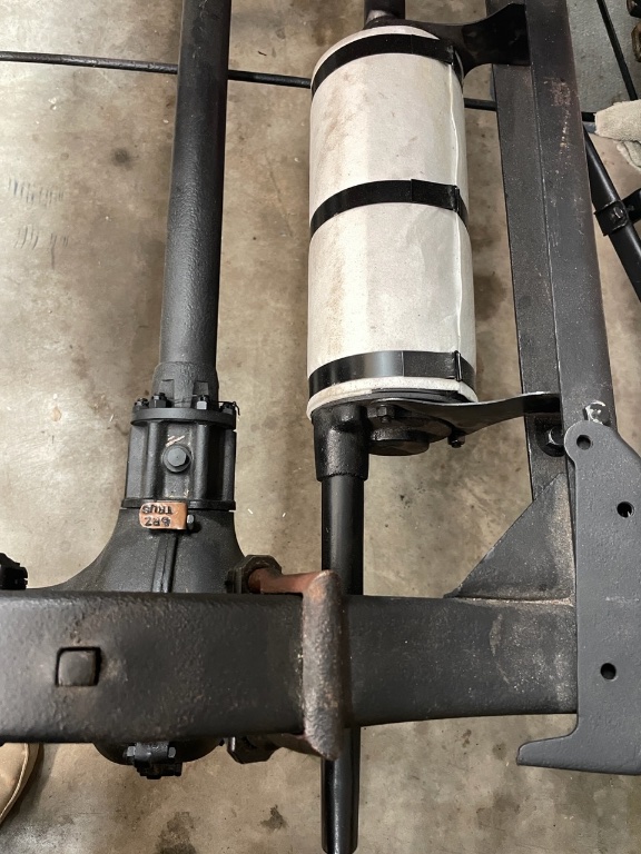

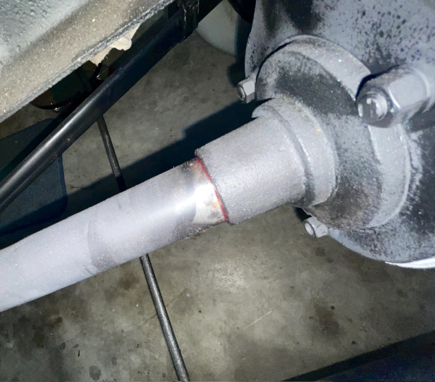

Hi all, here's my current challenge... I have a newer exhaust pipe (steel I think) that's 1 1/2" diameter and I discovered (frustratingly) that the new muffler kit I installed today measures 1 3/8" diameter. So I ended up putting the old rusty muffler back on for the time being. Looking for advice on how to figure this out. I'm kinda surprised (but maybe I shouldn't be, given this is a Model T) that this happened.

Your description of a "muffler kit" and it not fitting a standard exhaust pipe has me really curious as I've never ever had an issue making these things marry up correctly.
If you'd give a P/N for the "kit" or a picture of it, it is all but certain that your question will be correctly answered almost immediately
I'm suspicious that you have purchased a shell kit for a cast iron end muffler and have perhaps misunderstood how the baffles fit within the cast iron ends - do NOT go expanding or farting with things until you've posted a picture or at least state exactly what kit you bought

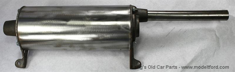

part # 4025A, which matches the muffler type I have on my T now.

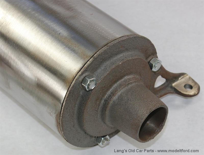

Same issue. The cast inlet on the repro early muffler is machined on tight side. Had to take the pipe to the bench grinder and remove some pipe diameter. Took a bit to slim the pipe O.D. To slip fit the muffler inlet.
Pipe was painted before grinding so you can still see ground area. Plus some red grease oozing as had to lube that pipe end to wiggle in place, the muffler was already mounted to the frame! Difficult to grind a perfectly round diameter on a long pipe end with just a 6" bench grinder stone....
But all worked ok, repro parts need attention , but sure nice to have ‘em, can’t go to my Ford dealer for T items!

I'm got 1.509" on the ID of the mufflers we have on the shelf.
Like Dan said paint could be causing an issue. also the old pipe has a bur at the end that is sticking out from being cut it could cause an issue or if the old pipe has been egg shaped with a old exhaust pipe clamp it could cause an issue.
If the muffler is undersized let us know and we can get another one out for you.
Thank You Steve

Rear hole on a cast iron muffler piece accepts a 3/4" pipe tail pipe - front piece should be 1 & 1/2".
