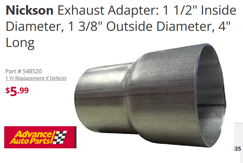

Post by TRDxB2 » Fri Jul 21, 2023 11:34 pm
Have you considered something like this?

Hi Tim, yes from Langs just last week. The matching pipe they sell is 1 1/2" OD, so I'll be calling them on Monday to sort it out. In the meantime, I'll take a look at what Frank suggested about the adapter.

I remove the option now that I understand what muffler was in reference
