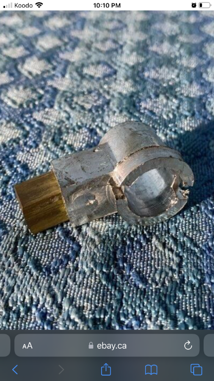

Got my new timer brush today and taking a quick look at it my car does not appear to have any key way or slot to make the brush point a certain way. Am I missing something or do they just point wherever? Should I find tdc and point it to that?

looks like it has a keyway to me
take the old brush out and you'll see exactly how it goes
I hope you have a timer which actually uses that brush

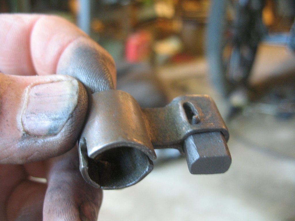

The brush should have a notch, or slot, like this New Day brush. That goes over the hole in the shaft, and a small pin like a little nail goes in the hole to hold it there. A retainer to hold the pin in place is held by the nut on the end of the shaft. If your shaft has a hole all the way through it, you can easily install the brush 180º off.

Hi thanks there is no pin there anymore and no old roller. Seems to have the right cap by looking at it. Ill find a roll pin tomorrow hopefully I will have it running soon. Thanks again for the replies

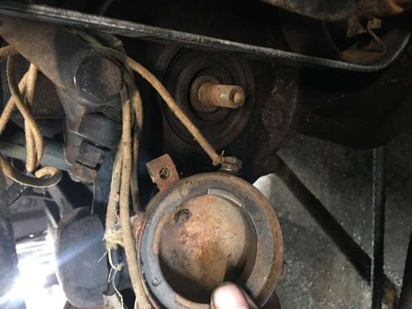

Please show a picture of the timer itself.
Kerry

Pic of timer. Yes using a ford timer just replacing it to a brush cause that’s what I had

Robert, that timer housing needs a roller, not a brush.
My mistake. I was looking at the photo that Steve Jelf posted. I have a Tiger timer but have never seen a brush for it. I have a roller.

That is an era "accessory" brush that will work with the timer pictured - notice the curvature of the brush - the timer appears to be a "Tiger" accessory commutator.
- Posts: 7413
Re: Timer brush help
If that Tiger is as rusty as it looks in the picture I would derust it, paint the outside, and clean the inside thoroughly. Ideally it would be turned in a lathe to make a perfectly smooth path for the brush. Google Tiger Model T timer for previous forum discussions.
